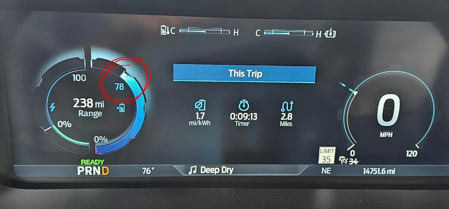

I used my new smart charger and soon after I hooked it up, it showed that the batteries were already close to full. After only about 15 minutes, the charger stopped and said FULL. After that, I reset the BMS and the battery icon flashed 3 times and I pushed the start button again. I then Set up the OTA for 10 minutes later and just like Swiss clockwork, the OTA faIled again.
Not sure what else to do but take it to the dealer.
The dealer said that the BMS needs replaced and they ordered one. They kept it overnight and got it to update without replacing the BMS. They said that the part won't be here tomorrow and they would install it when it gets here.
Oh, by the way, the SOC shows up in the cluster now! :clap:
