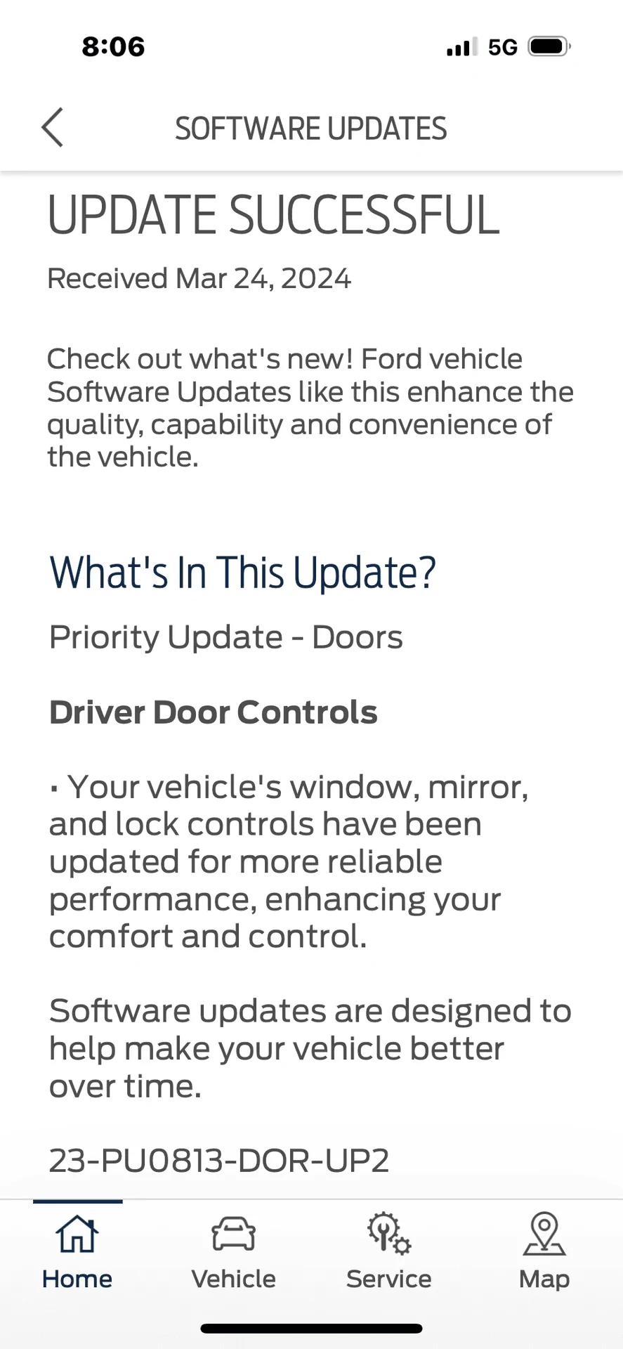

Successful 'manual update' today with latest update sitting in my que: wondered why it hadn't update after several overnights where 'seemingly' there would be not issues - apparently it doesn't tell you WHY it hasn't updated, only that several 'things' must be in place for the update to occur, but not WHICH one caused any issue...
(originally the truck had not been plugged into power for several days)
I plugged in the truck about 7:28. It started charging.
I started the UPDATE about 7:30 this morning.
  • this required me to turn the truck to accessory mode to access the center screen(PRO SR)
  • I requested to MANUALLY update
  • It then told me to turn the truck OFF, and exit the vehicle, closing the door.
  • the current 'charging' stopped, but the blue ring stayed lit, for a while.
  • the center screen, after the 2 minute countdown, changed to 'Update to take about 40 minutes'.
This is when the 'BEES' started coming out!
The Front AND Rear INVERTER/CONVERTERS started 'buzzing' wildly while the 'work' was being done.
Busy Bees!
This took place for about the next 15-20 minutes, as the VIDEO will tell...
Finally, the 'buzzing' stopped, and several minutes later, the UPDATE was complete.
Maybe this 'buzzing' happens at every update, who knows, but it was an eye-opener. I never thought that the Inverter/Converters would have anything to do with a software update. Oh well.
I noticed, too, that while this update mentions 'doors and windows', which I have no issues with, I see no real 'changes' after the update, although I also don't know what issues or changes this would even be applying to.
