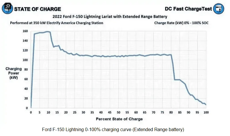

Here's why (using the ER with 131 kWh battery). The TLDR (too long, didn't read) version is that road trips are still a pain in the butt.
First of all, your charge rate is dependent on the battery state of charge (SOC). Using rough numbers, at 10-30% SOC, the Lightning might accept about 150 kW per hour into the battery. Then as you charge, it accepts less and less, up to 80%, where it might be accepting 80 kW. After 80%, it drops to (I think) 60; after 90%, it drops off a cliff. So, most people on the road quit charging at 90% unless they really need the energy to get to another charger. See this ideal situation charge curve. I often see less than this.
Ford F-150 Lightning Using a Lightning for swimming pool routes. Yay or nay? 1720184330969-am
Also, you don't want to risk dropping your SOC too low, so you can't plan on making it to a charger with 3% left. The consequences are too great. No one can bring you a can of kW to fill up. There aren't chargers every few miles or on every 5th corner in town. So you want to keep 10% in reserve.
While you can charge up to 100% when you leave the house, once you get on the road, plan on using only 70% of the battery (80-10%) on the road. So your 131 kWh battery becomes more like 92 kWh.
So, you leave home with a full charge. Highway mileage varies dramatically with respect to driving conditions. When I leave my house in South Texas, I get on sparsely populated roads with 75 mph speed limits. I expect 1.8 m/kWh with the wind and 1.5 against. Where you are, you will probably be driving 60-65. With little traffic breaking the wind for you, 2.0 is attainable. On a busy interstate going with the flow of the traffic, you can get 2.2.
Let's use 2.0 for this example. You leave the house during your 100% charge "honeymoon" period. You can go 236 miles before reaching 10% SOC. I'm going to back you up a little because there probably won't be a charger in the exact location. (Use ABRP and PlugShare to search for your exact use case examples.) So, let's say the charger you get to is 210 miles from home, at 20% SOC. You made it half way. You charge 20-80%. Without any connection problems, if you can get 110 kWh average, you will be on that charger for 43 minutes. You will then start your next leg with 105 kWh. Running it down to 10% from there will get you 183 miles. Again, let's say you find a station at 20% charge instead, which would be 157 miles down the road, leaving 53 miles short of your destination.
Your second charge time will depend on how much energy you want to have when you arrive. If you are going to pull up at someone's house who has a charger, and spend the night, you can arrive with 10%. If you don't have good overnight AC charging options, you will have to DC charge at your destination. So, let's say you want to keep some in the bank, and arrive at 30% SOC. (ABRP will do all this for you.) You will need to add 26.5 kW for the 53 miles, plus 13 kW for the extra juice (20-30%). That's about 40 kW, or 22 minutes on the charger. Then at your destination, if you don't have level 2 charging overnight, you have to spend part of your trip at a DC charger instead of with those you went to visit.
So in that scenario, with chargers in good locations, you would have 1:05 of charge time. That's leaving with 100%. On your return you may leave with a lot less energy, depending on your options where you stay. Add to it the vagaries of hooking up and communicating with varied charging companies. In my DC charging experience I have had about 1/3 seamless, drama-free connections, and 2/3 that ranged from 10 minutes connecting, and finding that the output is only 60 kWh (thus spending over an hour when I planned on 40 minutes) to charger not working after trying for 15 minutes and driving out of my way to find another. In one instance I waited two hours to get an open charger, then charged for almost an hour. That one stop added 2:50 to my trip compared to filling up and moving on. The network is improving, but it's not there yet.
Bottom line, you just can't jump in the truck and go. It's complicated. It requires patience. You just can't plan on leaving at noon and making it for dinner. It might not happen.
I recently considered driving 420 miles to Dallas. Using the planned route and expected charge times, if things went well, my trip there would take 8 instead of 6 hours. My return home by another route would have added even more stop time. I took my wife's car instead.
Hope this helps you decide.

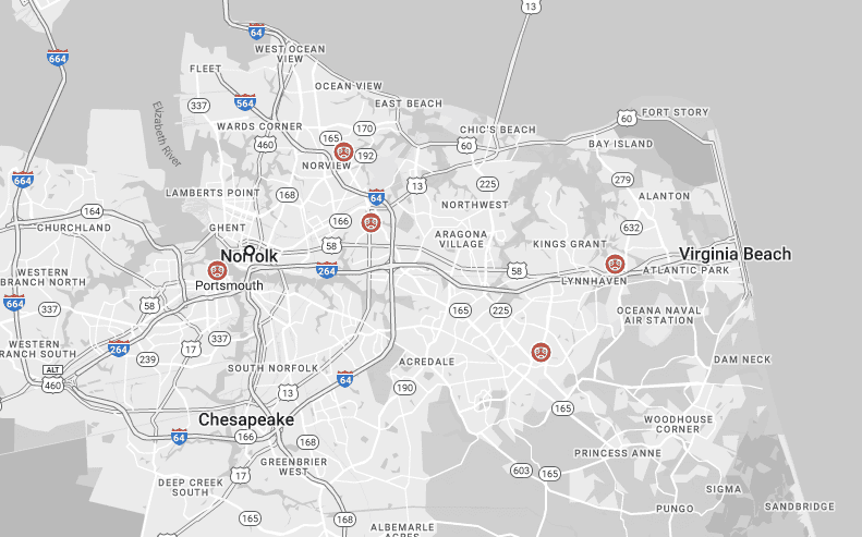

Ford F-150 Lightning Using a Lightning for swimming pool routes. Yay or nay? norfolk.PNG

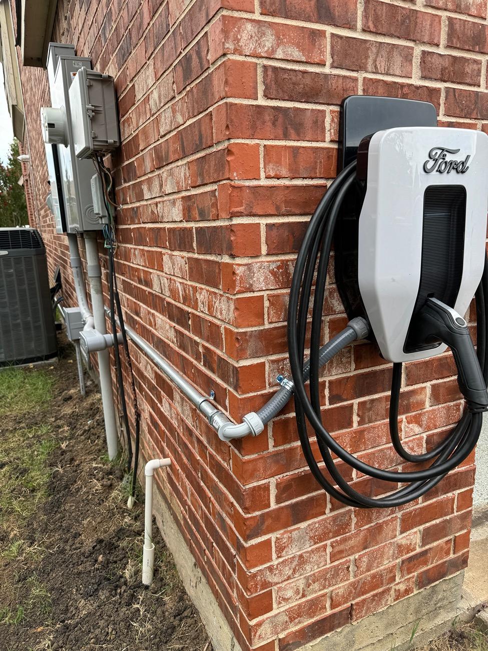

Is there a max length of cable that can’t be exceeded for the charge station pro? I live in a 2k sqft double wide mobile home, and my driveway is at the complete opposite side of the house from where the main power line/meter is, way more than 50ft away.
Keep the gas truck for a backup, in the rare event you experience a battery module issue, BTW many of us have had flawless ownership, mines going on 2 years August 4th.
Your Electrician can run the feeder line from load center to a post mount of your FCSP adjacent to the driveway.
What Taxman said!
Picture of how mine is mounted, but you could mount it on a pole or whatever just have to run the electricity where you want it!
The cable on the FCSP is 25 feet (if I am remembering that correctly)but you can only stretch it out maybe 17-20 ft depending on how it is mounted. You don’t want it to be stretched out so that there is no slack and it is pulling on either the charge port or pulling out of the box.
