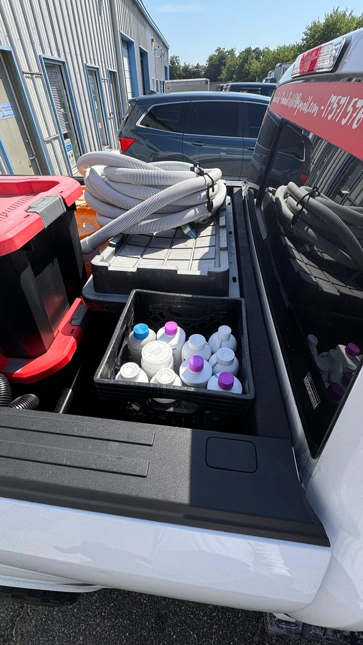

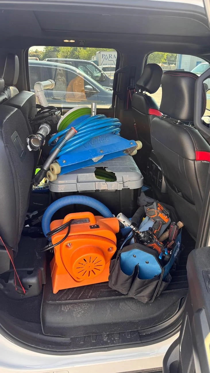

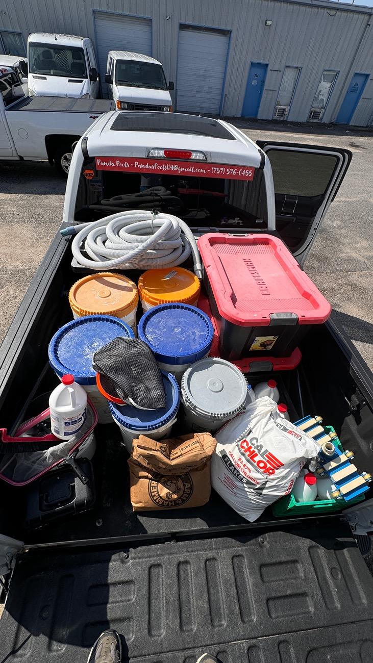

Pics if typical load out with 6.5 foot bed.
Ford F-150 Lightning Using a Lightning for swimming pool routes. Yay or nay? IMG_6027
Ford F-150 Lightning Using a Lightning for swimming pool routes. Yay or nay? IMG_6028
Ford F-150 Lightning Using a Lightning for swimming pool routes. Yay or nay? IMG_6026
201
14,747
16,161
Remember the Lightning bed is only 5.5 feet, but you have the Frunk for some storage needs.

Your truck is packed! You’re going to lose bed space in a lightning so you’ll have to get creative. I’d save the money and go standard range if the boss is covering the cost of fast chargers.

Yeah I’d be fine with the 5.5 bed. The frunk would allow me to switch some equipment up there for the bed space.

I think you’ll be fine with space. Your blower, pump, vacuum head, tool bag, hoses can all go in the frunk. That’ll let you out your two red bins in. Worst case, I grabbed a bed extender to get extra length.
