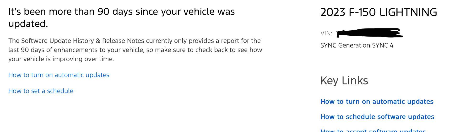

Truck purchased in August, first update was October iirc.
11-04-24 - 6.2.0
11-08-24 - 6.4.0
11-13-24 - 24-PU0119-DC-CHG4
11-22-24 - 23-PU0110-RAD-PS
1-23-25 - 6.5.0
1-24-25 - 6.8.0
1-26-25 - 23-PU1113-UNX-DC
1-29-25 - 6.14.0
1-30-25 - ECG-24.2.5.6.2.2
1-31-25 - 10.1.0
I swear there was a ECG in there prior to today but it's not listed.
Edit: Originally said first update was in Nov but I do remember a 4.x.x update which must have been past the 90 day history.

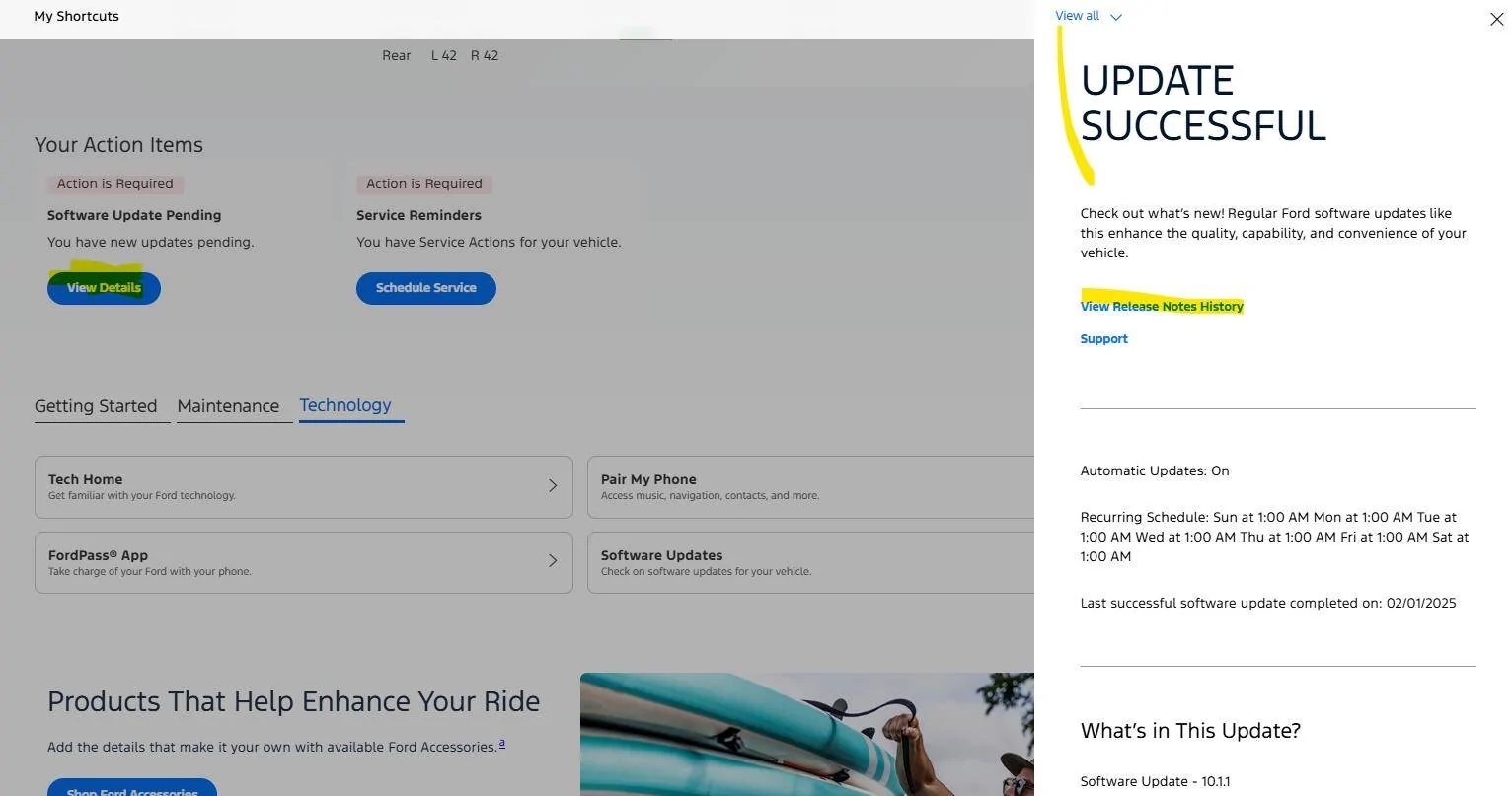

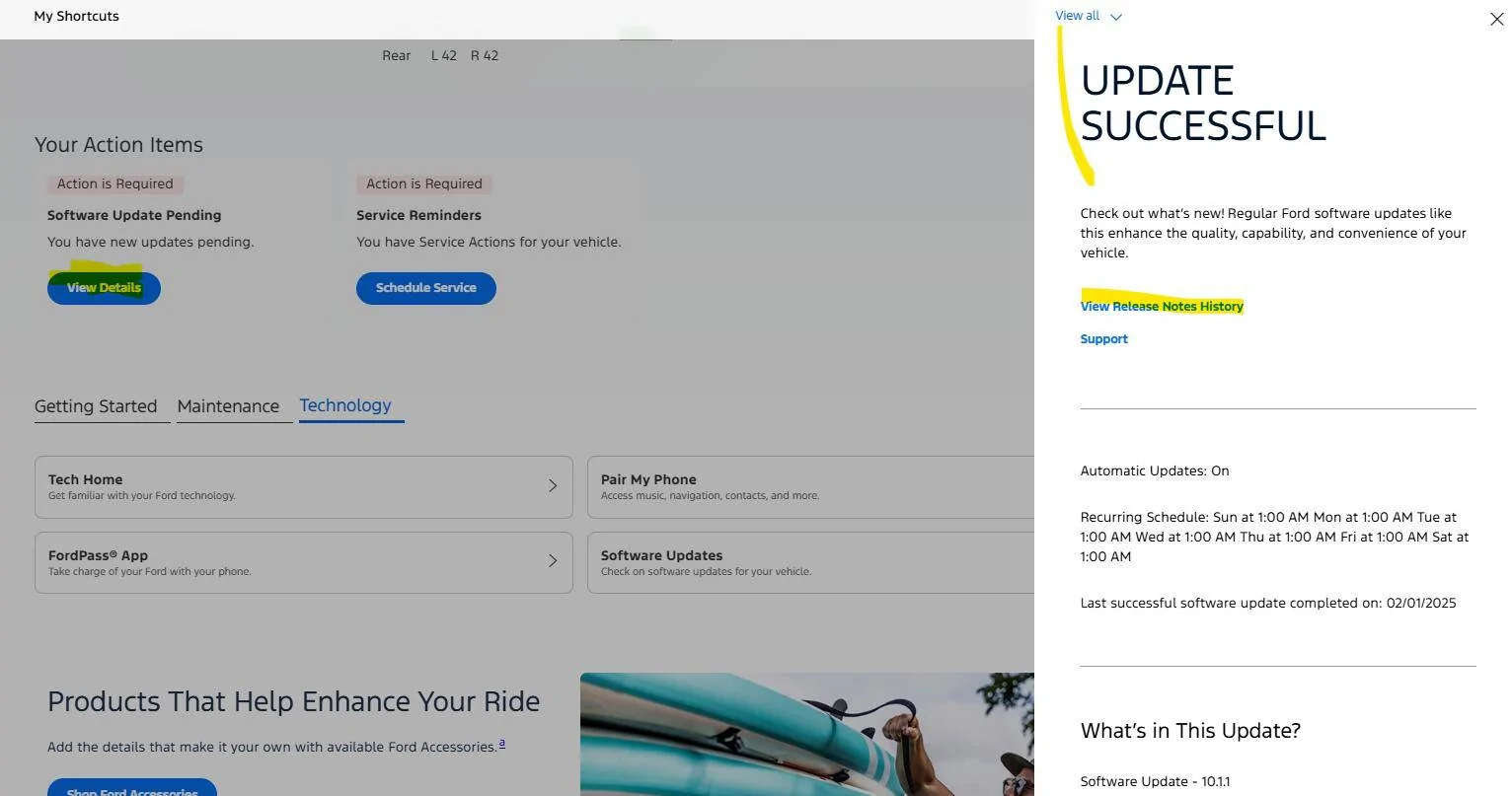

Another way to find the link to software updates, after logging in, click user menu upper right, select Vehicle Dashboard, then click the Software Updates Pending section click View Details, a right side panel appears with most recent update, on it you can click View Release Notes History to see current & priors.
I suspect this view will change once the newest update alert ages after a few days, leaving only the Service Reminders section visible until the next update hits.
Ford F-150 Lightning Vehicle Software Update History Now Available in Your Ford Account 1738418935549-8
