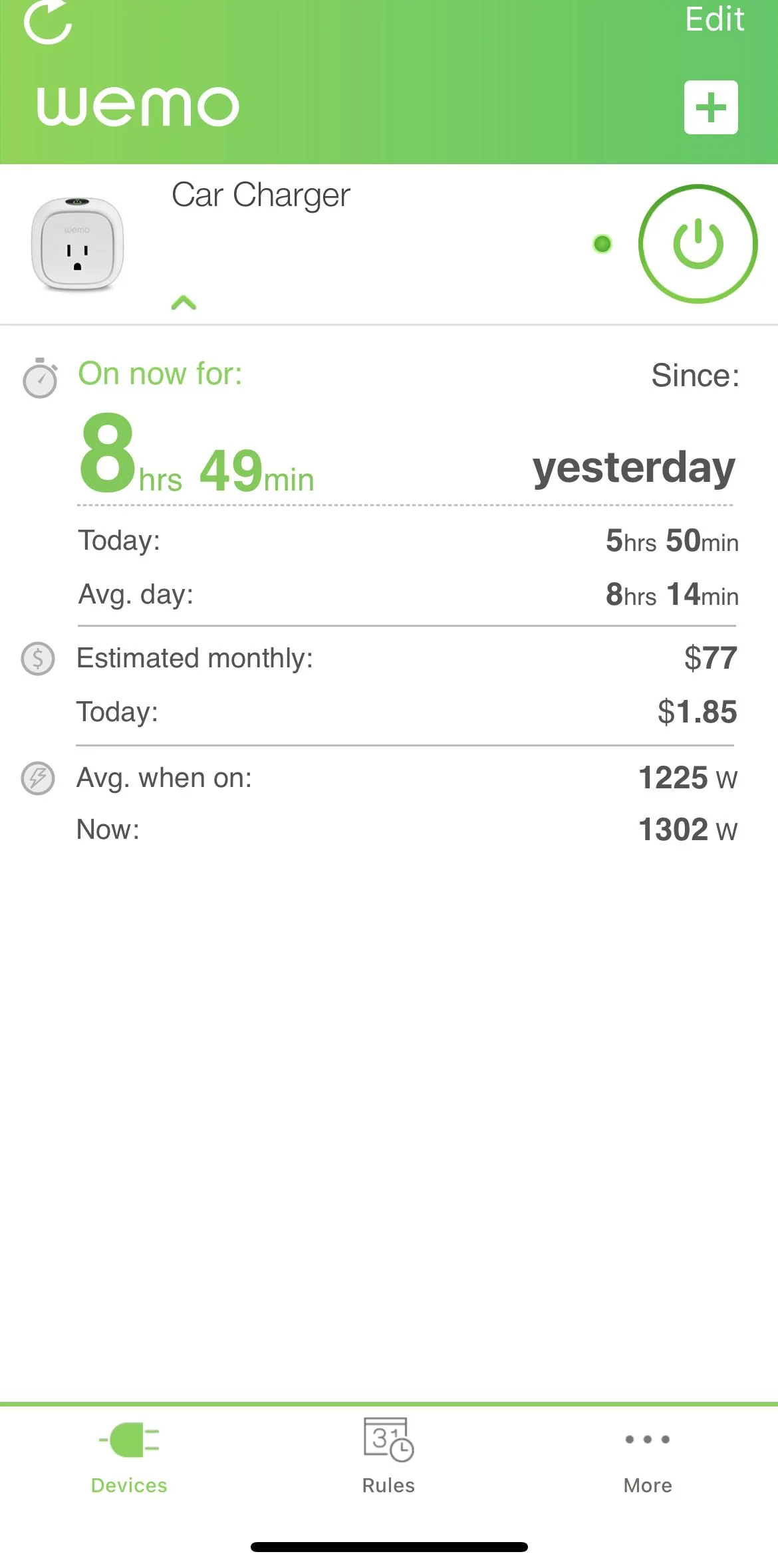

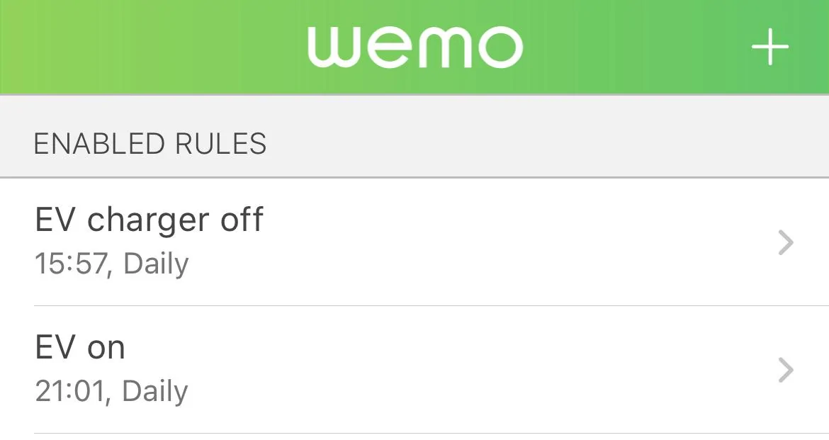

This is my hack. I use a WEMO insight program it to go off during peak hours. I started doing this with my fusion Energi. It also tracks the watts during use. The app no tell me to check the connection with the lighting when the WEMO is off. I was also able to delay the turn time with the heatwave in SoCal a few weeks ago. I am not sure about the monthly cost estimate I can't find the part of the app were the Kwh rate can be changed.
That is great! However, are you charging your truck via 1.2-1.3 kWh?

I guess so when the WEMO and the truck are drawing charge it is showing 1.2 -1.3. The average may be off as there is a 2-5 watt draw if the WEMO is on, but I am not charging. I am actually just using the charger that came with my Fusion for now so I am not sure if that would make a difference.
Just looked up the WEMO insight capacity. "The maximum power capacity of Wemo is 15 Amps, 1800 Watts at 120 Volts U.S. "
101
6,431
8,696
Most people find that 110v charging on a vehicle with this size battery isn't very useful. Works fine on a Ford Energi with a less than 10kW battery.
I'd be careful pushing high sustained amps through such a small wfi outlet - even if only 110V.
