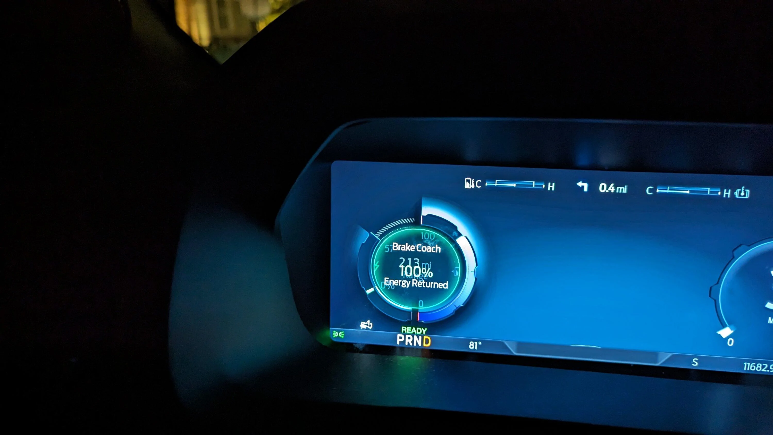

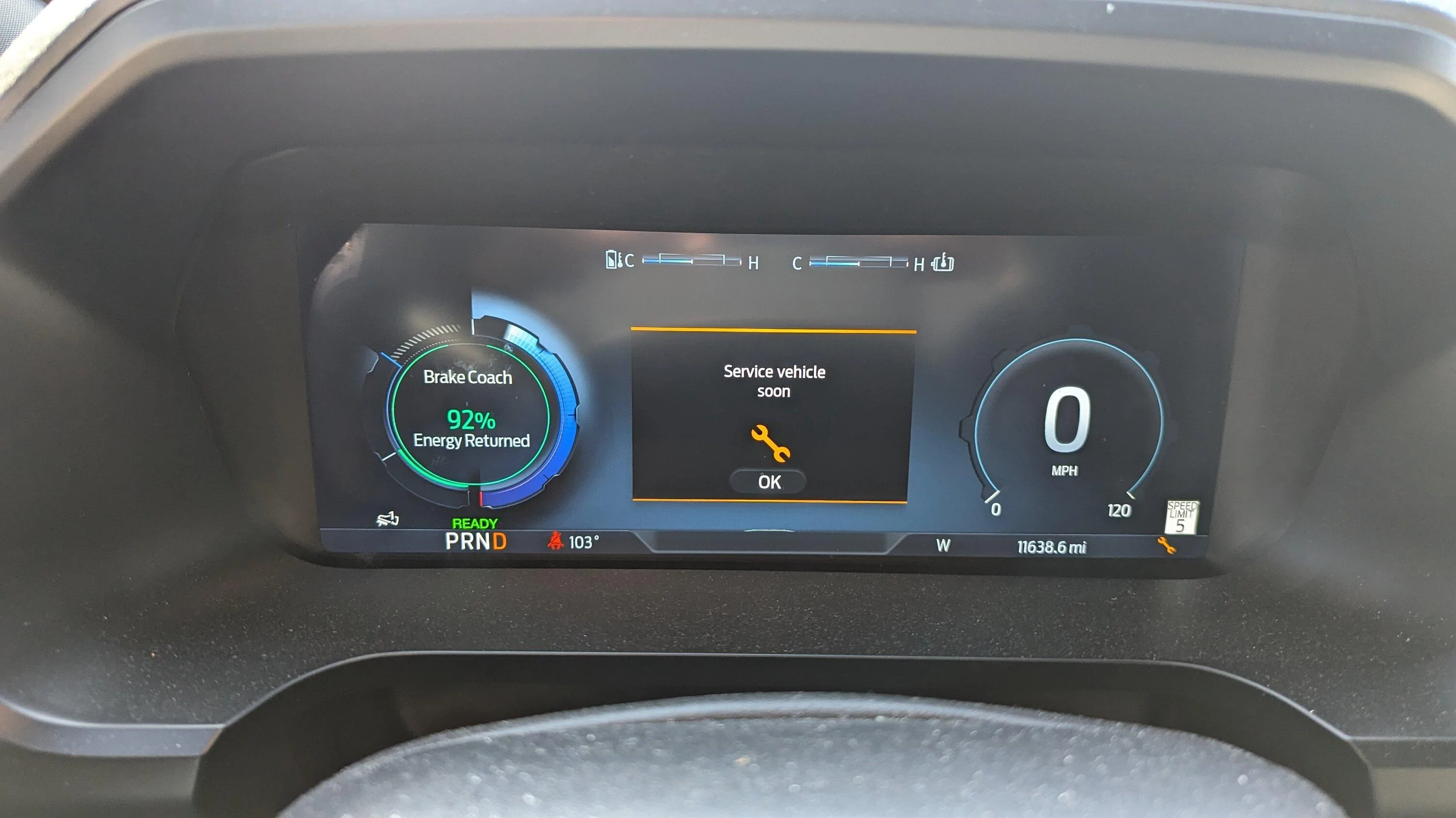

Posting my experience to see if anyone has seen something similar to this:
Unplugged the truck with 70 % soc. Started the truck and the gauge cluster is telling me I am limited to 56% power on the far left (like how power is limited when low on battery/cold). Then get on the Interstate and change view to power distribution and notice 100% of the power is coming from rear motor. Then exit the Interstate and see regen breaking is the same, 100% regen showing it is from the rear motor with no movement from front motor. After stopping and restarting the truck, I have full power and power distribution is normal.

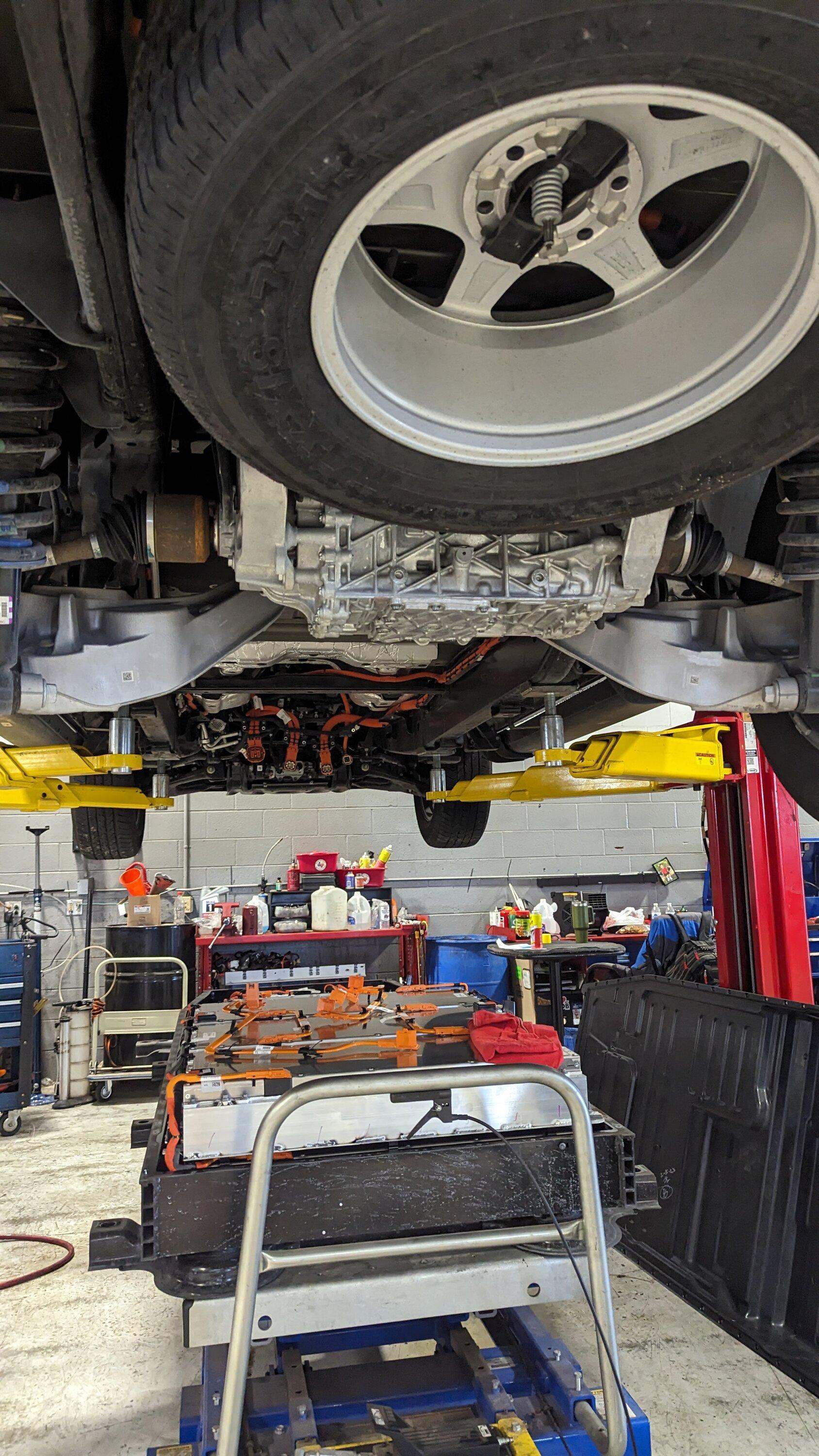

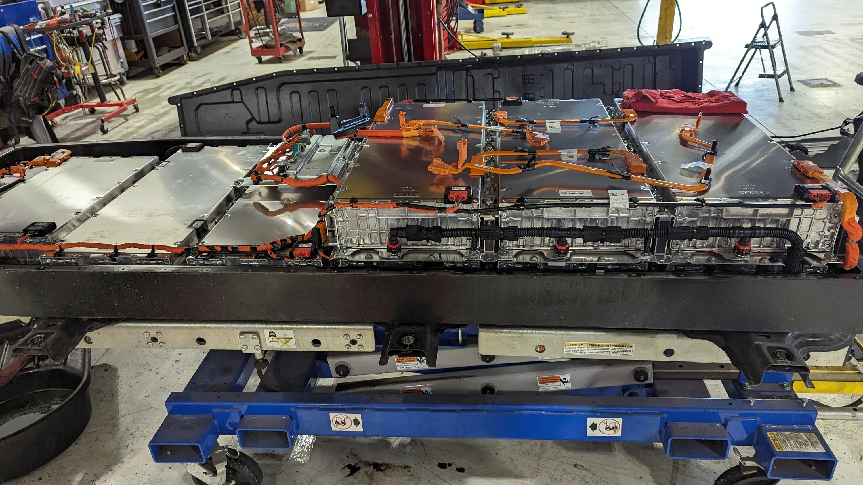

This happened to me last year right after an OTA update and I took it straight to the dealership. Ford also called me to inform me of a recall involving a high voltage module. It was a 9-12 hour job which took 3 days after waiting nearly 2 weeks for the part. Not sure if this is the same situation but that was my experience and it sucked. It was pretty cool to see all of the batteries dropped out of the bottom as they reprogrammed everything
