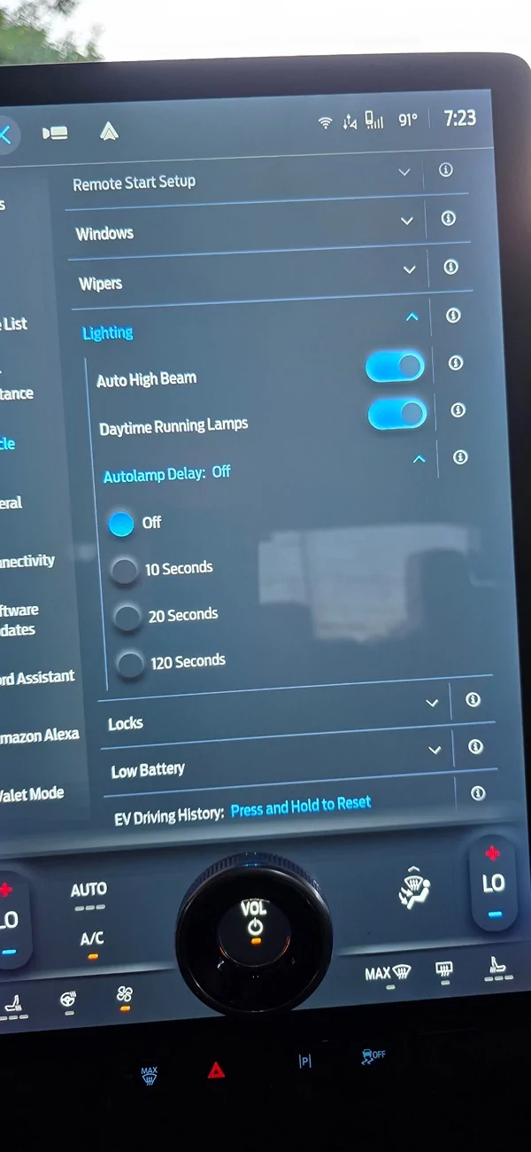

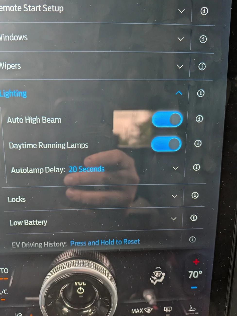

I have a 2025 F150 Lightning Flash that doesn't seem to have the option of turning the welcome lighting on. It should have it as the window sticker shows that it has "Illuminated Entry" but in the settings I don't have the option of enabling/disabling it. I have attached some pictures for reference.
I do have ForScan but as it's a lease I am hesitant to modify anything. I appreciate any/ all help.

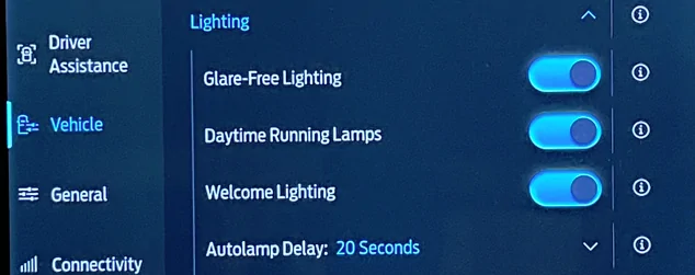

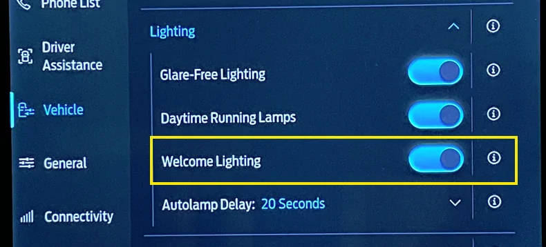

The 2025 Order Guide lists Illuminated Entry as standard on XLT and above. Then it lists Ambient Lighting for Lariat and above.
Ambient lights are the interior lights like footwell, under seat and door handle lights. There is a setting under General for Ambient Lighting:
Welcome Lighting is when some of the exterior lights up (mirror puddle lamps, light bar) when you approach. Note puddle lamps are not on the Flash, only Lariat and above. Thus you may not have Welcome Lighting. Welcome Lighting is a setting under Lighting in my Lariat:

I'm not sure what Illuminated Entry refers to. Maybe its just the dome lamps.

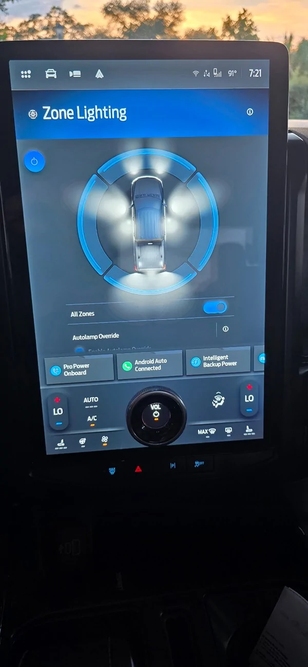

That's strange. Because I could swear it has puddle lamps. I have the zone lighting and aren't the puddle lamps part of that?

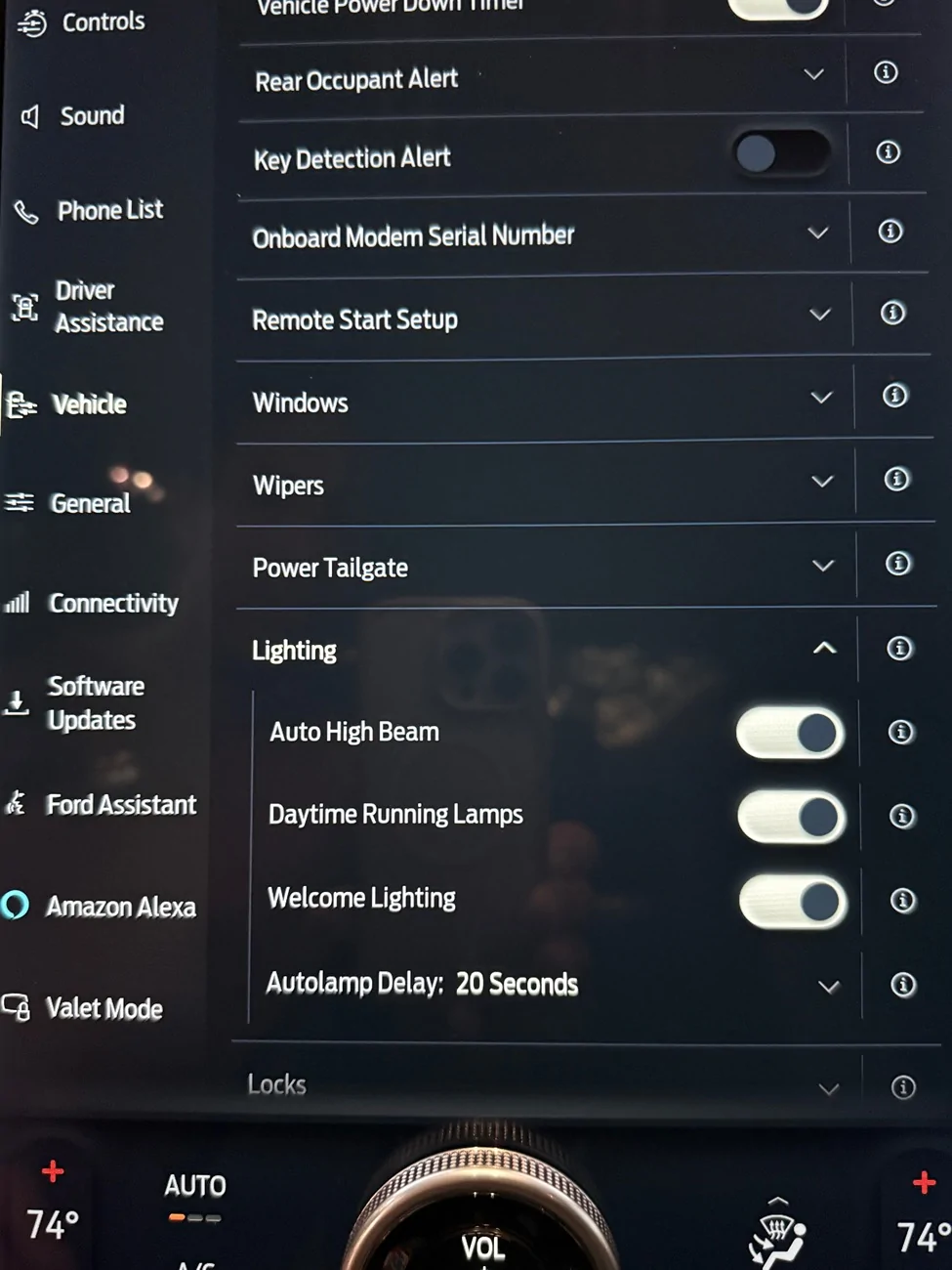

I have a 2025 flash and I have the welcome lights and puddle lamps standard.

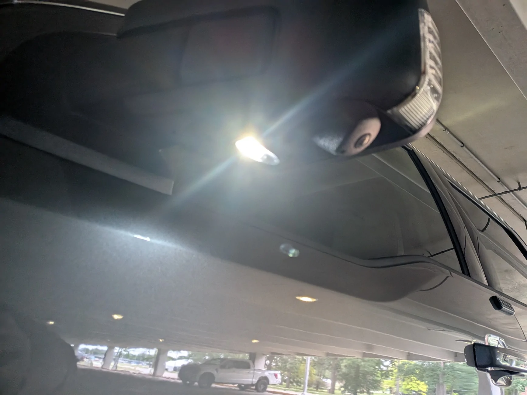

Interesting. Is yours a job1 or job2 production? (Not sure if it matters) Mine has a build date of March 20th. My truck definitely has puddle lights. I went out at lunch at checked. It did have to have some work done before I picked it up so maybe something happened there.

Just went and double checked and yes, I have it

Must be an option package because I see you also have the powered tailgate, I do not have that nor do I have welcome lighting. I do have zone lighting. Also a 25 Flash.

Must be an option package because I don't have it on my 25 Flash either. I do have zone lighting.
Interesting. Just like mine.

Mine was built 2/2025. And I see one other up there posted he has it but he also has the powered tailgate where I do not. Apparently there's a few different option configurations one can choose from on the same trim level.
