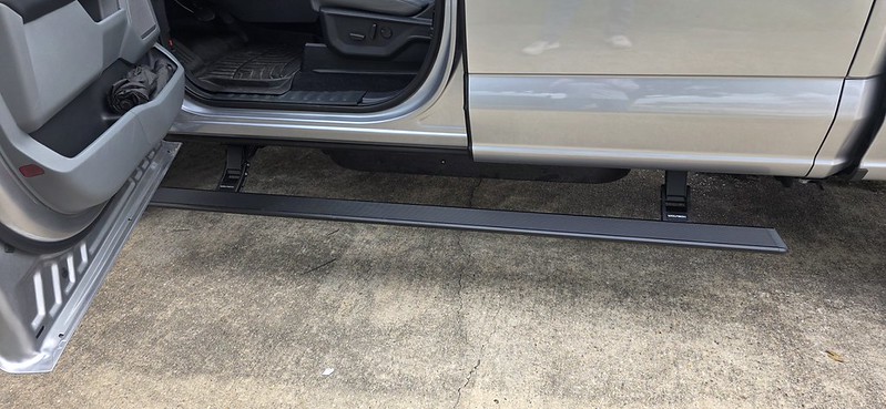

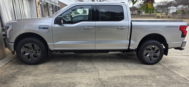

I put a set of these type boards on my other F 150 but different brand, went with Amp Research for it as they were the best bang for the buck at the time. This time I went with Wolfbox powered boards for much the same reason, they were the best price, actually half the cost of AR boards.

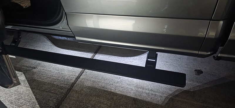

Comes with it's own set of leds that turn on/off with board deployment and retraction. Either door on either side will activate the boards. Got them mainly for my 90 y/y mom, it's a bit of a stretch for her to climb in with those high and tight oem boards. I'm sure my knees will thank me after a while, I'm no spring chicken either.
Ford F-150 Lightning Wolfbox powered running boards installed. 55101844633_2766078fe5_c
Ford F-150 Lightning Wolfbox powered running boards installed. 55101908959_06522c7d31_c
Ford F-150 Lightning Wolfbox powered running boards installed. 55102255610_ac2bbbdd17_c

They come with their own zone lighting, front and rear each side. You tap the CANBUS wires at the bcm for them to integrate with the trucks door open/closed signal. I'll update original post later with an after dark photo.
