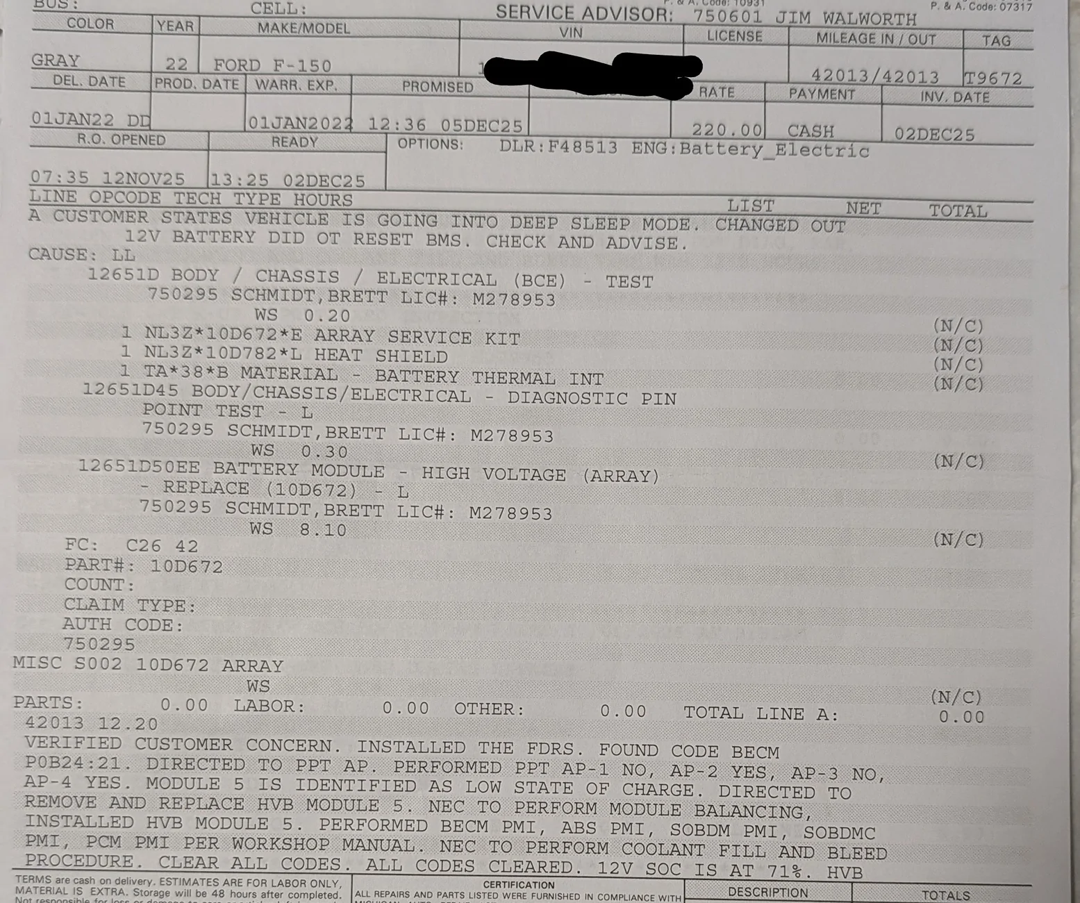

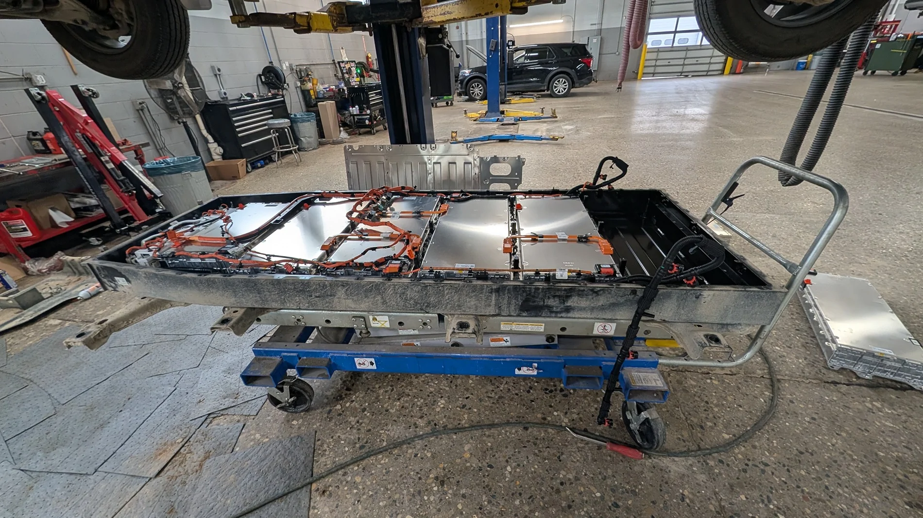

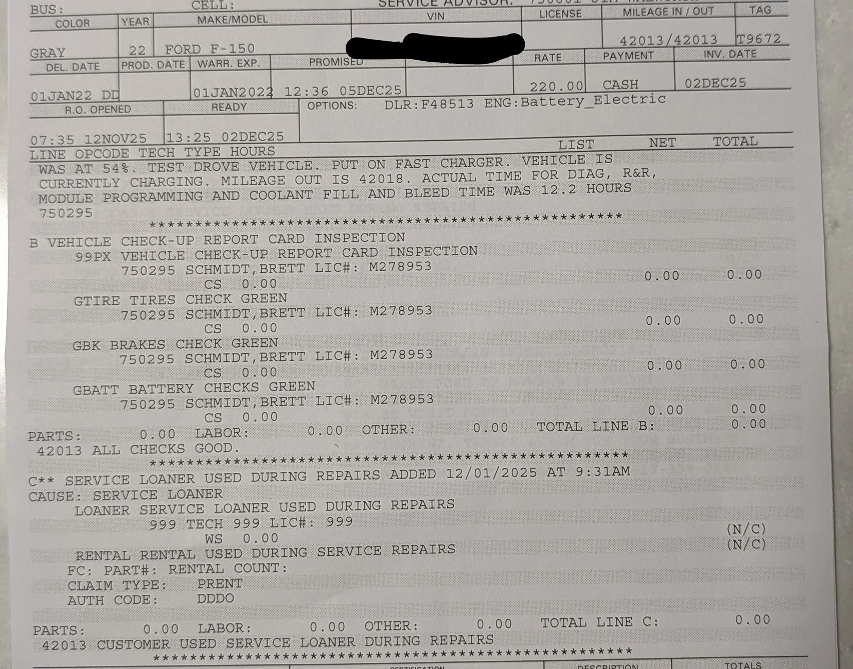

Update... Day 6
Module still has no ETA on arrival at the dealer. Parts says it looks like it has shipped, but no confirmation on that. Picked up a loaner (Bronco Sport with ~350 miles) today since they didn't have one available before the weekend.
