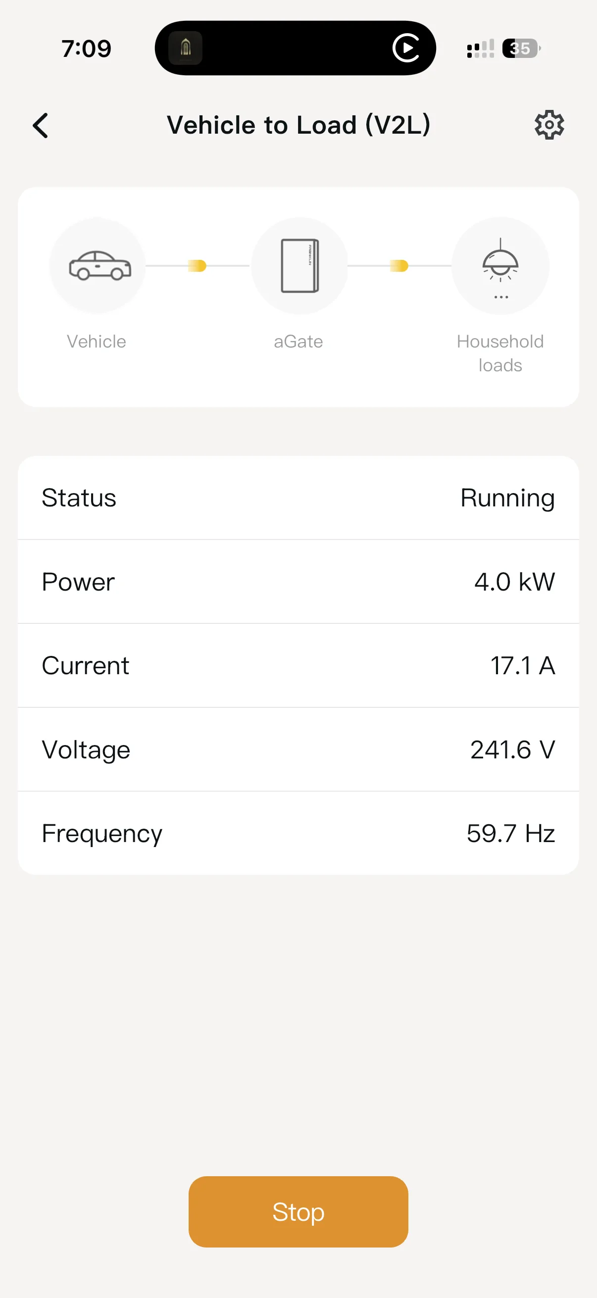

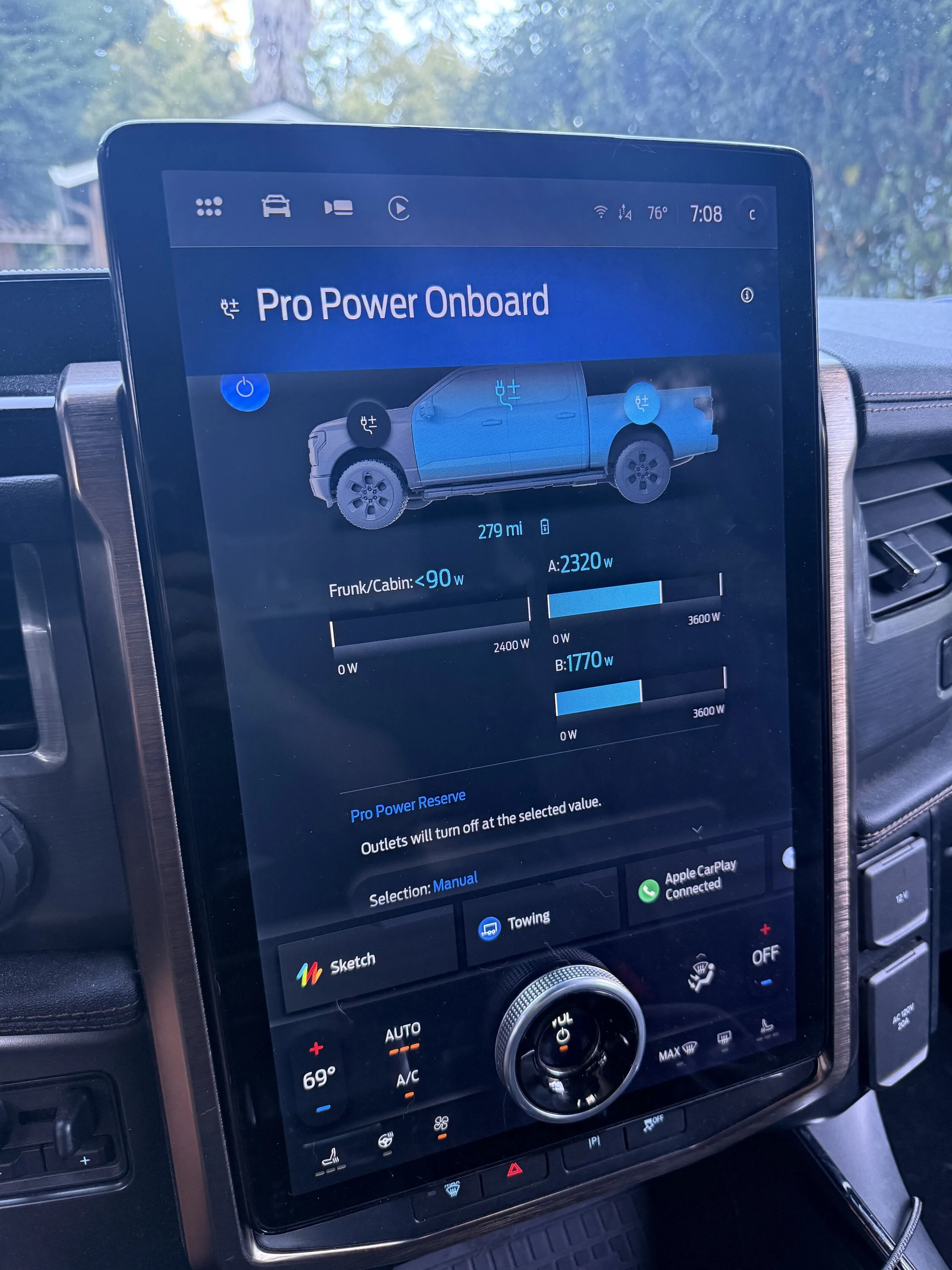

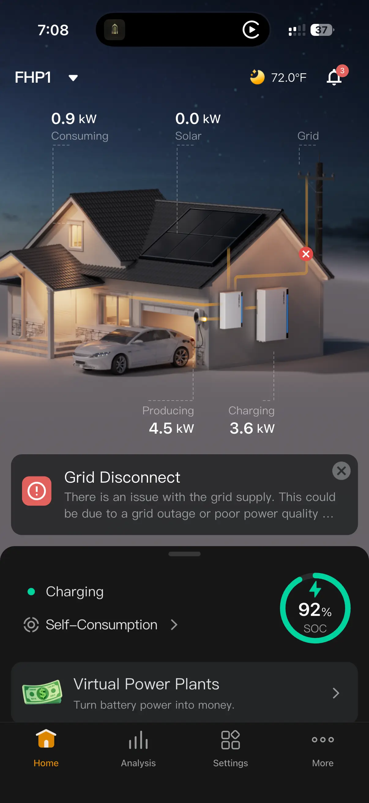

Hey everyone, I just wanted to share my success with using Pro Power and my Franklin’s V2L feature. I did have to clip the ground but after that everything worked perfectly. I was able to power my home and top off my battery at the same time. Just getting the testing out of the way before winter!

Very interesting. So what you’re saying is that the aGate sees the Lightning as a “generator”? Also, when the Lightning is exporting power to the aGate, is it actually powering the home or is it topping off the battery to extend battery charge pending normal solar recharging?
My aGate is set up to use the Lightning as a vehicle for V2L. This isn’t very different from the Generator function of the aGate. You can also use the Lightning in Generator mode, though the startup process is a little different. Both functions use the same inlet and Generator Module on the aGate. Generator Mode just has more settings related to generator functions, which I’m not too familiar with.
My Lightning was doing double duty, powering the home loads while also topping off the battery. It looks like the aPower balances the Lightning’s output by prioritizing the home loads first, then sending any extra power to the battery.
