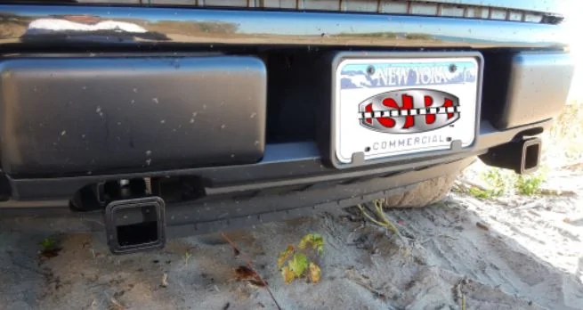

Looked like this:
Ford F-150 Lightning Any product to convert front tow hook to hitch receiver? 108d1443545130-tow-hook-front-end-hitch-hook-hitch
