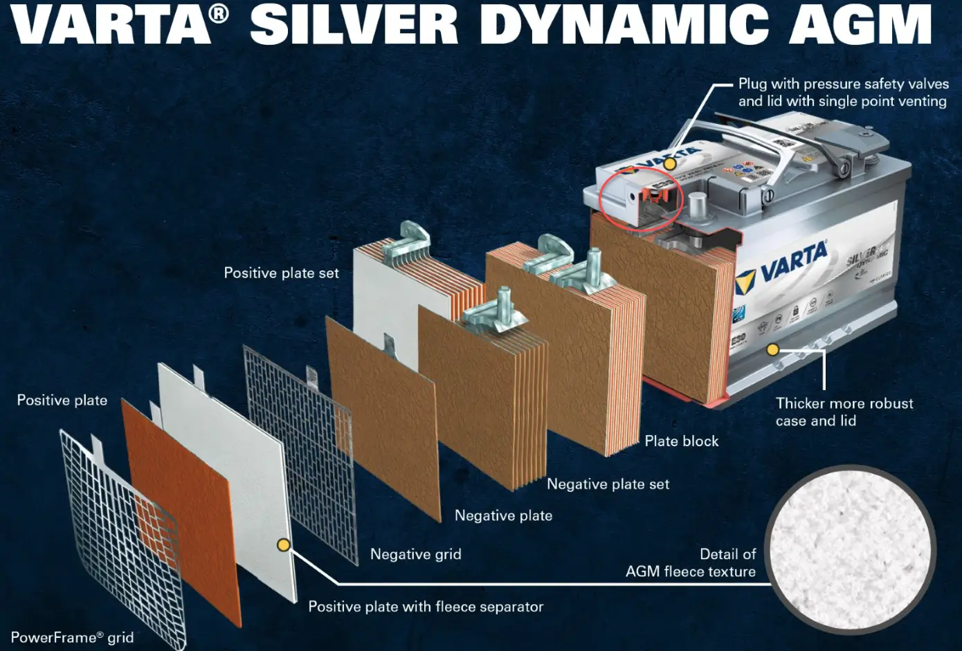

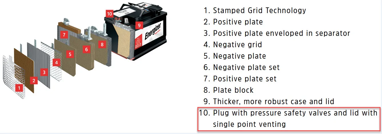

A sealed AGM battery?
240
16,894
19,218
Better safer than sorry, I'm in the @RLXXI camp, ya'll do what ya want....................

A lot of the automotive batteries look like they have vents on both ends.
A vent tube connects to outside on some of my vehicles with the battery that are inside the cabin.
Yes, they ALL have vents...so they won't explode if there is a major defect or extremely overcharged.
Under normal conditions, the gasses get recombined and very little is vented (1% they say).
Still want to know if any Lightning owners have noticed a hydrogen smell from their sealed AGM OEM battery - so far 0% say they have.
