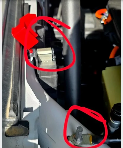

As everyone knows, wires connect point A to point B electrically with low resistance.
So the jump terminals thereby electrically connect to the battery via wire in some low resistance manner and that manner for the negative terminal is downstream of the BMS as shown in this picture by the blue circles.
If the jump terminals did not connect to the 12v battery electrically (the negative terminal being downstream of the BMS), there would be no 12V voltage on them would there?
There is nothing 'magical' about the jump terminals connection to the blue circled points in the picture. It is a low resistance electrical connection. (The negative ground terminal of the battery downstream of the BMS and the negative jump terminal are also grounded/electrically connected to the chassis/body of the truck so the negative connection could be made to the chassis/body.)
You will find the jump terminals are electrically connected directly to the blue circled points with low resistance (near zero).
@RLXXI There is no reason you cannot connect a charger to the blue circles without any harm. Electrically it is the same as connecting to the jump terminals.
Do NOT connect a charger to the red X's. If you did that you would 'screw up' the BMS and it would have to be recalibrated.
BTW, based on some posts about Ford mobile services, remarkably, some Ford tech do not know where to connect their battery chargers to the Lightning and go with the red X locations. (Some updates require the battery be on a charger correctly connected.)

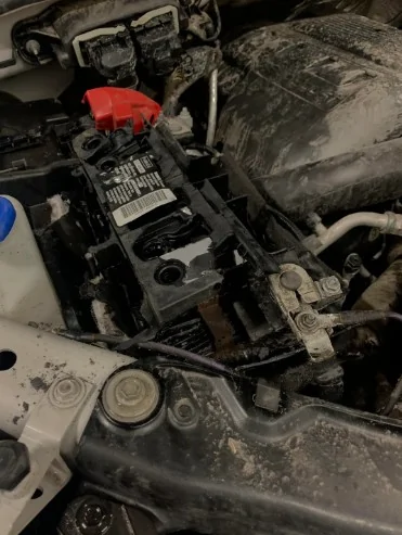

I'll give you a little leeway because you haven't seen or experienced what I have over the past 40+ years as a professional auto tech so I'll simply leave you a couple pics WHY you should NEVER connect a charger or jumper cables directly at the battery.
Ford F-150 Lightning A few of questions for the Gurus batteryboom
Ford F-150 Lightning A few of questions for the Gurus batteryboom1

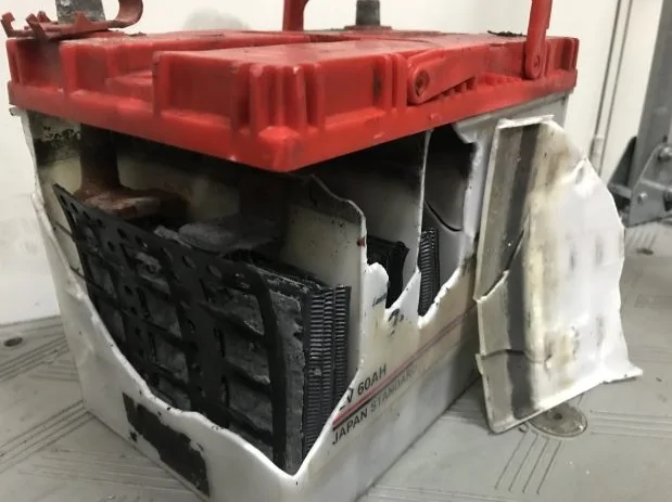

Are you familiar with hydrogen gas? Did you know that SLA battery contains a lot of it? Never had one blow up in your face?
You do you, I'll do it the right way.

I've personally have had the battery explode 4 times in my life, two of those times was my own vehicle. The other two were customer cars. I went to school for automotive technology in college and 40+ years in the profession has taught me they knew what they were teaching.
Like I told another uninformed user, you do you, I'll do it the right way.

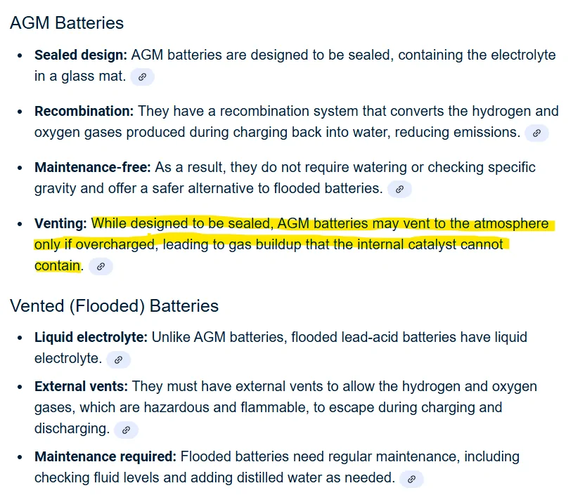

Because the Lightning LV batteries are sealed AGM batteries - they should not leak unless extremely overcharged (causing the safety valve to open and vent) or physically damaged.
During nomal charging they are designed to be recombinant and NOT release the gases produced during charging.
So the chances of a gas leak are very low....but safety first.
Q: Has anyone ever smelled hydrogen gas coming from the Lightning AGM sealed OEM battery?
I did a search and did not find any reports of that, but maybe someone has seen that and not reported it. From what I've read it seems that an AGM battery leaking gas generally would only happen if it is being/has been overcharged/overheated, damaged, poorly manufatured or maybe at the end of its useful life.
Nearly all AGM batteries are "recombinant" - what that means is that the Oxygen and Hydrogen recombine INSIDE the battery. These use gas phase transfer of oxygen to the negative plates to recombine them back into water while charging and prevent the loss of water through electrolysis. The recombining is typically 99+% efficient, so almost no water is lost.... AGMs ... even under severe overcharge conditions hydrogen emission is far below the 4% max specified for aircraft and enclosed spaces.
The Lightning should not overcharge the LV battery - the opposite seems to be the problem we've been experiencing.
A good battery charger should not overcharge the LV battery either.
So leaking gas seems very unlikely... but sure, safety first.

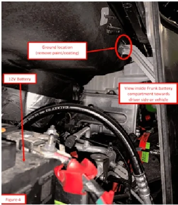

If concerned about leaking gas, then make the negative charging connection to a ground point on the chassis away from the battery as show below. The chassis is downstream of the BMS so not issue there.
Ford F-150 Lightning A few of questions for the Gurus where to connect neg for battery charger
Since LV battery issues seem to be a common problem, one might want to have a quality battery charger handy and follow the directions for use.
BTW, good battery chargers do not even produce a spark since they do not keep any charge on the terminals when they are off and not charging. So in that case, the worry about gasses can be put aside.
They are often advertised as "spark free" or "spark proof" and often protect against reverse polarity connections as well. See the NOCO GENIUS1: 1A 6V/12V Smart Battery Charger on Amazon for example:
" *Safety Features*: Overcharge protection, spark-proof technology, and reverse polarity protection ensure safe operation."
And if you follow the charger instructions (does anyone besides me read them? I hope so) you would connect the charger to the battery BEFORE plugging it into the wall, which is extra protection against producing a spark.
If you don't have a "spark-free" or "spark proof" charger and are worried about a spark, before connecting it to charge the Lightning battery (blue circles), and before plugging it in, touch the pos and neg clamps together and see if there is any spark. Use a resistor to discharge any residual charge that could be producing a spark from the terminals. Then connect it to the battery, and then plug it into the wall outlet.
If you are using another vehicle to charge the Lightning LV battery, and you want to watch out for a spark, use the safe step by step process for connection, generally: 1) Pos to pos then
2) Neg to chassis/body ground of the vehicle being charged.
But the chances that a seal AGM battery is going to leak gas are very low.
Q: Has anyone ever smelled hydrogen gas from the Lightning AGM sealed OEM battery? Hope not.
