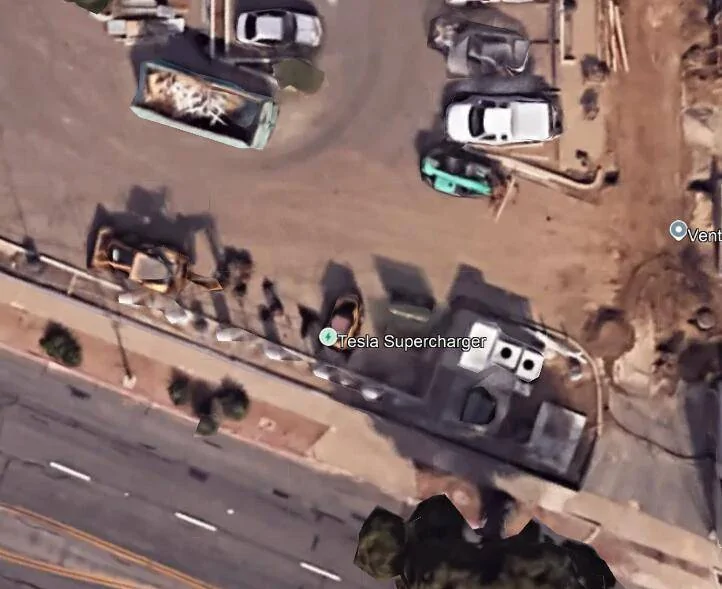

Anyone have any insider information on the A2Z NACS extension cable? It's still listed on the A2Z website as a future product.
I attempted to use a SuperCharger over the weekend that was V3 chargers that were against a wall so no possibility to use with my Lightning. It had only one stall open so could not use the pull into one spot and use the cable from the next stall over, either. The only nice part (on me), was right after I confirmed that I could not use it, a Tesla X drove by looking for a stall. I walked over and told him he could have the stall I was attempting in about 10 seconds. He was very appreciative and pulled a little forward so I could pull out. See, I can be a nice guy! Only good part was that I was not overly in need of a charge - it was more a convenience (I was eating lunch across the street). I got home with just under 100 miles left. Had I been desperate, there is an EA station that I almost drove past - along with several other fast DC charge stations in Ventura. Once I got back in the Los Angeles basin, there are more fast charges than you can shake a stick at.
So far I have charged nine times at Tesla SuperChargers (eight locations) and never had a problem being able to charge. Maybe I have just been lucky. The other SuperCharger in Ventura, CA is the same physical arrangement.
Sorry, not a very good Google Earth photo...
