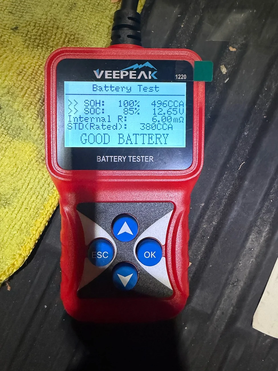

Hi, I periodically go into low battery mode which doesn't allow me to command starts etc on the app. It's annoying and often I will get into the car and it will be randomly making the 2d beeps and bongs as if the 12 volt is going down. I hooked up a load tester and it is testing as a good battery. What am I missing?
Ford F-150 Lightning 12 v battery tests good but it is going into low power mode IMG_2996
Ford F-150 Lightning 12 v battery tests good but it is going into low power mode IMG_2997
That's not a load tester, don't trust it. Get one of these instead. Schumacher BT-100 Battery Load... https://www.amazon.com/dp/B000AMBOI0?ref=ppx_pop_mob_ap_share

Your tester won't see a normal, age or use-related degradation in capacity until it is too late. It only does a cranking test and charging, not a capacity test.

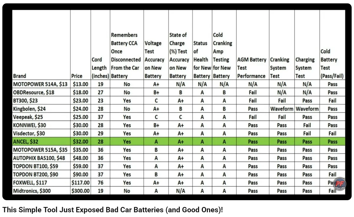

I just watched a lengthy video review of several battery testers, the VEEPEAK was not recommended, the Ancel was - here's a screen shot of the chart near the end of the video:
Ford F-150 Lightning 12 v battery tests good but it is going into low power mode This Simple Tool - evaluation chart

I'd like to get more than 3-5 years out of mine, so hopefully, the battery maintainer will do that - worked for me on other trucks and cars, fingers crossed.
