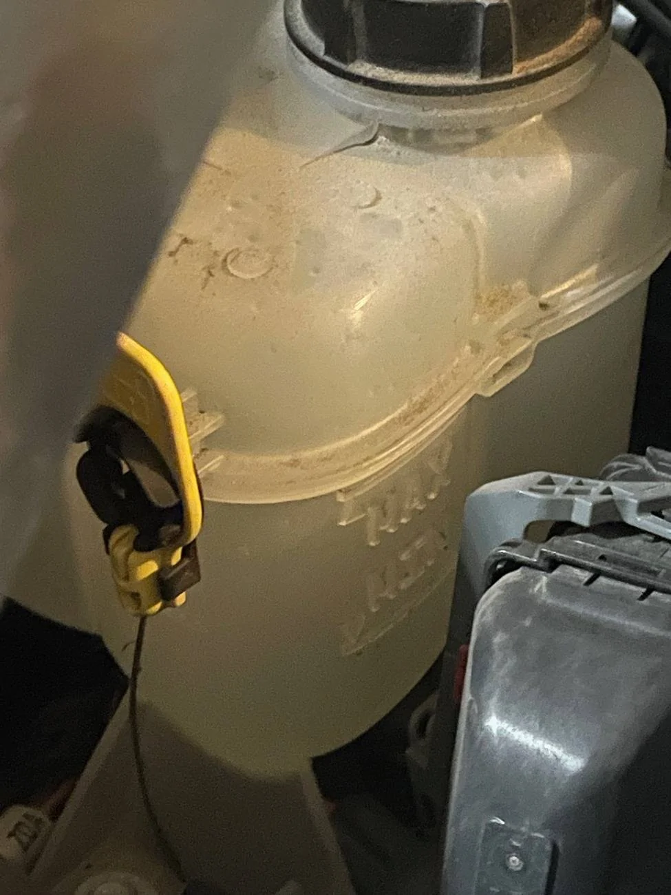

I am sure I could research to find it, but does anyone have a quick response to what is the proper brand/type of coolant to use? I am pretty sure I have this same issue. I can hear the coolant sloshing around most days. I did have a battery replaced about 2 months before I really started to notice it. Also my heat works sometimes and fails completely on other drives.

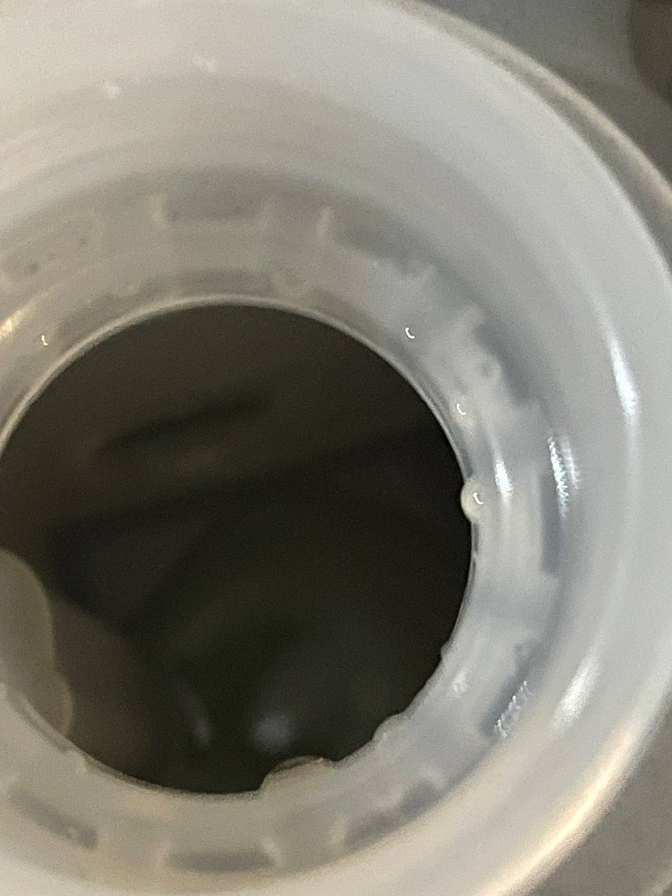

So this appears to definitely be my issue. Coolant reserve is completely empty. Hope filling it up doesn't break my home integration system.
Ordered the correct one off Amazon for same day delivery.
Update: I got the coolant and added about 1/4 gallon to get it about halfway between min/max. Ended up needing to drive about an hour and when I got home it had forced out the air. I was back down to where nothing could be seen. Added about another 1/4 gallon now to get back topped up, and will check after my next drive.
