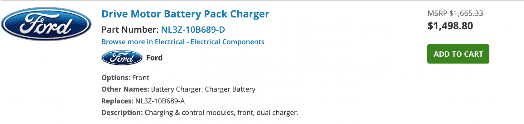

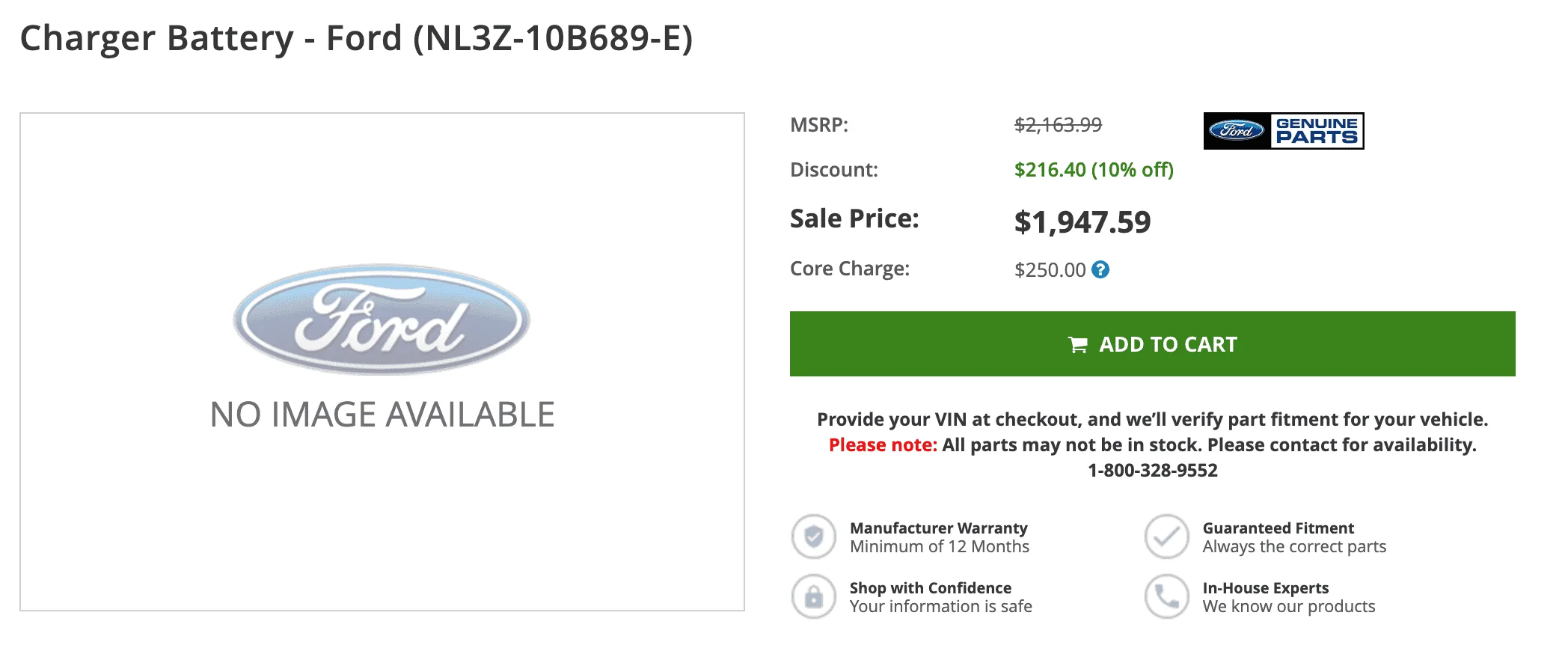

I had an EcoBoost F150 as a loaner while mine was in for a new battery module, so I feel your pain.
That part cost didn't make sense to me because onboard chargers aren't usually that expensive. Do you know which one they're replacing?
Front:
Ford F-150 Lightning 2023 Lariat ER needs a new onboard charger 1707052490388
And the rear:
Ford F-150 Lightning 2023 Lariat ER needs a new onboard charger 1707052664416
Front:
And the rear:
Labor?
Front:
And the rear:
The service advisor said it was on he top of the battery pack. It is the dual input charger that takes AC and converts it to DC. I think the parts you are showing are for taking DC from the motors during regen to charge.
