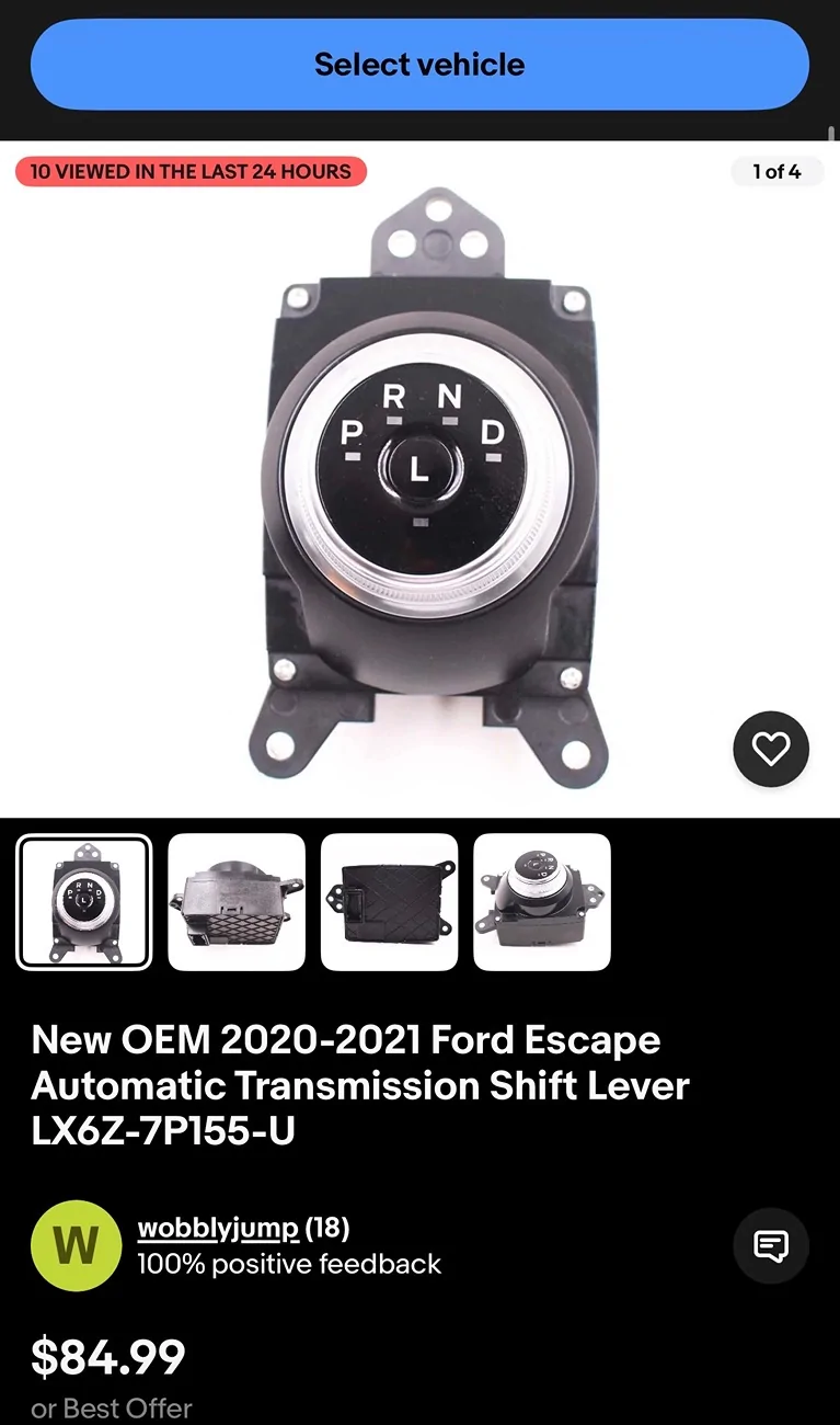

@Keanen i wish i had a good update bud but I took a chance and ordered one off of eBay and got a JX6P instead of a LX6P that they had advertised. Another forum member got the same model and it threw a bunch of codes so I didn’t even bother installing. Guess I will have to get an OEM like I thought I should have in the first place 🥲

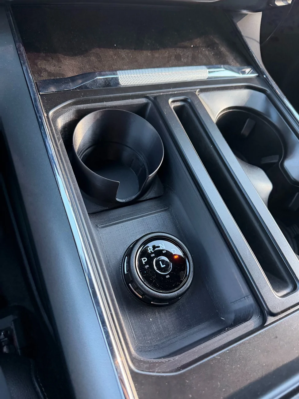

Also got duped on the wrong part, didn't notice until after the truck rejected it. The ebay seller is allowing a full refund even after knowing I dremeled off a bit of plastic so the part fit the 3d printed shell. I can't complain about that. Just ordered the same shifter as @T3Fan from my local ford dealer. Had 50 bucks in points thanks to getting new Michelin Defenders a couple weeks ago.

They are selling PZ1P-7P155-AC as LX6Z-7P155-U. If you want a non motorized one, you are good. But you won't get the LX6Z-7P155-U from them.

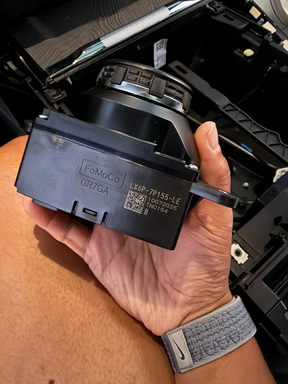

So interestingly enough, I was a bit surprised to open the LX6Z-7P155-X box at the dealership parts counter and find a different part number inside lol. It appeared to be a brand new factory sealed box, so the parts guy said they do that sometimes hmm. I verified the LX6P-7P155-LE part number via this thread, so I took it home and gave it go. I've now confirmed for myself that it's both motorized AND lit up via ambient lighting ring at the bottom. I think I've gotten out of the truck with it still in gear at least once daily since installing, just to satisfyingly watch it turn back towards park haha.
On a side note, add another happy @PolymerBuilt insert user here as well.

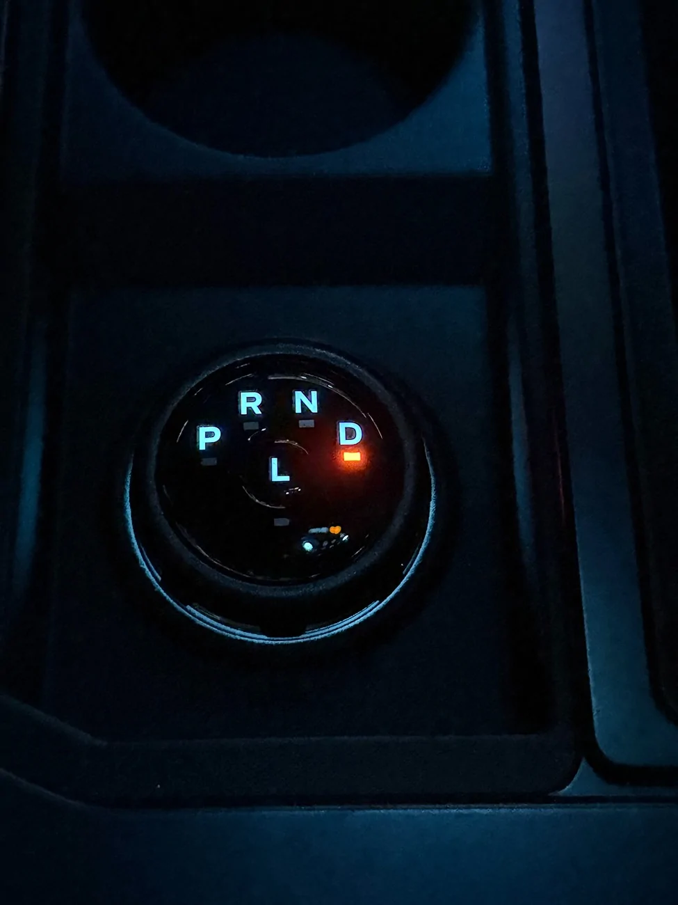

That's exactly the same one I got, the -LE, and it works perfectly. I love the Bronco Sport rubberized ring and the little blue ambient light at night.
No error codes or DTCs ever from day one.

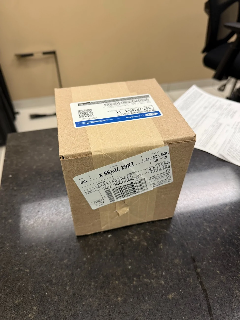

Were you able to get 155-X installed, and if so, did you have to make any modifications to the part?
Thank you to all the contributors on this thread. I used the LX6Z-7P155-X shifter. Zero issues with install or recognition by the Lightning (no error codes). I did not need to make any modifications to the part. Rotary shifter works perfectly. The rubberized ring, motorized feature, and ambient light at night are nice touches!

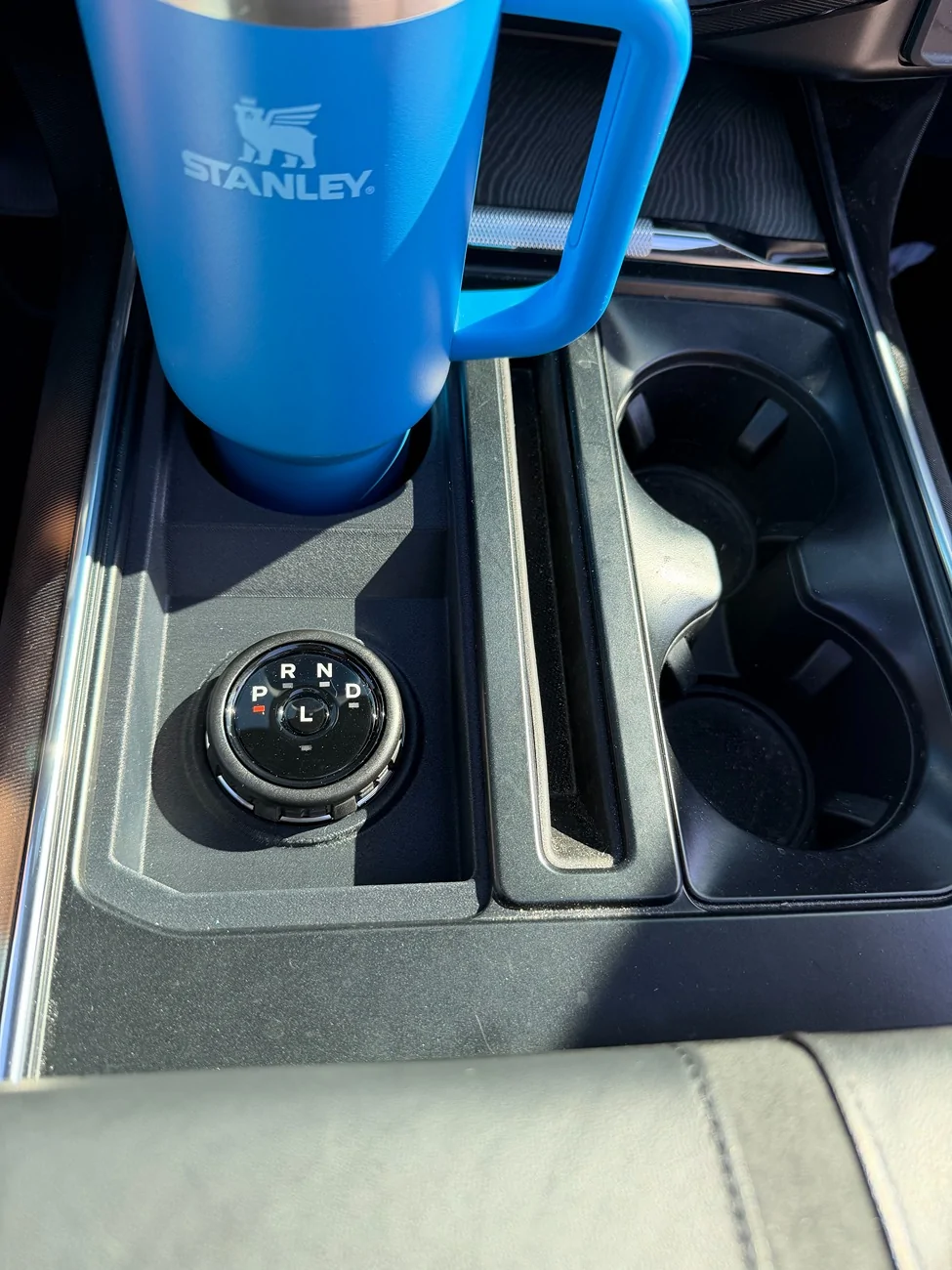

Ford F-150 Lightning Rotary Shifter Part Numbers IMG_0831

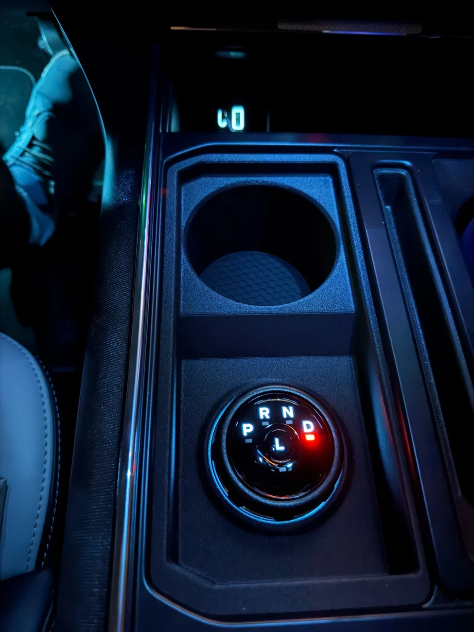

I ordered a second version from the original supplier of these Manion Makes after he introduced a "finless" version of the binnacle, which I much prefer.
Taking inspiration from the OP, I hit mine with a few coats of sandable primer, then matte black paint, then matte clear with plenty of sanding along the way. This looks closer to factory than my first attempt using a satin clear to finish, which was much too glossy.
I wanted it to turn out nice and not look rough and unfinished. I am no painter by any means but I took my time and I'm pretty happy with the result.
