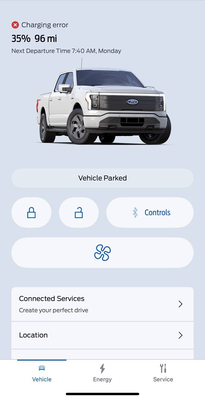

So I just got module 2 replaced two weeks ago due to a bad cell. They had the truck charged to 100% everything seemed to be working normal. Today I take a 2 hr each way trip. Stop to charge on the way back and I get a charge station fault. There’s a level 2 right beside it I try that and it won’t start either. I try heading to a Chargepoint DC charger and it won’t work either. It was almost 6:00 so I had to just drop it off at a nearby ford dealer go to enterprise to get a car to get home.
Anyone else have this happen? What’s weird is when I open the charge door the lights keep flashing red like it thinks it’s still plugged in. The service writer said it had a lot of error codes the machine wouldn’t clear them so their ev tech would look at it sometime next week.
