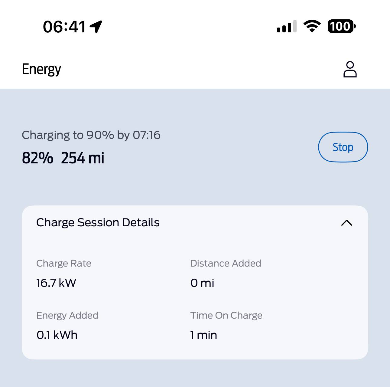

Yeah there's is something more going on here. I took a little drive to test it out this morning, deleted all settings again as suggested by @TaxmanHog.
Got home and plugged in, this time it initiated charge to 90% as required

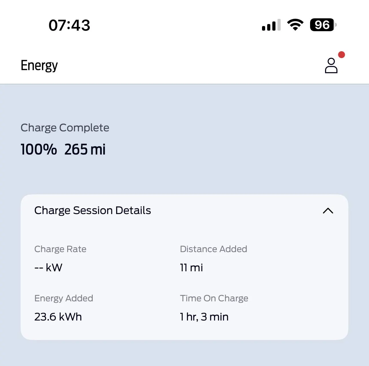

Then received a "Charge Complete":
Ford F-150 Lightning 23 ER not charging {Fix post 66} IMG_4859 2
Im going to have to explain this to the dealer as the equivalent of having a bad fuel gauge sensor lol

Great news! Got my Lightning back & everything is back to normal. Service Advisor stated that it was a software issue. They updated multiple powertrain & battery modules to the latest software. Thanks again for the helpful y’all! ?
