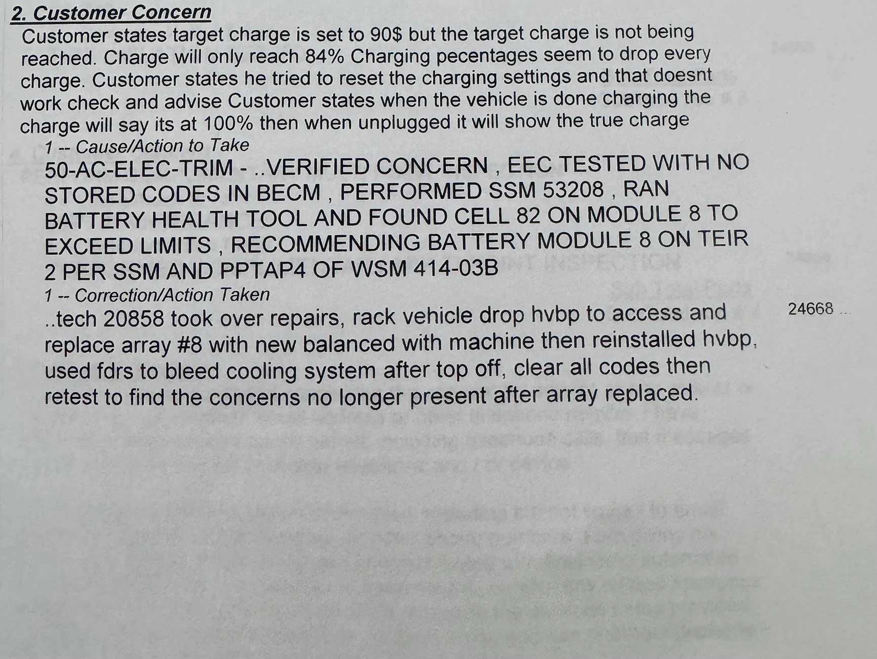

Update: Got her Back! Looks like it was #8 Module that was bad. Hopefully, this is it and nothing else comes my way.
Oh wow, looks like they already took care of it for u as well?
