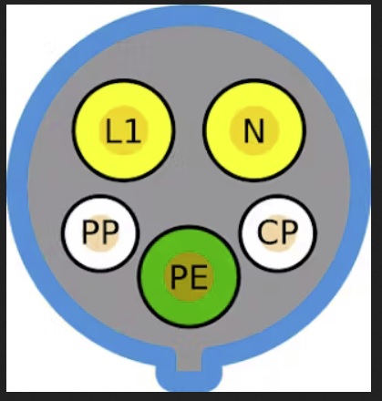

1) There is no need for modification of the CCS1 plug - the adaption can be achieved by modifying a J1772 plug on an J1772 extension cable so that it fits the top part of the CCS1 plug - so any heat sensors in the CCS1 plug would not be affected. However I have seen no indication that there are any heat sensors in the CCS1 plug of the FCSP from looking at the wiring - the wiring of the plug is the standard CCS1, that is J1772 combined with two pins for DC . If there are any heat sensors, they would be inside the FCSP and at the Lightning charge port. If overheating is sensed at the truck or inside the FCSP, signaling would effect a halt to charging and a fault indication would be displayed on the front of the FCSP.
2) The little piece of plastic removed at the bottom of the J1772 so that it fits the top of the CCS1 should not affect the secure connection of the J1772 since it latches at the top and the rest of the J1772 plug (curved sides etc) keep it aligned with the top of the CCS1 plug.
3) As long at the CCS1 plug and the modified J1772 plug securely seat and latch there should be no heat or fire risk any more that if the J1772 extension was used to extend any other J1772 EVSE output cord.

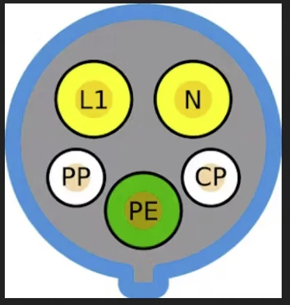

4) The CCS1 top portion with the J1772 connection is just a standard J1772 plug (see pin out images):
CCS1
Ford F-150 Lightning 80amp charger questions CCS1 pin out (2)
J1772
Ford F-150 Lightning 80amp charger questions J1772 pin out

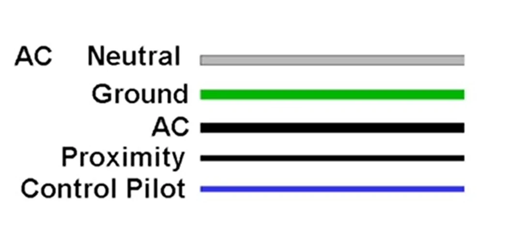

J1772 wires
Ford F-150 Lightning 80amp charger questions J1772 cable wires

5) On the FCSP, the DC plug pins are not used unless a Home Integration System (HIS) is installed - the ones in the truck are not energized unless signaled to by the HIS - so there should be no danger of having them uncovered when a modified J1772 is attached. The FCSP is incapable of DC charging or providing DC out on those DC pins.
