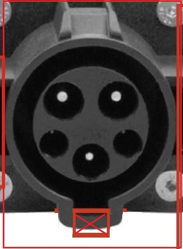

A forum member contacted me to try my FCSP last summer to see if his ER Lightning would charge at 80A and then, when it did, he went and got the dealership to give him a FCSP free. My understanding was that he needed the faster charging because of the number of miles he drove every day.
For about $150 you can adapt the FCSP to work with a non-CCS1 vehicle by buying a j1772 extension and trimming a small piece of plastic so it will fit into the CCS1 J1772 part.
Ford F-150 Lightning 80amp charger questions 00-CCS1 to J1772 DIY-2
Where the "X" is.
There are plenty of J1772 to NACS adapters one could use with the extension cable as well if needed.
Or if you are electrically savvy, just replace the CCS1 cable with an 80A J1772 or NACS cable and plug - they use the same signalling for AC (L2) charging to tell the EVSE to close the contacts and connect the vehicle to the 240V source.
If you have a Lightning now with CCS1, you'll need to use an adapter (NACS to J1772) to any NACS charger you install to use for the next 8 to 10 years you own your Lightning anyway.

I don't believe that last guidance to be true...at least for Tesla's. I shaved that plastic part off and connected the NACS adapter to the CCS plug as you suggested and it only resulted in charge faults against a 2023 Model Y.
So if have personally performed this surgery (as I have), and it worked, then please do share which vehicles you successfully charged using the FCSP charger?
This was not originally intended for an NACS adapter - this was for a J1772 extension cable - the part to shave off allows the J1772 plug to fit onto the CCS1 plug for example L2 (AC) charging.
But assuming the NACS adapter has a J1772 end and that is what you altered, I have no idea why it did not work unless there is something inside the NACS adapter that alters the J1772 signaling or the plug did not make a good electrical connection with the NACS adapter's J1772 side, or Tesla has some other NACS adapter feature that caused a problem.
If the plug seated properly and fully in the J1772 socket part of the CCS1 plug, and made good electrical connection, it should have worked because/if Tesla uses the same J1772 standard signaling for L2 charging, so I suspect the adapter might not be fully electrically connected to the CCS1 plug.
I have not bought a J1772 extension cord and performed the surgery myself but another Lightning FCSP owner had and posted that it worked on their J1772 vehicle - don't recall the make or model but I don't think it was a Tesla. I will see if I saved the info about the post and get back to you.
In the mean time:
1) test the continuity of the pins on the adapter you modified one by one and see if they are carrying the test current and
2) check the fit of the adapter into the CCS1 plug to see if it seats fully.
