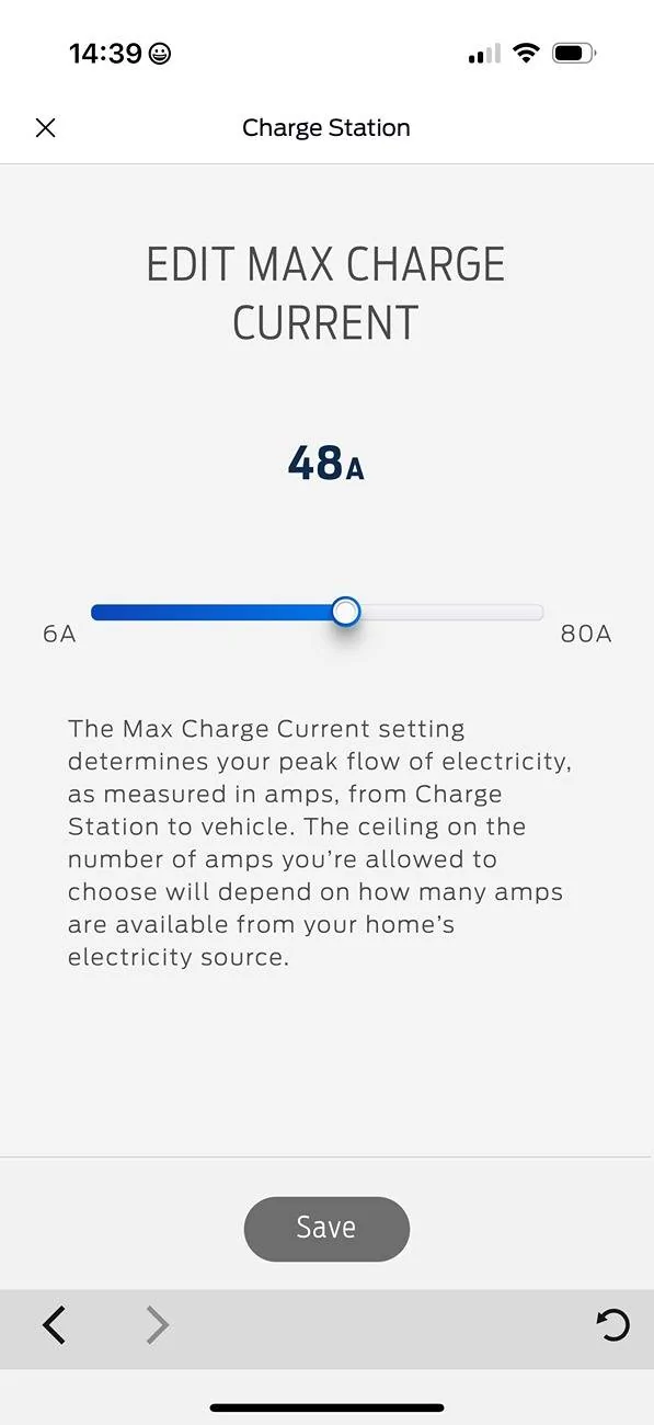

i just got my Ford Wall Charger Pro installed yesterday.
its on 60amp breaker(circuit?) and its set at 48A(as labeled by the electrician who installed it)
when i initially opened the app, Charge current was initially set at 6A, i thought this was wrong so i set it at 48A. did i set it right? i tried setting to 60A (to match the breaker) but i get a "Charge Station derate failed".

Set at 48 amps for continuous duty, that's the maximum for a 60 amp wire/breaker install.
Take note, that your installer probably set the rotary switch to the 48 amp setting inside the FCSP case, never change that to more than 48 amp value!

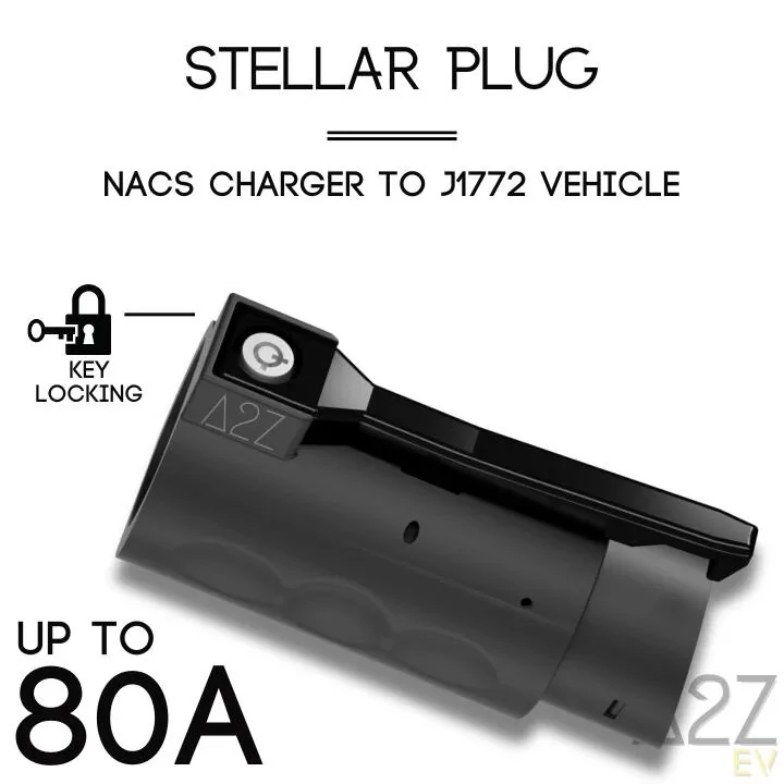

A2Z EV has the NACS to J-1772 adapter rated at 80 amps with built in lock on flash sale for $71.25 shipped and comes with a 12 month warranty. You can use this with the 80 amp Tesla High Powered wall connector or the regular Tesla home charger to charge your lightning.
A2Z EV has a sale going on right now for NACS to CCS1 adapters ($170 to $127.50) / A2Z EV Stellar NACS to J-1772 AC Level 2 Adapter ($95 to $72) after discount code to save 25% off and get free shipping.
Click the link to chose your below products and stack the temporary code "FLASHSPRING" to save 25%.
New orders: Current estimate for A2Z is shipping will take 2 weeks for the new Typhoon Pro adapter. Still in time for travel plans in June.
You can bundle the A2Z Stellar AC Tesla to J-1772 adapter for Hotel Destination charger for $73 additional after discount by adding both into your cart. This adapter is used with Tesla home chargers or Tesla Destination chargers which are commonly found at hotels, parking lots, shopping centers and Airbnb.
A2Z EV NACS to J-1772 - AC adapter for home / hotel destination chargers - 80A
A2ZEV NACS To J1772 adapter (Hotel Destination Charger for Hotels / Shopping centers) | Up to 80A | 20kW | 12 Months Warranty
A2Z EV Typhoon Pro NACS To CCS1 adapter - DCFC adapter - DC adapter 500A
A2Z EV NACS TO CCS1 Adapter - Save 25% / Free Shipping + bundle the A2Z Stellar AC NACS to J-1772 adapter for $72 additional after discount code "FLASHSPRING".

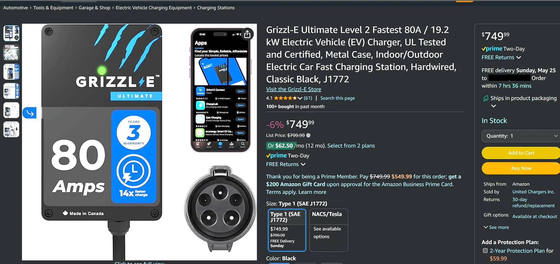

Grizzl- E 80 Amp is also available for a little bit lower at 749.99 on sale instead of $1,169 with Autel
Grizzl-E | 80 AMP Home AC Charger

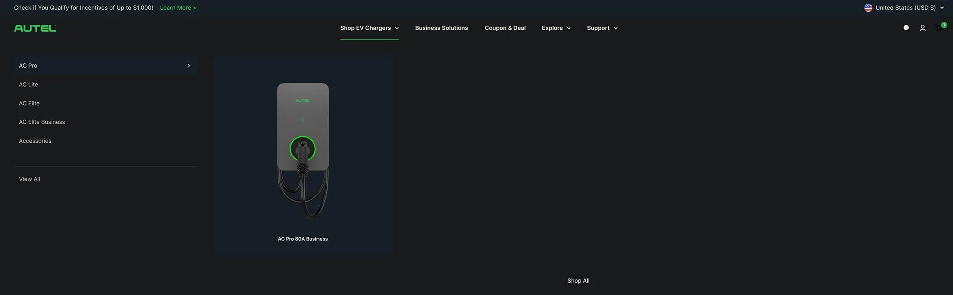

Another option is to buy the Autel AC PRO Business 19.2 kW / 80 amp EV charger and stack the 10% off "SAVE10" code on top.
Click the below link, navigate to shop ev chargers > AC Pro > AC PRO 80 Amp Business charger. Add to cart and stack the "Save10" code.
This way you can charge using your native J-1772 port and don't have to worry about adapters.
Autel EV Home Smart Charger- Save 10% (SAVE10)

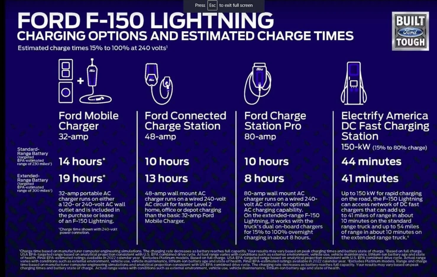

Honestly I question the need for 80A charging. Take a look at the Ford published figures for charging from 15-100% below. Unless you have an ER battery, there is no difference in charge time from 48 to 80A...and even with the ER battery, the charge times shown are worst case.
My tl;dr take is that 95% of all people should be perfectly fine with a 48A charger for overnight home charging.
1) You are (or rather SHOULD) not be charging to 100% but for the few long distance trips you need to take per year. Otherwise, you are likely charging to 80% on any given day
2) Given charging is fast up to 80% then slows to a crawl from 80-100%, the charge times below are reduced considerably.
3) Given most don't allow their vehicle to get down to 15% but likely closer to having 30% be the starting point, that shrinks the time further.
I have the CSP connected to a 60A circuit, so 48A charge capabilities...and I see ~8% charge added per hour. Meaning that you only need a little over 6 hours to charge to 80% from 30%...which is typically more than doable via overnight charging.
Here are some of my experiences:
Start / End charge - Time to complete
19% / 51% - 4:02 hrs (actual time...ended charge early)
32% / 80% - 6:36 hrs
20% / 80% - 7:37 hrs
31% / 100% - 9:19 hrs
