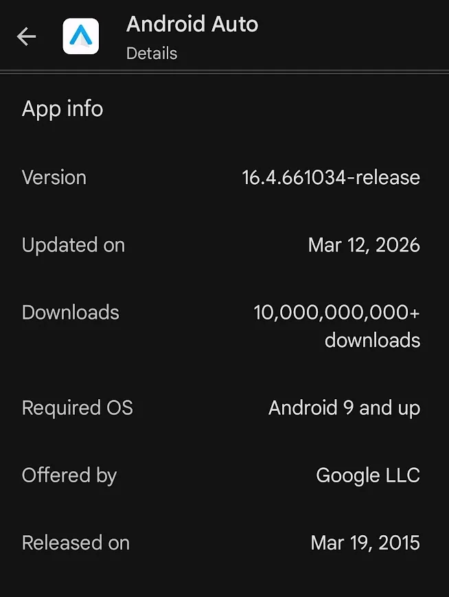

Android Auto 16.4.661034 Bug fixes
236
16,701
18,897
Ford F-150 Lightning Android Auto 16.4.661034 Bug fixes 1774046156308-n
K6CCC
Sep 12, 2024
1,198
1,296
Glendora, Calif.
Installed...

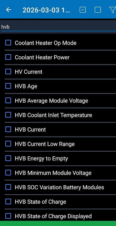

Can someone remind me which sensor to check in car scanner for battery preconditionning?
I did a 400 miles return trip to Austin TX last week and didn't notice a lack of DCFC speed (3 stops with consistent 160kw+ from the get go).
I'll be doing that same trip tomorrow (yeah spring break's over for my freshmen) and would have the opportunity to do so.
236
16,701
18,897
I would watch the coolant temperatures associated with the HVB.
The Coolant Heater Op Mode and Heater Power might only show activity in the cold season, this will be my first season watch OBD2 data in car scanner as the days warm up.
I'll try to remember to turn on the data logger next hot, long day trip involving the DCFC.
I'll see what shows while trying to chill the HVB in preparation for a charge or while it's in the process of charging.
