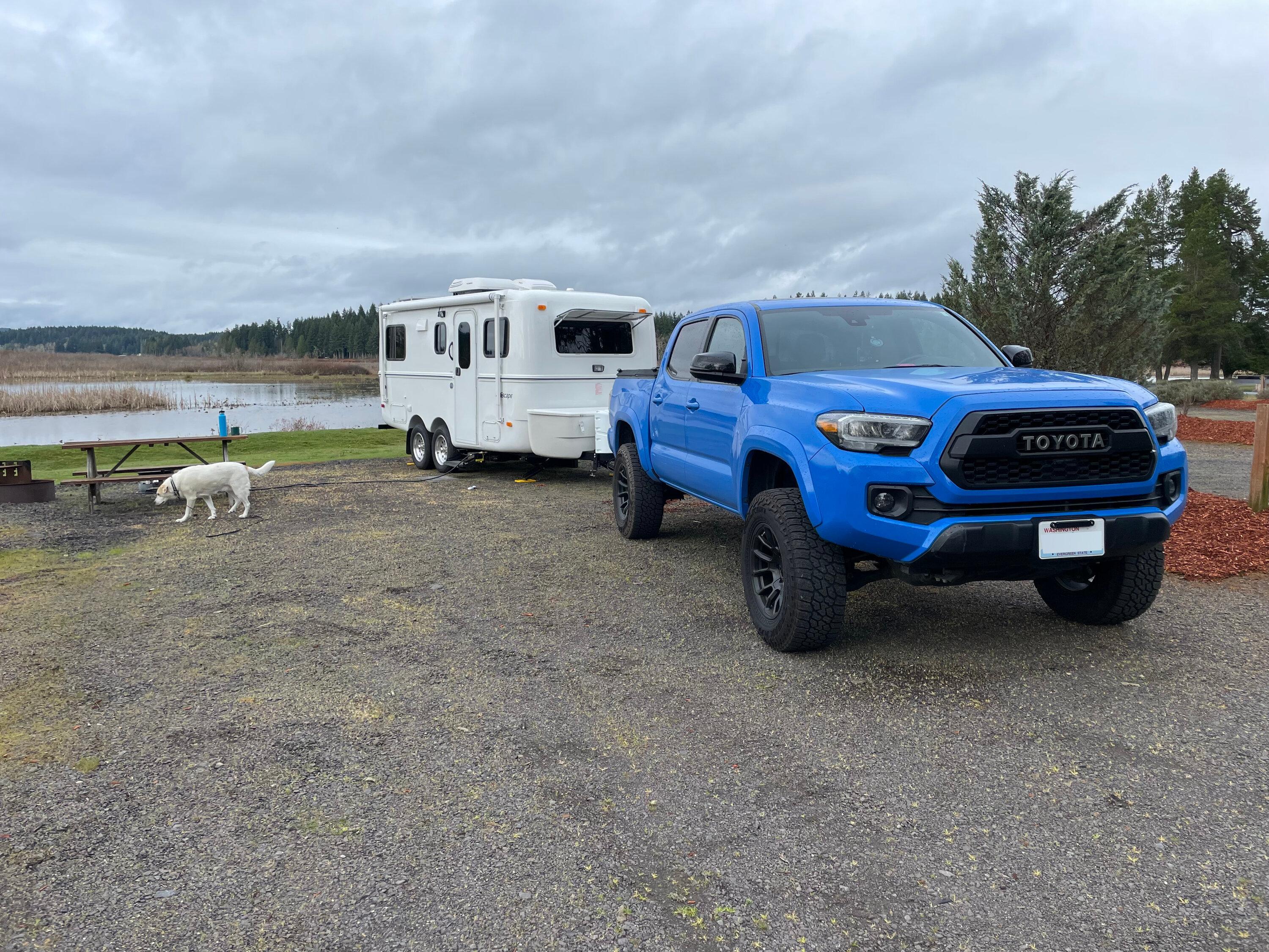

I tow this Escape 19 with my 2020 Tacoma. No idea what it actually weighs when we’re towing, but it’s 5000 GVWR so some amount below that.
Greatest advantage is that it’s more aerodynamic than most travel trailers its size. I get 12mpg towing it with the Tacoma.
I’ll be getting my Lariat ER in the next couple months to replace the Tacoma at which point we’ll be an all EV household. So I’ll be doing plenty of shakedown runs over winter to get some worst case data.
We don’t really leave Washington since there’s so many campgrounds, so I’m not super worried about range (yet).
I’m also pessimistically expecting 100 mile range, but hoping I can make 150, especially since we’re always slow going on Fridays heading out to camp due to traffic anyway.
One day I fully expect us to do some longer trips as well though and I’m just trying to remind myself that it may be different and sometimes stressful, but you can always adapt if you’re willing to slow down. And it’ll only get better as time goes on.
