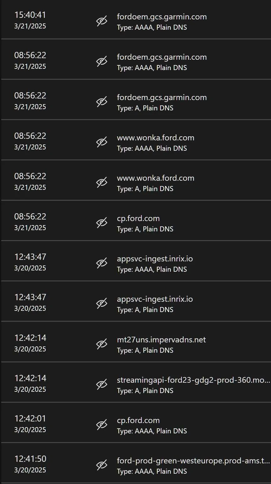

I have yet to see one SW update on my truck (since I've owned it, which is fine) but since my truck is "supposed" to check for SW updates at 1AM, daily. I started snooping through my Adguard Home logs to see where/when the truck should be looking.
I've included a snapshot of where the truck's IP is looking/connecting (and when)....however, I never see a timeframe near 1AM (I've seen some at 23:30ish - 11:30PM).
Does any other network snoop know the url/dns name of the actual software update check?
P.S. wonka.ford.com, lol, wth is that?

Check the time frame of when you start the truck {pushing the [START] button, that's when phone home occurs.
It likely uses AT&T telematics connection onboard the truck. Wifi was to be called on for large deployments.
1 am is for installing the package once downloaded and requires inhibit drive conditions

Hmm, thanks for the suggestions - that changes the approach of this ask then. I assumed when you setup wifi (they, Ford) would take advantage of your network, a la Tesla.
I believe the one at the top of my picture was after I went in and acc powered the truck to try to force the SW update time screen. I toggled it on and off.

Appreciate the screenshots and info!

Here are the most recent so you can copy vs the pic.
This is on an IoT network with 2nd DNS upstream resolver, past the pic entries shown.
