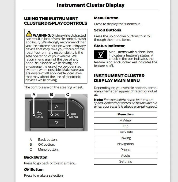

OK, I just bought a new 2025 lariat lightning. Can someone tell me where this power display of the wheels is located please. I’ve been up and down all the entries on the vehicle displays (after I press the truck icon at the top) and I can’t seem to find it anywhere.

It's on the Instrument Cluster Display. Use the up/down buttons on the steering wheel to look at it. You may need to add it in My View.
