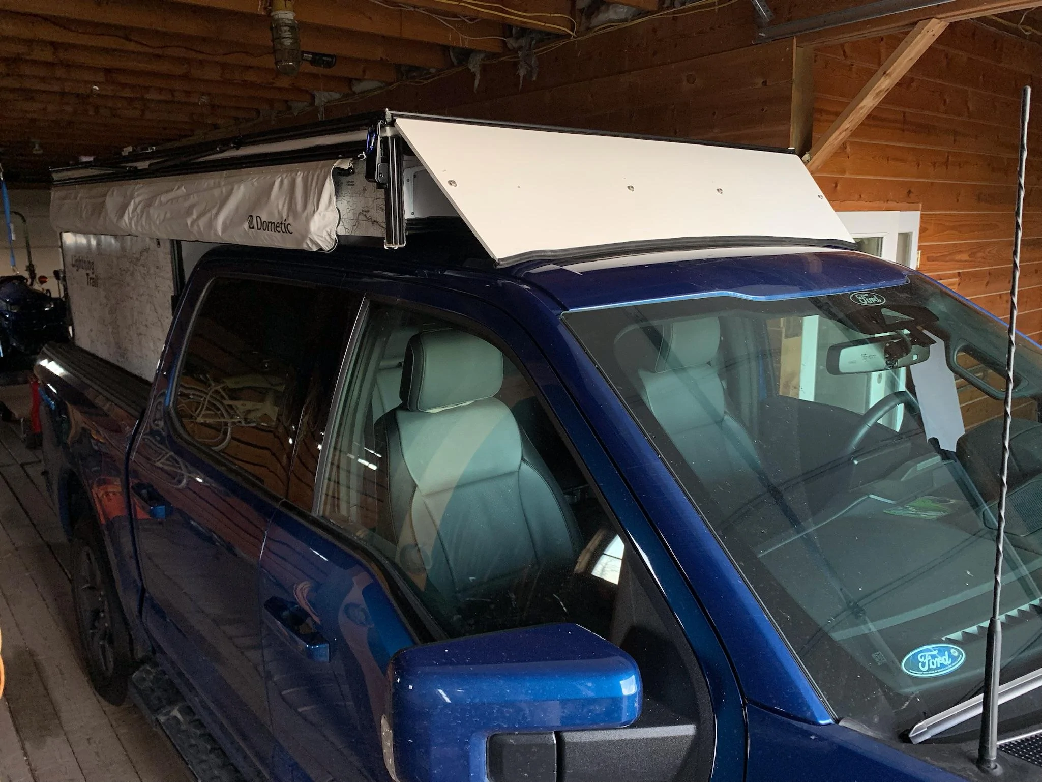

Fabricated and installed a front fairing, and tested it this morning. Significantly less wind noise now, but surprisingly little change in range. 1.9 m/kWh at 66 mph with camper and fairing vs 2.2 m/kWh without camper. But now that I think about it my previous test didn't have the awning mounted, so maybe awning drag offsets the fairing? In any case <14% range reduction. So charging to 80% and stopping to recharge at 20% gives me about a 150 mile range at 66 mph.
Headed to Oshkosh next week, so might see what 75 mph looks like if the charging stations are close enough. Might also try closing in the fairing ends at some point, and perhaps making a small streamline fairing for the front of the awning.

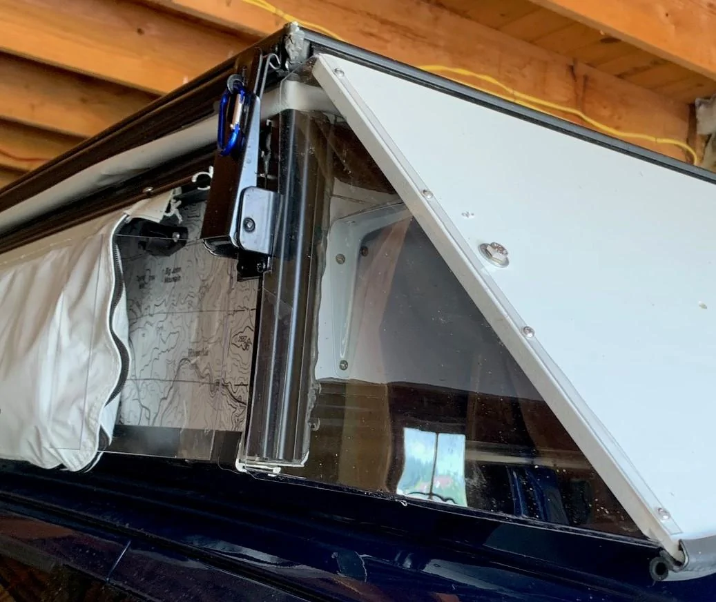

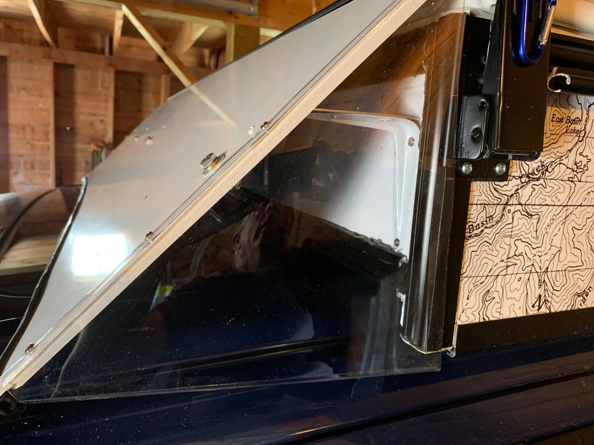

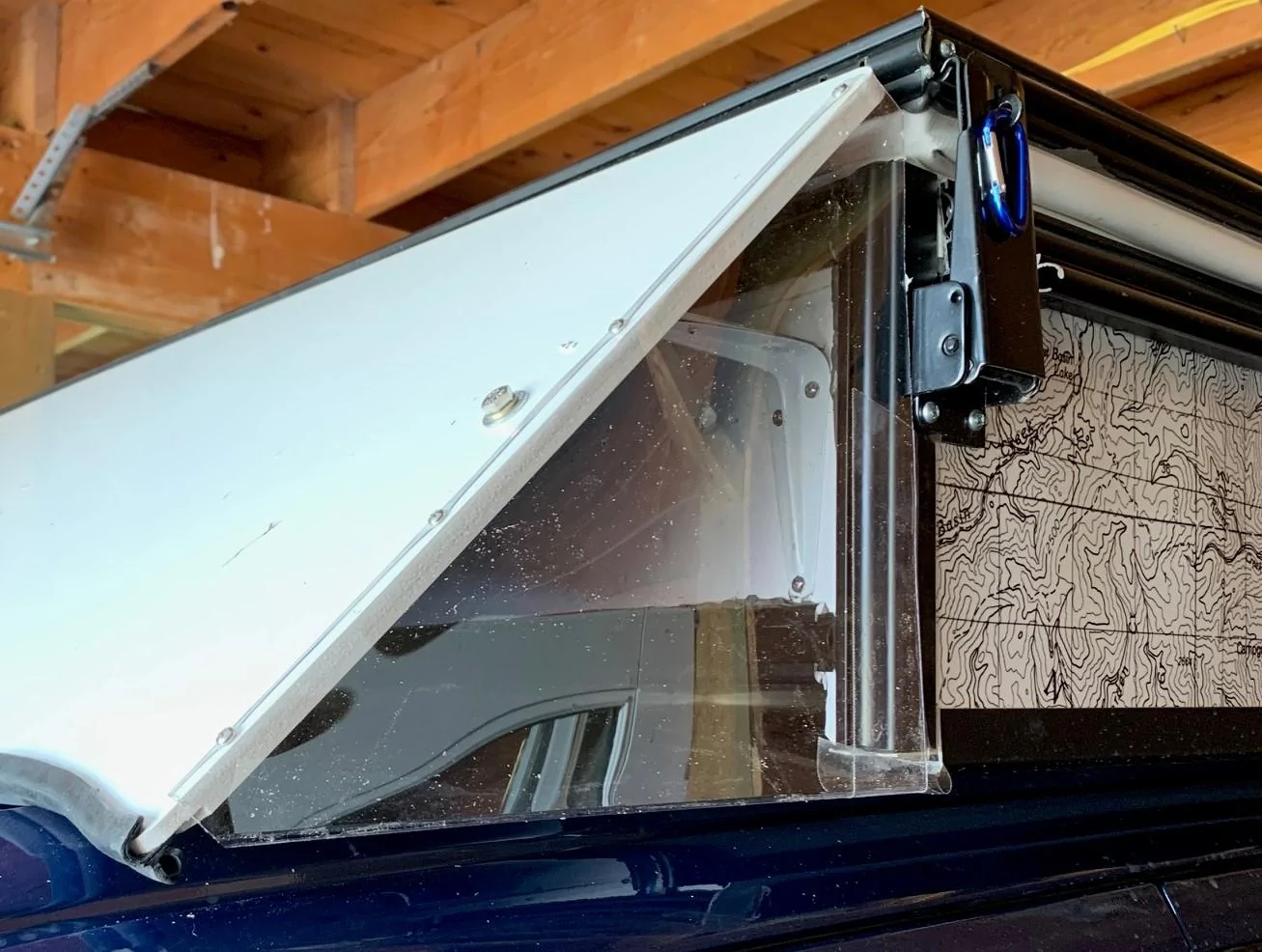

I had some scrap polycarbonate lying around, so fabricated some quick and dirty fairing end caps to try on the road. Also made a simple "z" fairing for the front of the awning. We'll see if they stay attached and help any on the trip this week.
But it also occurred to me that I'll have a bike mounted on a hitch bike rack - no idea what that will do to range, but one more variable to screw up the "scientific" data gathering. :)
I'll report on the trip when I get back, if anyone's interested. 2,000+ miles from Windsor, CO to Oshkosh, WI and back - first long trip with the Lightning Trail! (third long trip with the Lightning)

Hey Ken, I wonder if the PC end pieces for the main fairing will flap / buffet in the wind. Could you attach them to the camper frame around about their 90° corner?

Hi Toby. It's hard to see, but I put a small 90 degree bend (i.e. flange) on the bottom edge of the PC caps to stiffen them (and reduce flapping), then used clear Gorilla Tape to fasten the trailing edge to the camper trim. VHB tape might be a slightly better option. In any case, I'll learn how that holds up within the first 50 miles or so. It would be trivial to put a screw or two in the trailing edge, but I thought I'd try the Gorilla tape first (no new holes required).
Aren't you just a little impressed that I didn't use duct tape?? :)

Nice. But I would have preferred VHB ;-)

Who am I to pass up free advice from my professional M.E. friend?
Done. Took longer to clean off the tape residue than it did to install the VHB tape. Seems very secure and you can't even see the tape.
