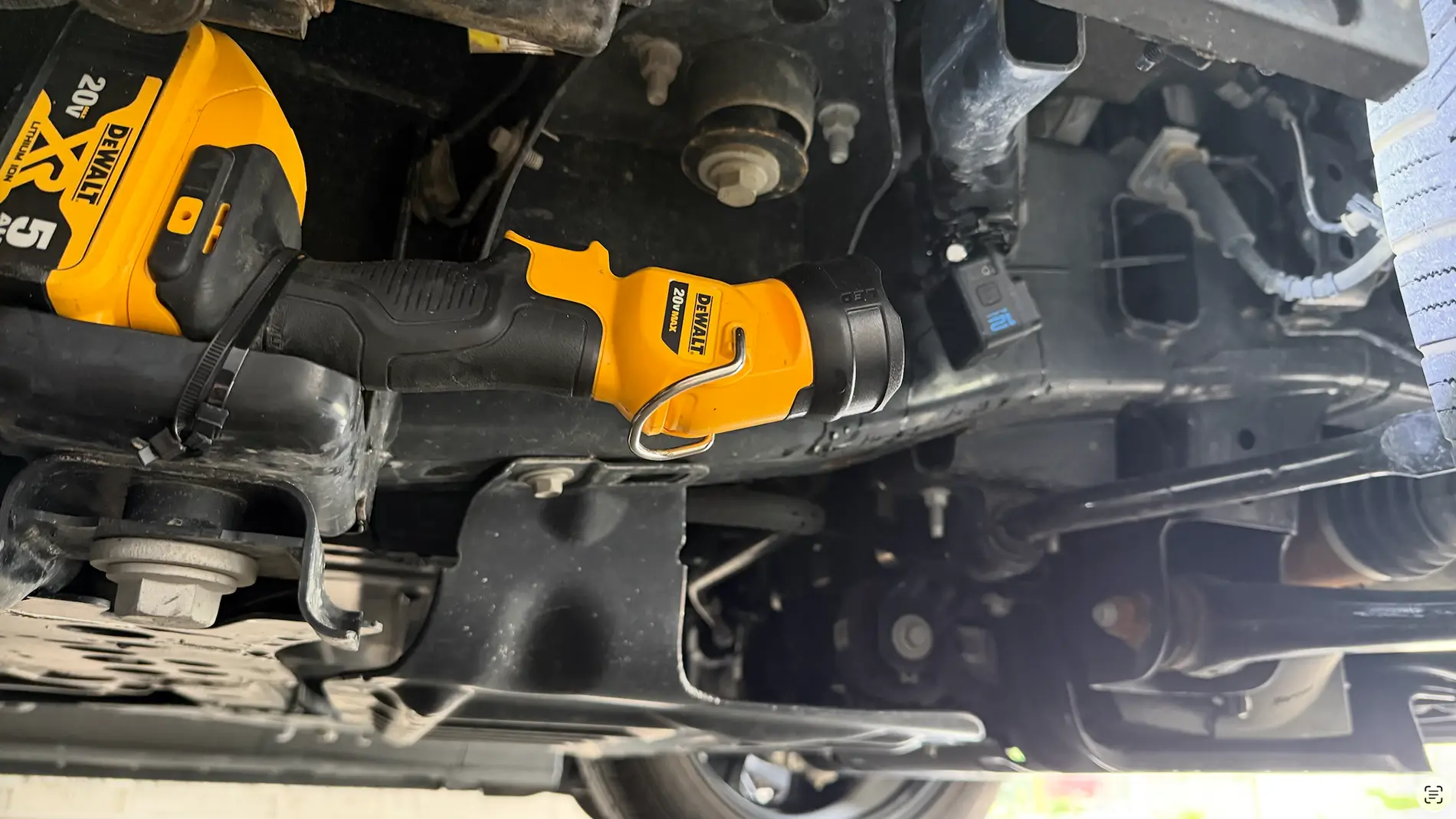

Thoughts? This was just around the neighbourhood -- I'll try to get a better bumpy/higher speed shot tomorrow. Left side (was raining) is not squeaking and dampens the spring better....but it's doing the work of both sides technically. My dealer said "you need a tire balance and alignment" your suspension is working perfectly.

Setup photo (no Siri) :)

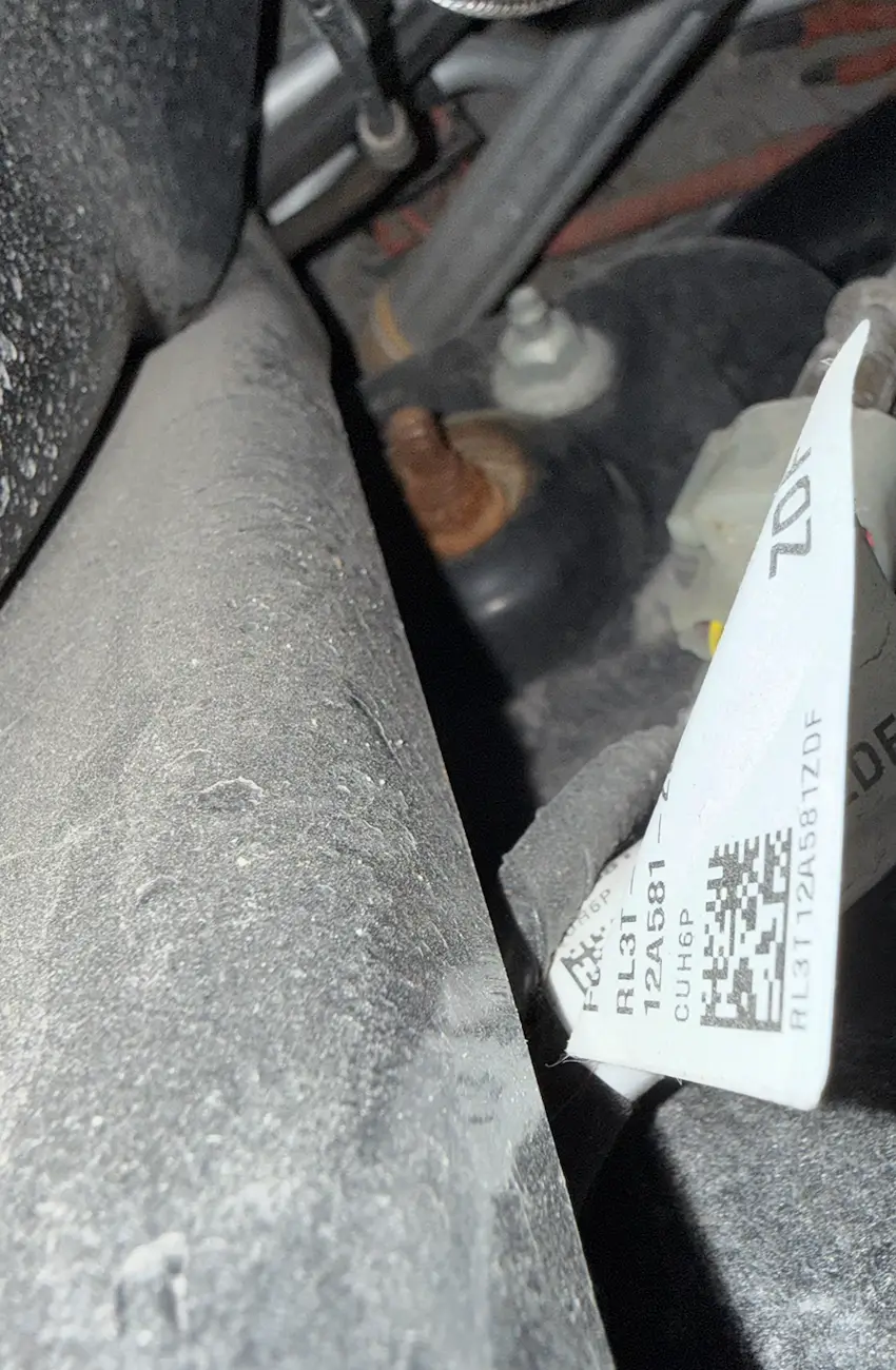

Are the top of the shocks normally rusty like this photo? This truck has only been on the road since November 2025 --

thanks for the ideas, I don't see anything leaking ... I gotta check the back as well, I keep thinking it's the front, but maybe the back is causing the chattering and shaking.
