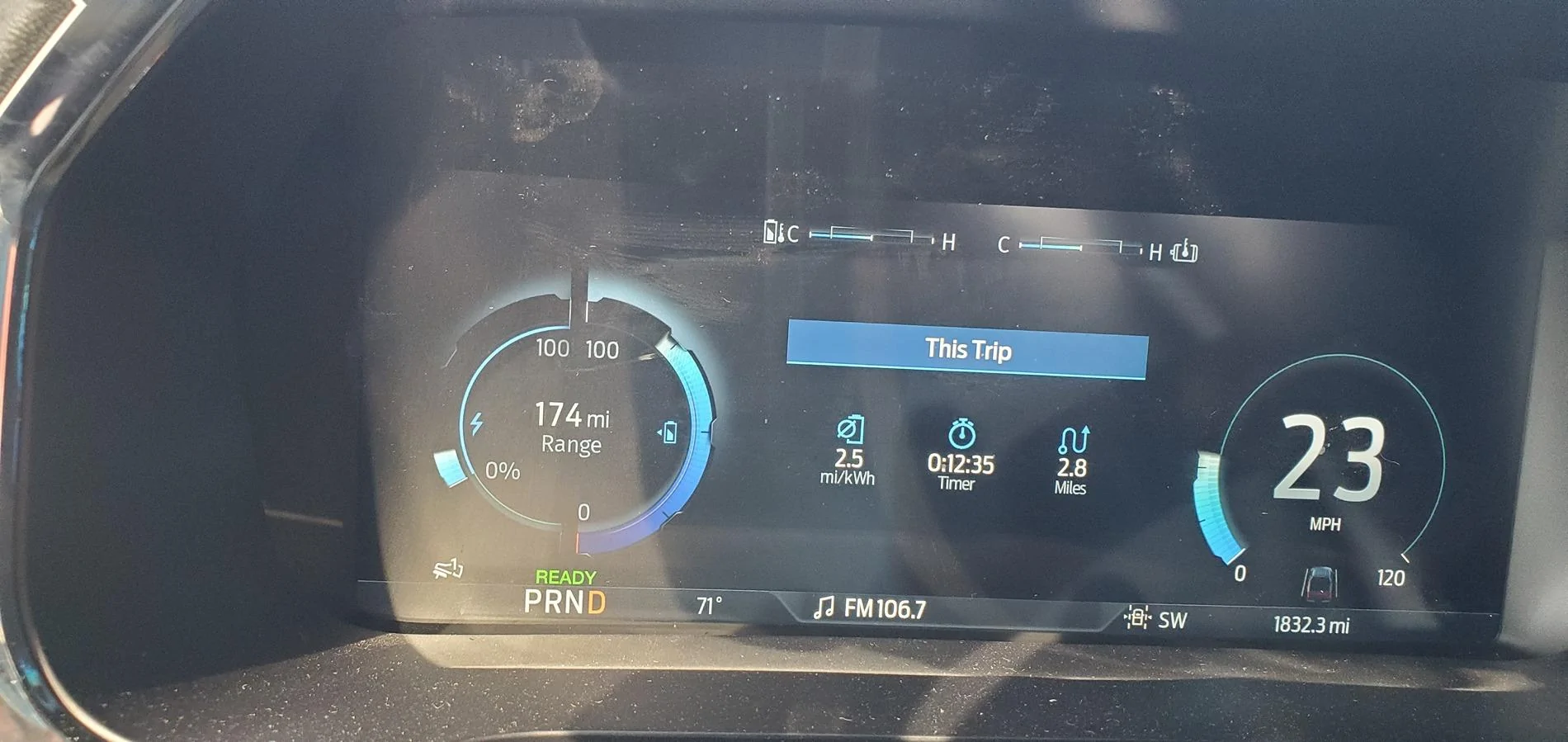

I noticed your display shows 67% battery capacity displayed on the gauge.
Not sure why mine doesn't display a number/ percentage. Just a clock face that I have to estimate. Is it a setting I'm missing or an upgrade. I've only had my lightning pro since 5/23/24 and am trying to learn it's features.
Attached is my display from today.
There are many of us that are waiting for this OTA update.
