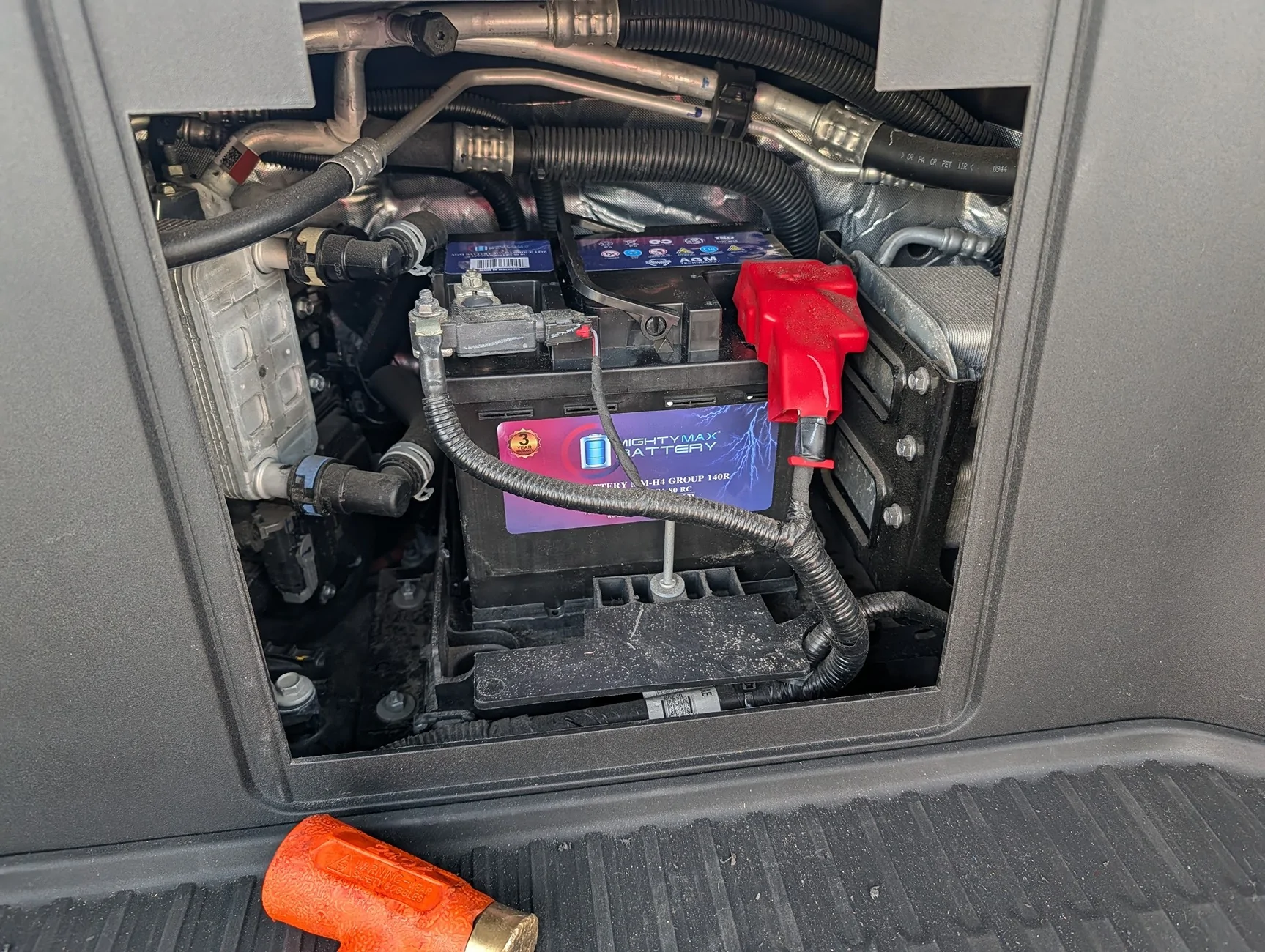

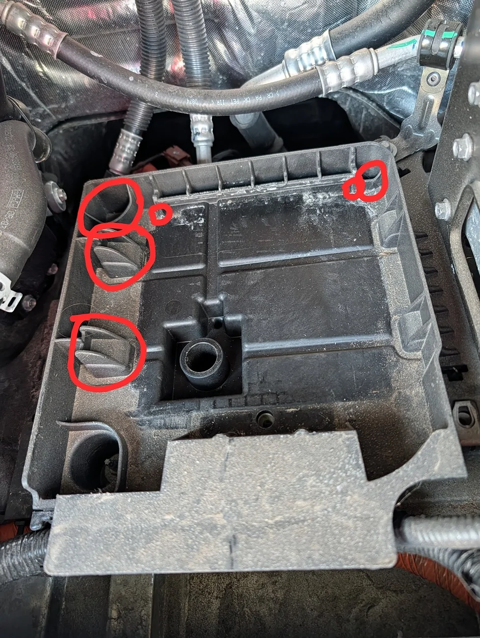

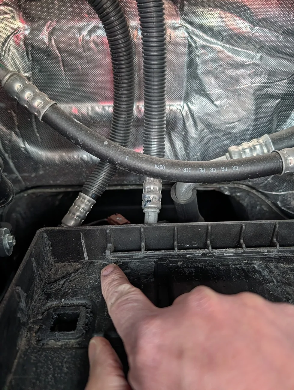

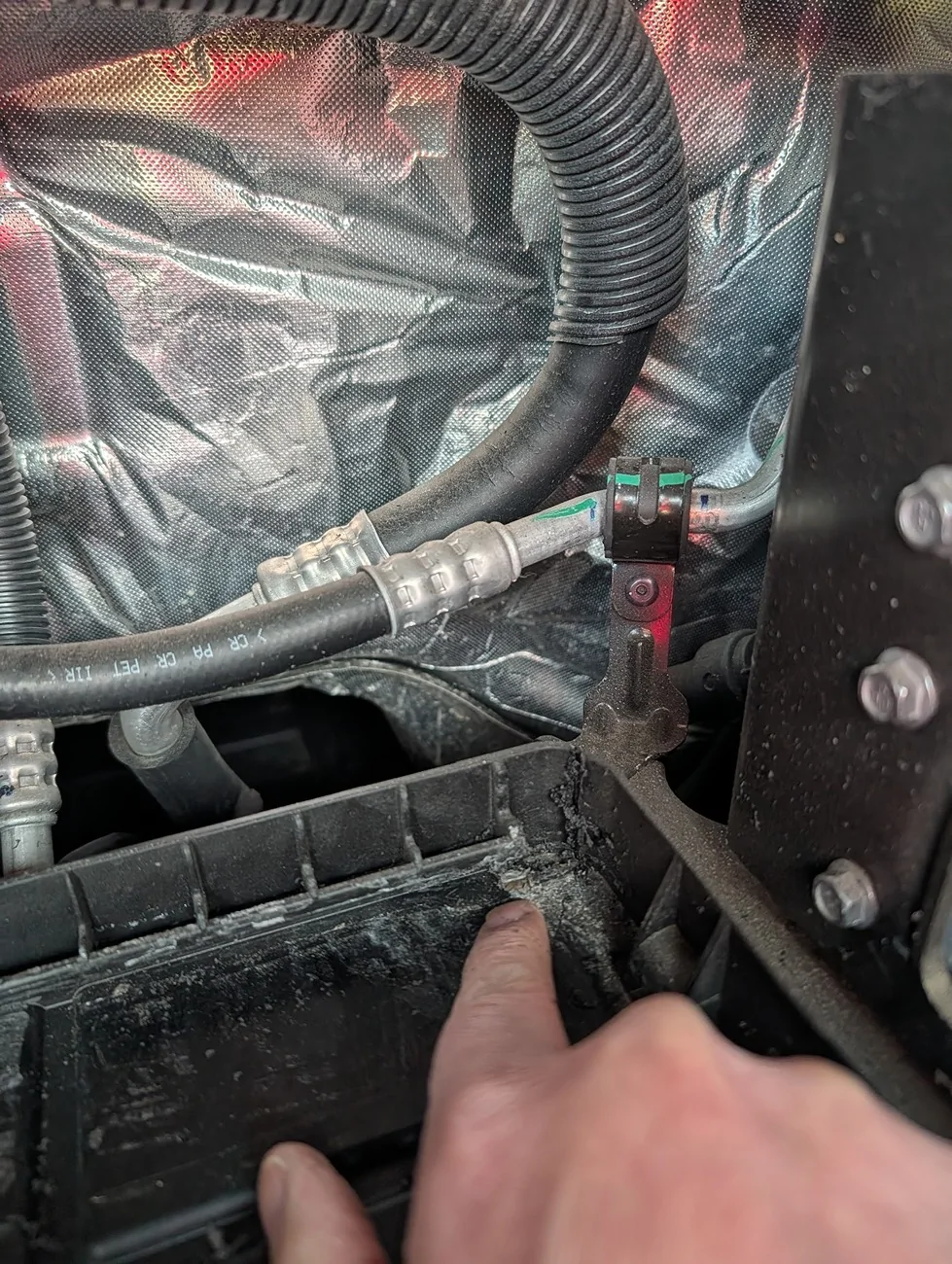

It would work, 100%. Mine is not the interstate as seen by my pics, but if it's an H4, with the tray modifications, any brand will fit/work.

I just did this with a Walmart Everstart H4 AGM. Rockauto was 180 with shipping for an H3 AGM, and Costco didn’t stock and couldn’t order any Interstate H3 AGMs or H4 AGMs. However it’s a simple upgrade with just an oscillating tool, and for $189 at Walmart with a 4 year warranty it’s hard to beat.

It's a good thing he used one of them extra strong H-V-A-C zipties, because I sure wouldn't have trusted a standard one.
Bit too much jerryrig for my taste.
