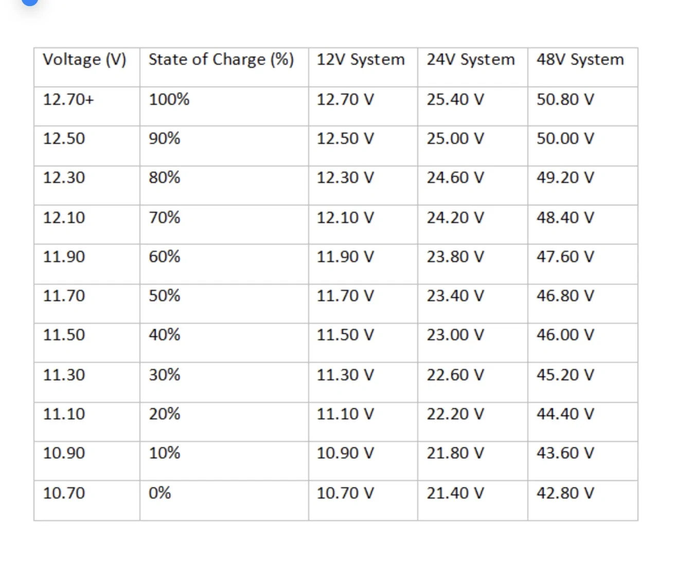

I’m not really an expert on this but I don’t really trust using the voltage to determine SOC. If you search around there are various sources and they don’t all agree but it looks like 12.47 is somewhere around 80-90% SOC. The other concern is that unless you disconnect the battery you don’t know if there is a load that might be dropping the voltage.
Here is one chart that I found.
This chart would be fairly accurate if the battery were disconnected. The battery voltage will read lower for a given SOC while it is powering up modules, which is always the case if the frunk is open.

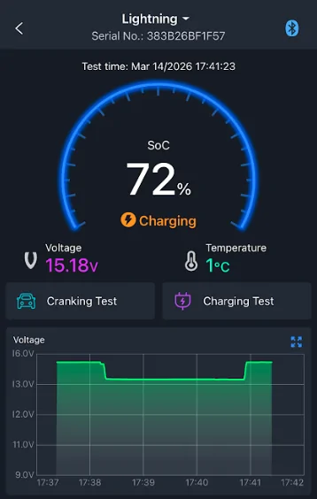

Last night, my charge cycle was 2 hours and it held ~15.28v for the full 2 hours. Last weekend, my charge cycle was 7 hours and it started around 15.25 v and ended at 14.99v. Driving today ranged from 15.21-15.23v (on/off for about 2 hours)
Figured I'd verify the voltage, so I started the truck and it read 15.18v on the monitor, but only 15.0-15.05v on the CarScanner. I figured, ok, makes sense because there is probably a minor loss through the wires to the module if they are carrying the current to run the module and my monitor is measuring on the posts. Got the multi-meter out and it matched the monitor (actually read about 0.02v higher than the monitor, which is close enough). SOC was 83% on the ODB reading when I did this.
Interesting dynamics while doing this. Sitting in the seat, the voltage was over 15v frunk open. When I went to the frunk, the voltage dropped to just over 13v. Thought that was weird, so I went back and sat in the seat - it jumped back to 15v. Definitely have some complex algorithms going on here...

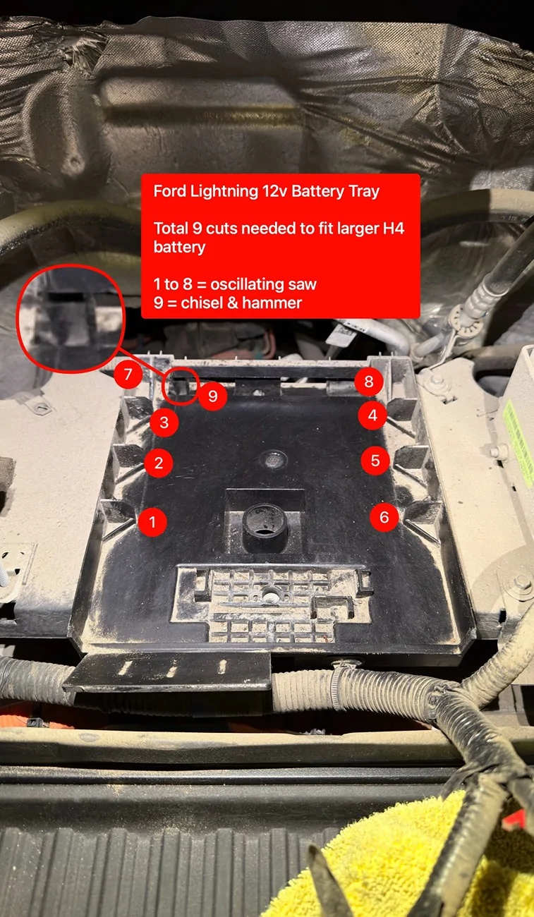

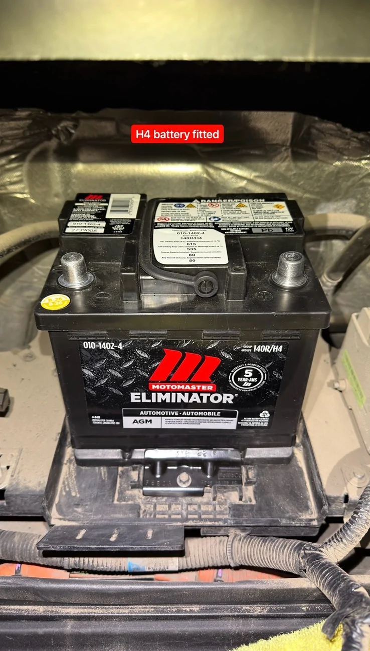

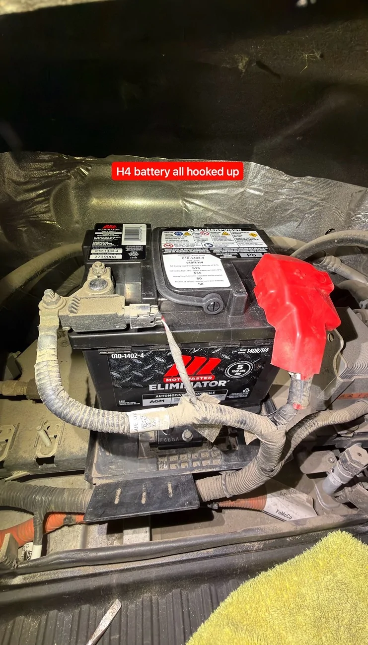

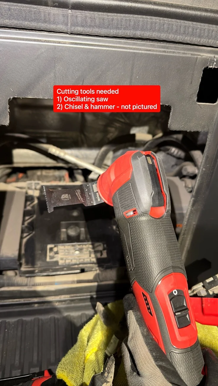

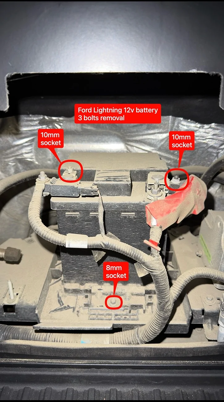

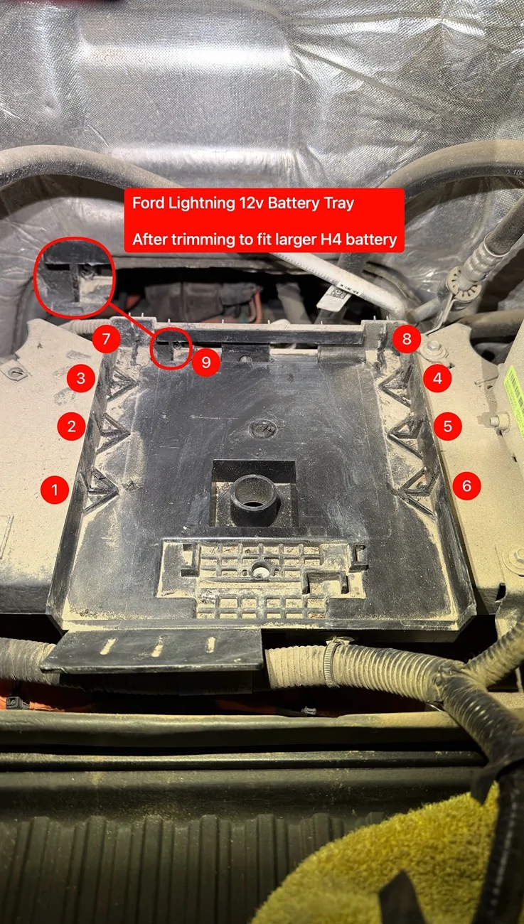

I actually just finished the same H4 upgrade tonight and took some reference photos. Since you’ve already posted a guide, I’ll just drop my pictures there instead of making a new thread.

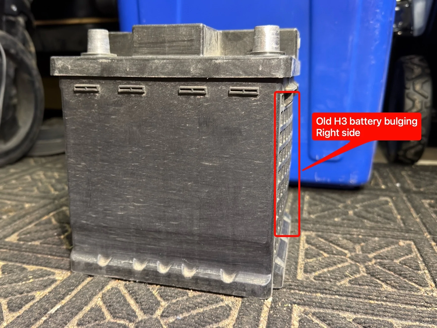

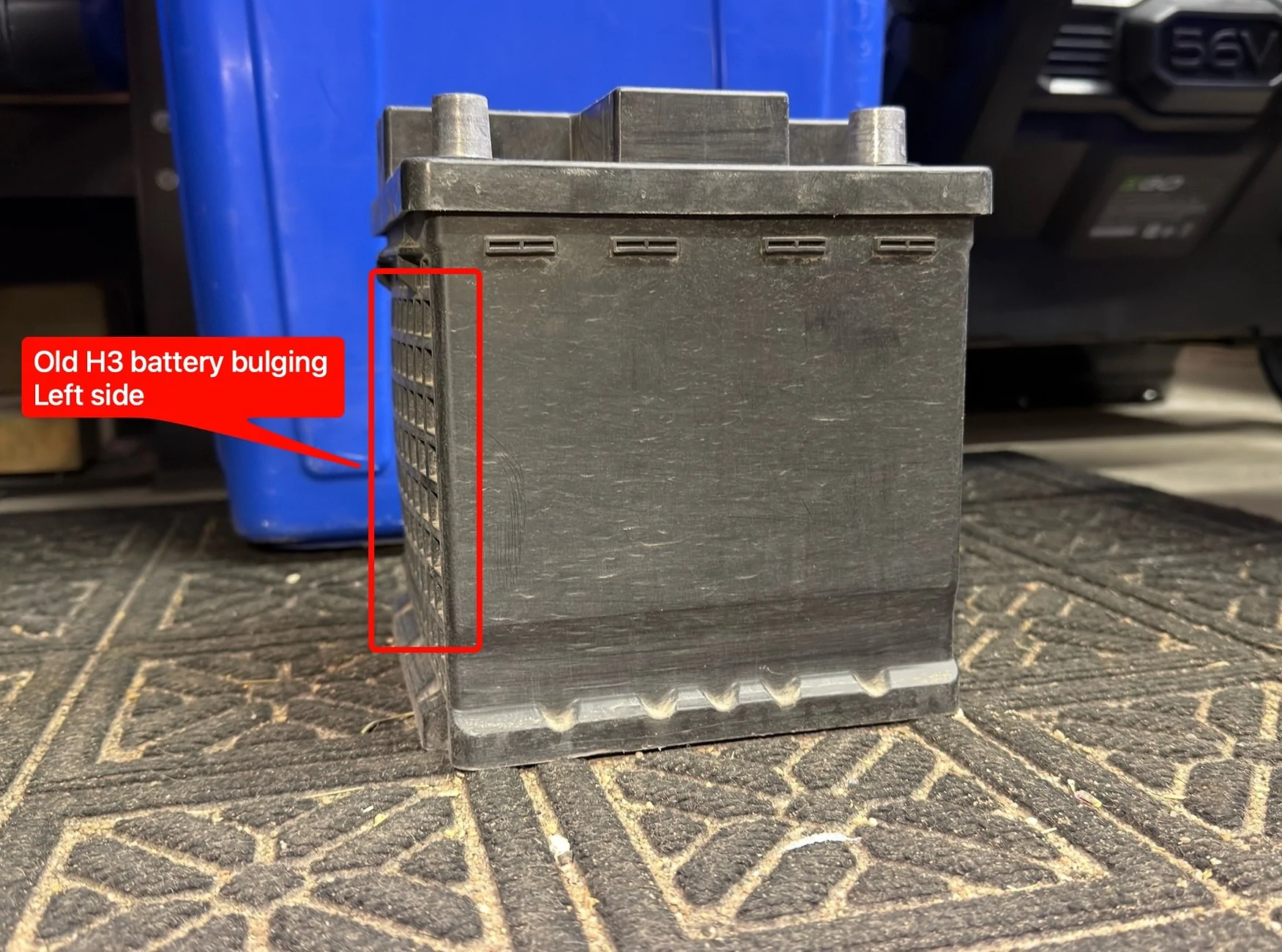

I understand that the cause of the Bulging battery is because of being Overcharged and to remedy this issue is to use a Trikle battery charger?
The plastic cases these batteries are built with will bulge slightly, it's normal, no need to do anything special or buy anything extra.

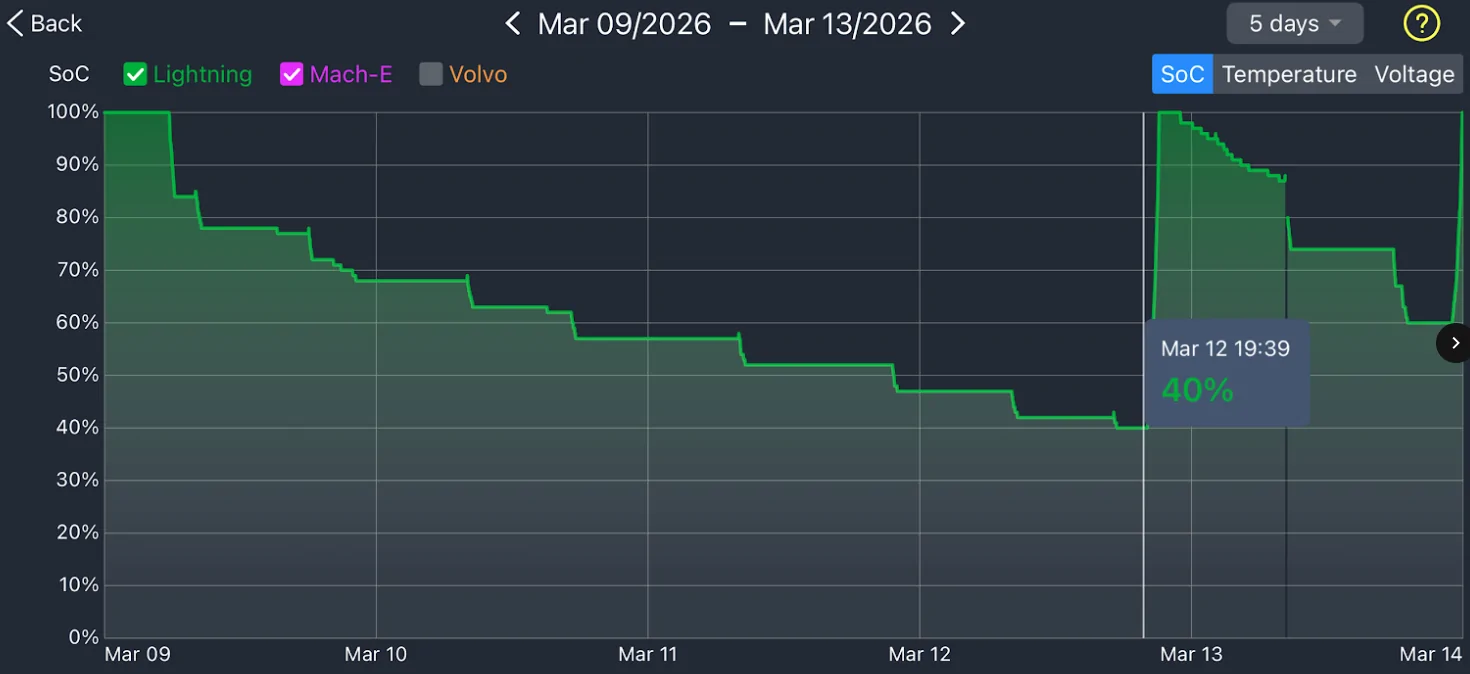

I figured I would post my H4 replacement results after the first week. I didn't need to drive this past week, but I have to do the driveway shuffle twice per day to let the wife in/out of the garage. We know this is particularly hard on the 12v because it lights up all of the modules for a while before putting them back to sleep without giving the 12v any significant charge time.
The H4 is much more tolerant of that abuse. Tracking the voltage for 4 days with no charge cycles, the H4 did exactly as it was supposed to do. The voltage dropped steadily through the 4 days and after the 8th driveway shuffle on the 4th day, the Lightning charged the H4 to 100% - no drama. My 2-year-old H3 would cycle after 24 hours and even when new, wouldn't make it more than a couple of days.
Ford F-150 Lightning 12V Battery replacement with H4 1773580993223-0
The monitor I'm using also calculates SOC, but it always under calculates the SOC value compared to the ODB2 SOC. It said 40% SOC when the truck started charging. In this case, because of the larger H4, there is no way to tell what the real SOC was on the H4 when the truck charged it. There is no way to tell what the BMS SOC was, since that requires you to be in the truck with the modules on. I estimate the ODB SOC to be around 50% when it triggered the charge cycle based on the knowledge that my monitor undercalculates by about that much.
Note the major SOC steps line up with my driveway shuffles. The steps are about -5% SOC for each driveway shuffle on the H4. On the 2-year-old H3, they were about -15% SOC.
So you're saying that a little bulge is OK, but a big bulge is creepy - I mean - bad ? :crackup:
I'll report back if anything goofy happens, but for now, I'm very happy with the swap, and I have a 5-year free replacement warranty.
Over time, going down to 50% or 40% before topping off will take its toll.
Going below 90% for 4 days is not a good thing for the battery.
One way to know for sure what the low SOC is would be to disconnect the battery and put it on a good quality battery tester.
The best thing for lead-acid batteries is to keep them at 100% as much as possible and us a low charging current when topping off.
That big jump from 50% or 40% to 100% indicates a large current spike. Also not good for lead-acid batteries.
