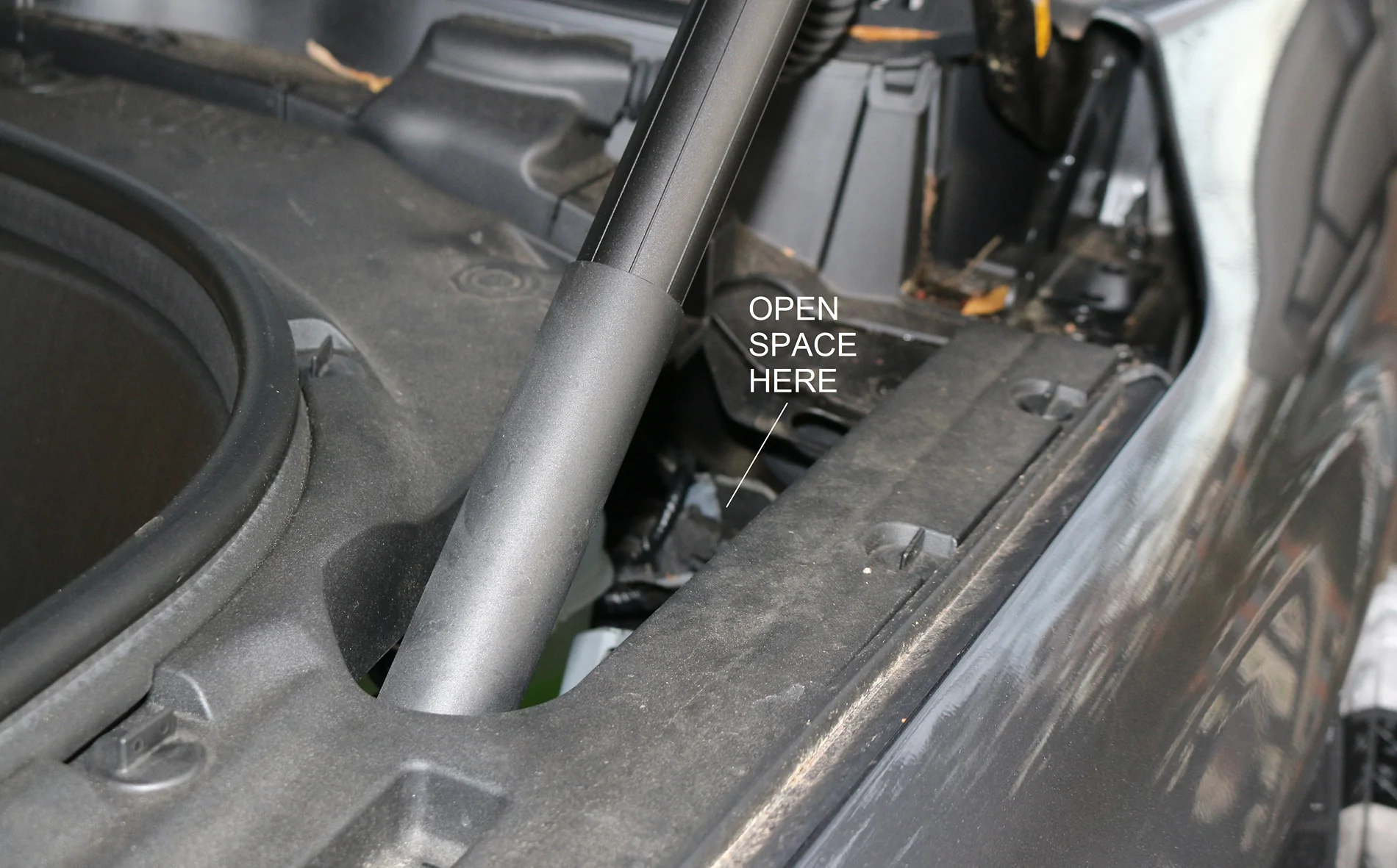

How did you route the cable? Did you remove frunk tub, or just remove cover on drivers side?
Sorry for the delay answering.
With the frunk open I could reach in through the space under the lift strut and reach the charge port area, grab the wire and then steer it so not moving parts will impact it in the direction of the battery area, then gave it a little toss. Opened the battery compartment cover and reach in over to the right until I found the wire.
Ford F-150 Lightning 12v battery replacement with LFP. IMG_6022-open space under frunk strut
If your hands or arm don't fit, you could take off the plastic cover like when to top off the coolant and that might help.
Thanks for the update. I found that you can remove the charge port cover but this seems easier.
