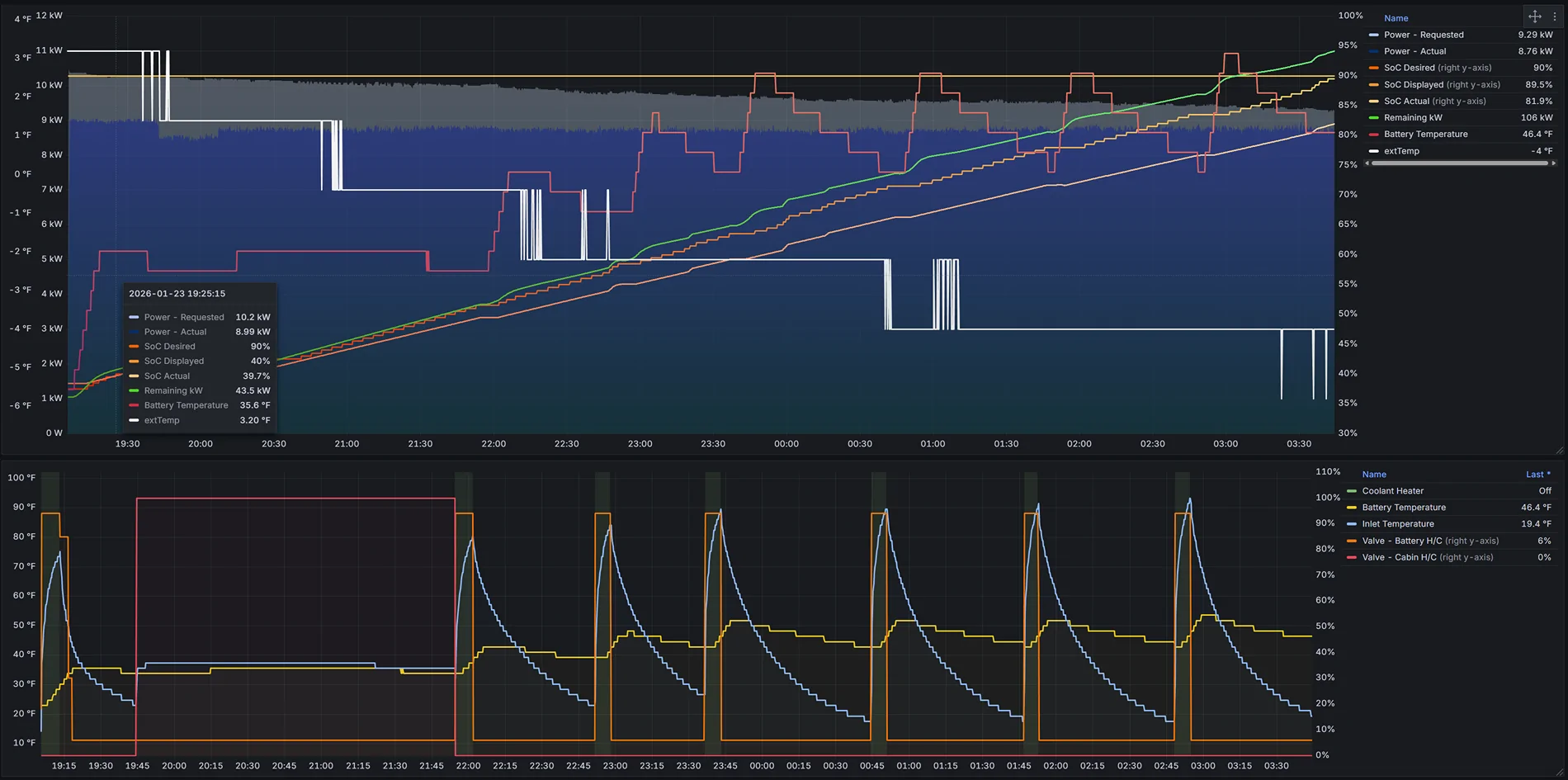

Have you ever compared the battery temp after charging vs. the ~59F after a departure time?
Mine ususally sits around mid 40F after a longer charge.

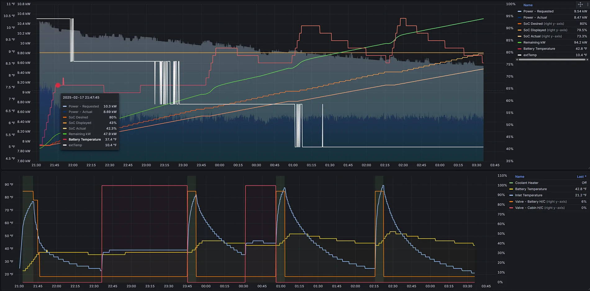

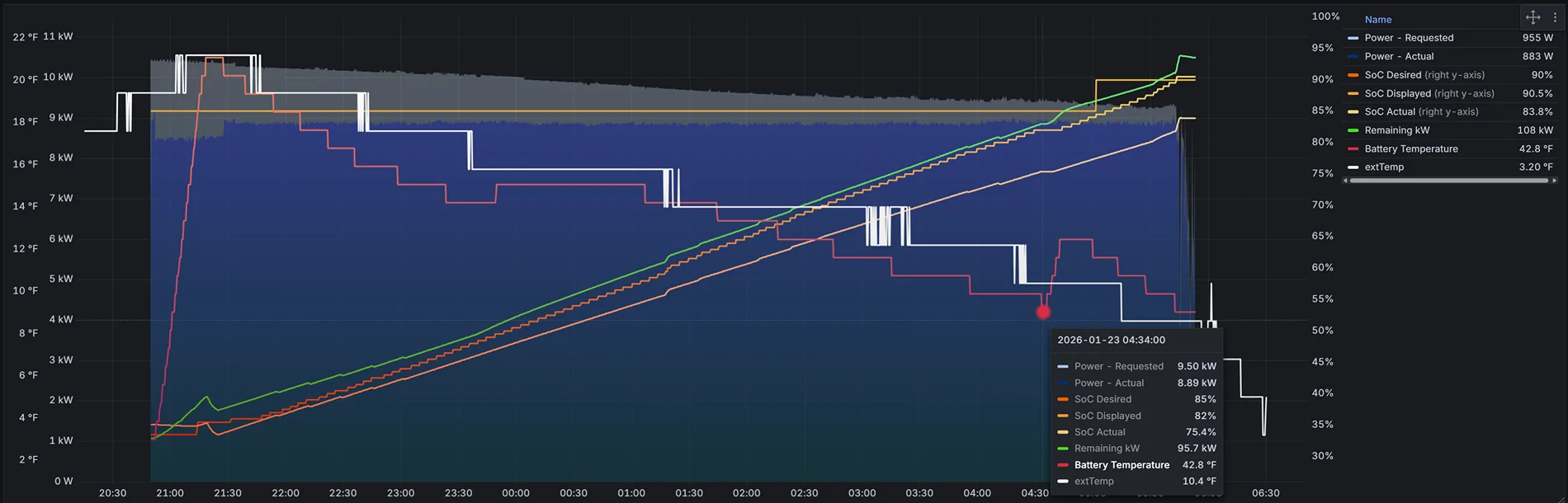

Here's a 40% >> 90% graph from last night, -4F outside with a battery temp of 46F when it was done charging.
4hrs later, when I went for a drive, the battery was down to 23F.
It would be great if departure time would [have the option to] control charging as well and if you then had the option of preconditioning the battery or not. The extra range you get from 46F to 68F would seem negligible in most cases.
The interesting thing in this graph is also that the initial heating is only to to get it over the freezing hump to 35F, then it lets it charge for 2hrs before kicking the heater on, waits another hour before kicking it on again and at this point enters a somewhat predictable pattern of letting it drop to around 42F before heating it up to 52F.
Not sure if they have different temperature thresholds for different SoC, maybe to prevent overcharging, or what's behind this type of behaviour.

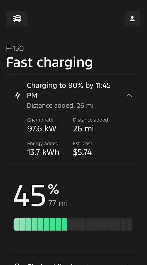

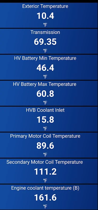

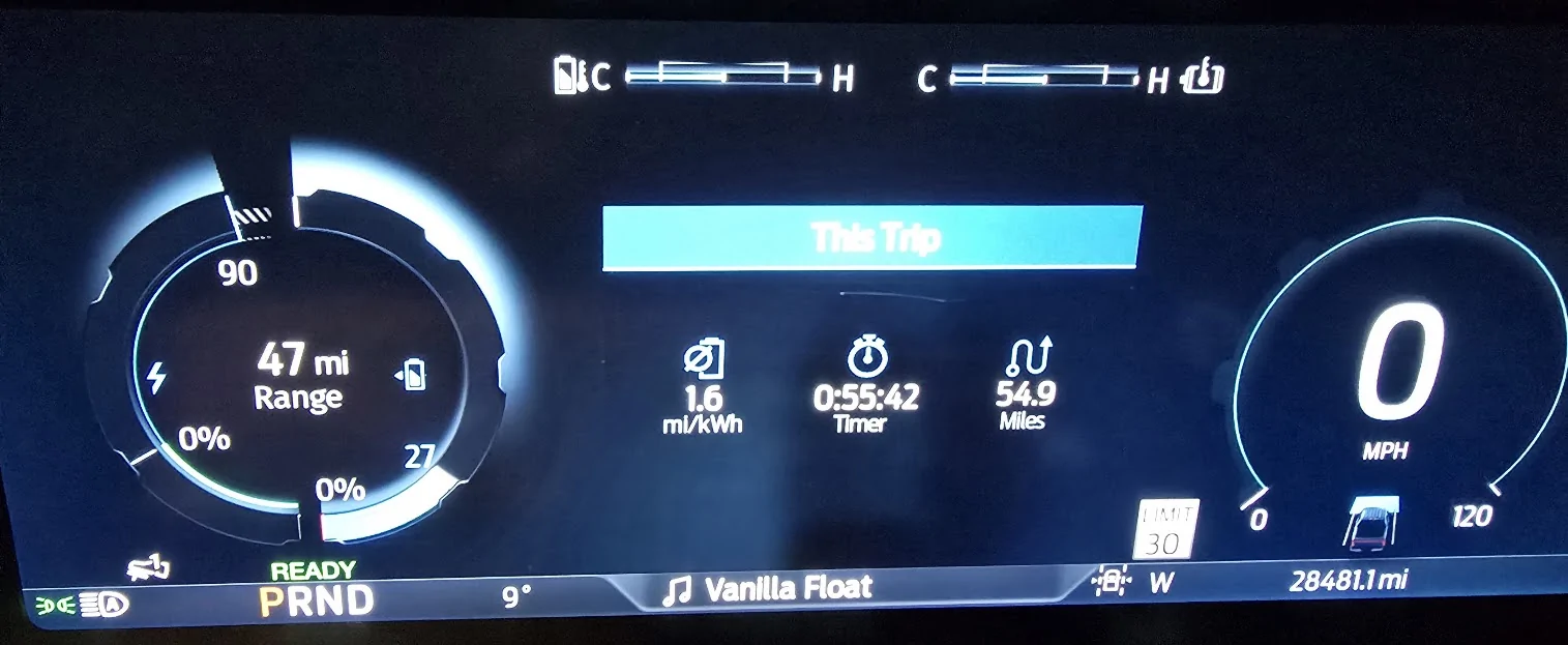

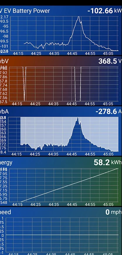

Here are the key points from last nights trip, battery was conditioned before I left in the 60's, the SOC got to 99% by the time I pulled the truck off the FCSP and the ABRP prediction for my trip.
Ford F-150 Lightning Battery warming when cold, and plugged into 240v 1769350383730-73
Ford F-150 Lightning Battery warming when cold, and plugged into 240v 1769350401875-wd
Ford F-150 Lightning Battery warming when cold, and plugged into 240v 1769350423642-1

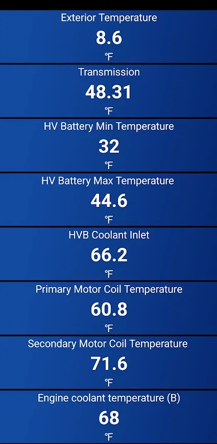

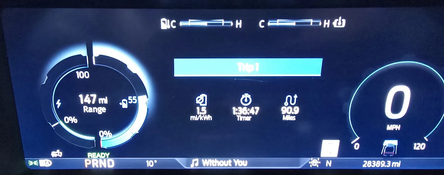

Arrived at the Nashua NH, battery conditions, arrived with 55% better than the predicted 48%, extra 13 miles for a quick side trip.
The HVB temp min dropped 14 degrees in 96 minutes, the motors got toasty warm, I'm sure the recirculation moved that heat to the battery to slow chilling (I hope that's what happened)
Ford F-150 Lightning Battery warming when cold, and plugged into 240v 1769350629303-6i
Ford F-150 Lightning Battery warming when cold, and plugged into 240v 1769350721534-

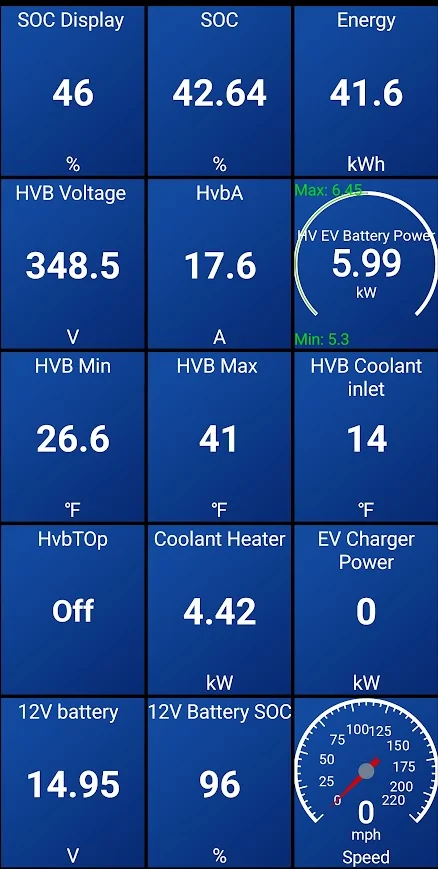

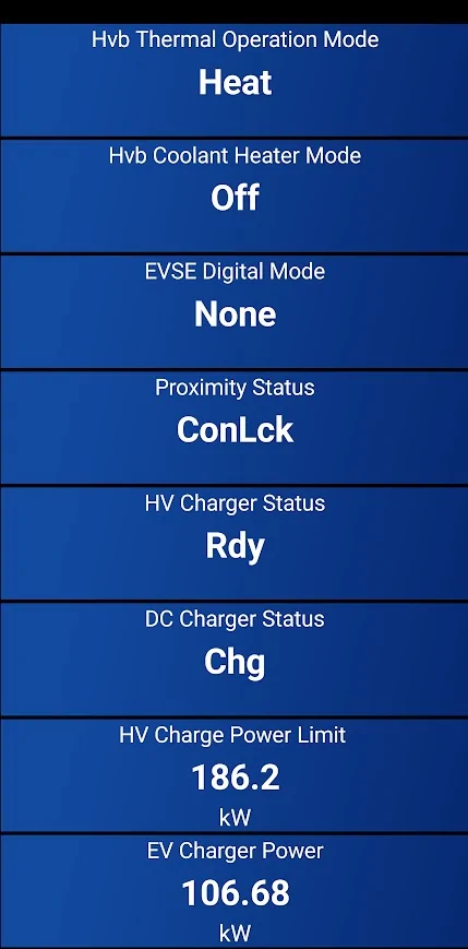

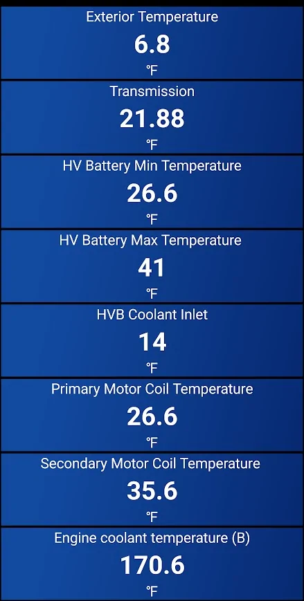

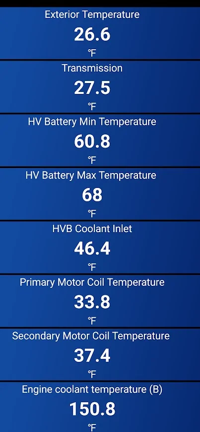

Second drive was a quick 18 mile between Nashua NH and Dracut Mass., the truck had been cooling for about 3+ hours, left the Nam Knights winter charity fundraiser, preparing for drive to Tesla in Woburn, MA.
HVB Min & Primary Motor T dropped to 26.6 degrees, secondary was a little warmer.
HVB Thermal Operations was still OFF after programming the Tesla Charging station into Google Maps, it also was OFF using Ford Nav pointing to the Tesla station by address (No pick option shows in the Charging stations options list) we need that update @Ford Motor Company
Ford F-150 Lightning Battery warming when cold, and plugged into 240v 1769351189159-dt
Ford F-150 Lightning Battery warming when cold, and plugged into 240v 1769351377490-0r
Ford F-150 Lightning Battery warming when cold, and plugged into 240v 1769351526912-ih

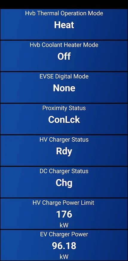

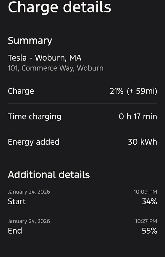

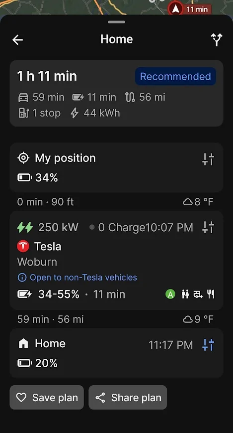

Arrived at Tesla Charger, though the PTC didn't actively warm the battery, the thermal management system did transfer heat from the motors/transmission (DC/AC 3-phase drive inverter??) HVB Min T rose ~6 degrees.

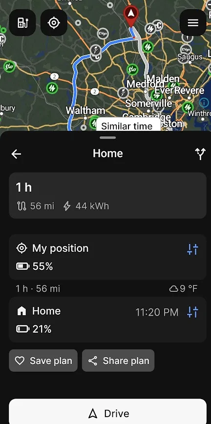

I looked at ABRP again, revised energy plan to get home, 34% arrival SOC at Tesla and 20% ending SOC at home, the algorithm predicted I should charge to 55%, so I set the one time charging limit accordingly.
Ford F-150 Lightning Battery warming when cold, and plugged into 240v 1769351641385-ok
Ford F-150 Lightning Battery warming when cold, and plugged into 240v 1769351604778-99

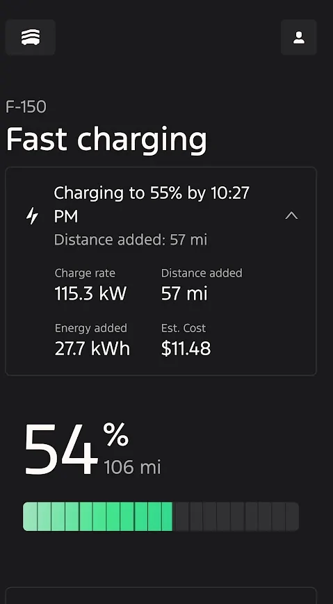

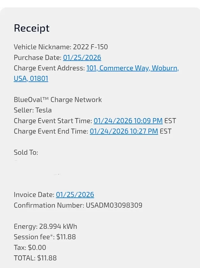

The site had almost all stations occupied with Tesla's to the left and to the farthest right was a Caddy Lyriq on the furthest right point of the last station. The Tesla next over pulled out within 5 minutes opening up the option for me to score the next right most station, minimizing losses of productive spots. I pulled up close, using the second NACS adapter (other design that is longer) which @Ford Motor Company sent me after the big roll out was finished.
The energy flow might have been impacted due to the high utilization at this facility or maybe my battery temperatures?? The first chart showed 86KW, then the second after a few minutes 95.79KW, the last chart shows Hvb thermal operation mode in HEAT while the Hvb Coolant Heater Mode is OFF, wondering if that is true or flawed data, because the PTC was pulling energy to warm me in the cabin and I'll assume the HVB as well !?!
Ford F-150 Lightning Battery warming when cold, and plugged into 240v 1769352399851-dj
Ford F-150 Lightning Battery warming when cold, and plugged into 240v 1769352384250-v5
Ford F-150 Lightning Battery warming when cold, and plugged into 240v 1769352475650-p8
Progression of the charging: Revised the ABRP prediction for the final leg home, say's I'll get there with 21% remaining, the mid trip session cost $11.88 for 29 kWh at $0.41/kWh Mass sales tax of 6.25% included.

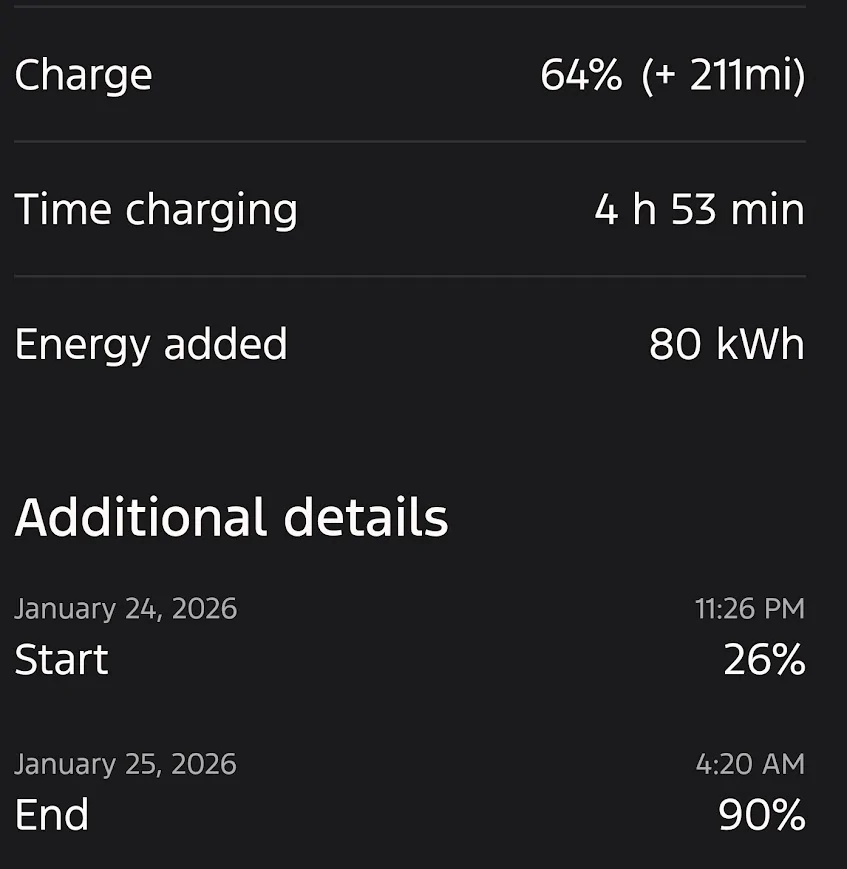

Plugged into the 80 amp FCSP, bringing the HVB back to 90% in preparation for the blizzard.

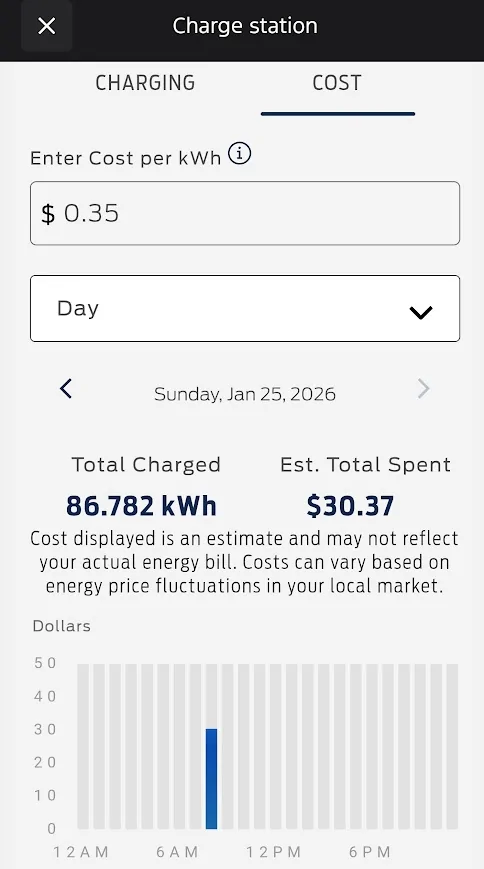

EDIT to add my monthly energy chart for January, closing the book today on that:
28.6 cents a mile for this trip including the 10% initial bump starting the trip not shown in the charging data / cost snapshots above,.

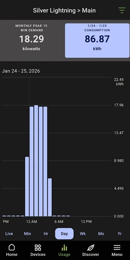

This morning my truck did 9 minutes of spontaneous conditioning, only took 0.888 kWh.
The prior afternoon charging session was about 21 kWh, and that included a warming phase, the residual heat bleed out overnight, necessitating additional warming this morning.
I'm doing a 15 minute remote start right now.
