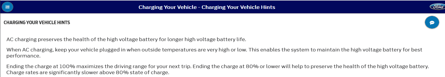

I have had my lighting now for about 3 weeks and love it. But was also struggling to see what the recommended AC charging limits are. The MachE manual was a little more specific with a 90% daily charge limit recommendation if I recall.
The only thing I could find in the Lightning manual was below that said charging to less than 80% will help preserve the battery...which is also the general wisdom you see from the EV expert folks on forums and YouTube.
That refers to DC fast charging.
