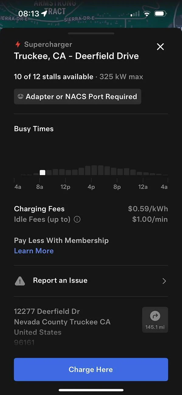

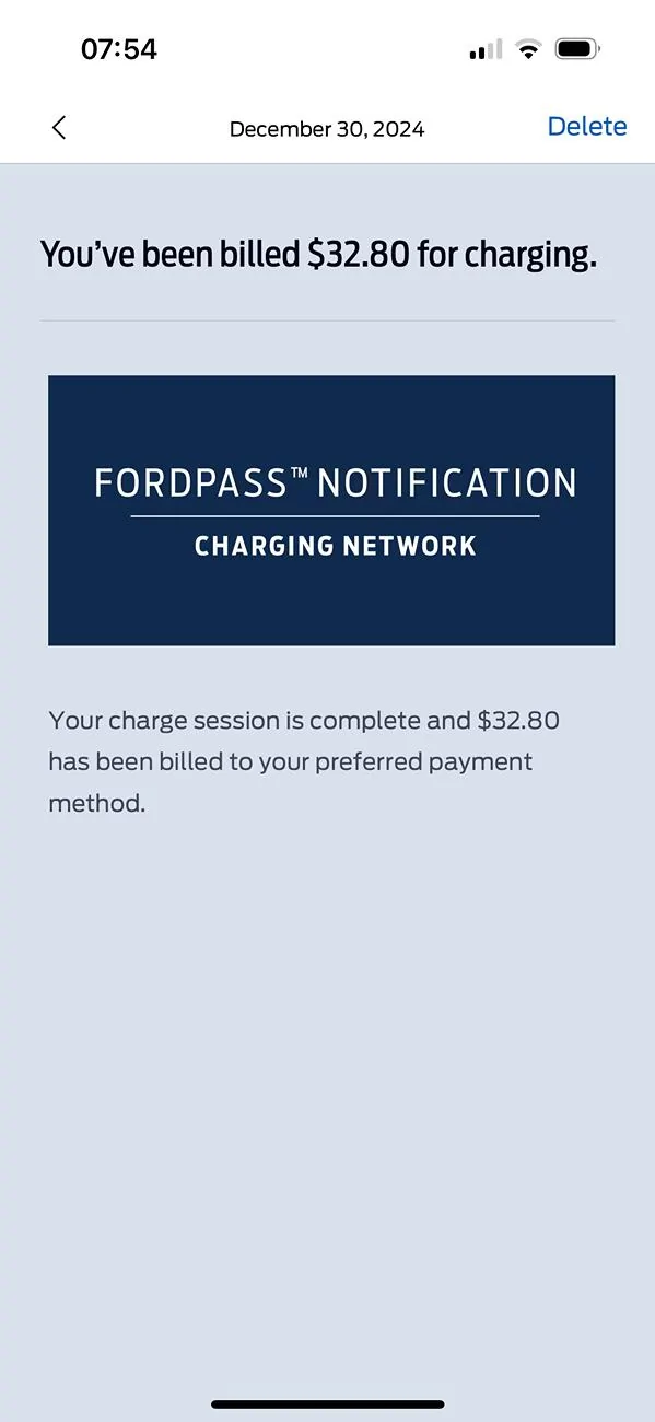

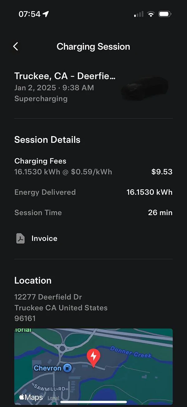

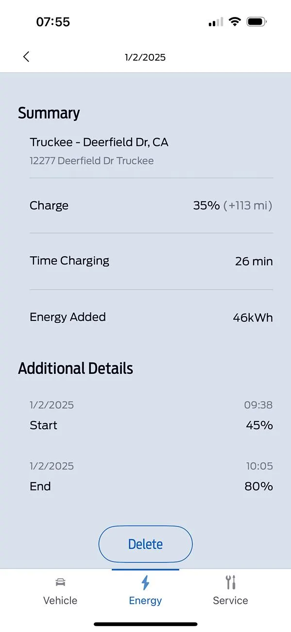

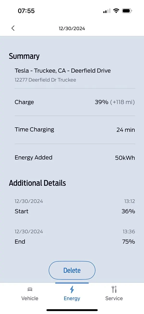

I have a cost question. I charged twice at the same supercharger location at roughly the same time and for roughly the same amount. One time it went through the ford app and once through the Tesla app. See screen shots
1) it seems from what I read that charging on the ford app is more expensive, but $20 more seems a bit much. Can I find an actual invoice like is shown on the Tesla app? So I know what I was actually charged per kw/h
2) how do I know when I’m using the ford app vs the charger company app? Meaning, one time it just charged through ford without me selecting any thing and the other time I had to do it through the Tesla app

From those numbers charging in the Tesla app was the marked $.59 per kwh. Running the math and $32 for the 50kw charge would be $.65 per kwh, not unreasonable.

Well the screenshot using the Tesla app you only used 16kwh and the screenshots from the ford app are 46kwh and 50kwh so yeah I would expect a difference!

No im not. Why is the ford app showing that I took in 46 kWh but the Tesla app showing 16?

The Tesla app has it's own integrated tracking history with details if you activate the terminal with the Tesla app and pay directly to tesla.
Don't confuse the FordPass charging history records, the KWH values are net to the traction battery, they don't always line up precisely with what is invoiced by Tesla & Fordpass BOCN

Did you have multiple activations on that visit, that day? Distinct records of 2 or more?

Weird. The Ford screen shows 46 kwh added, yet the Tesla app only shows 16.15 kwh billed. Looking at the date and time on each app, they are the same?
