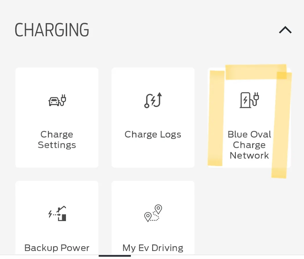

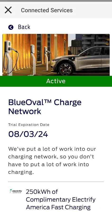

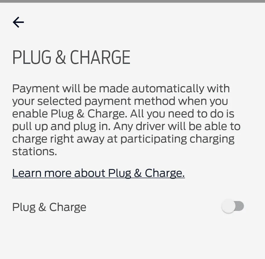

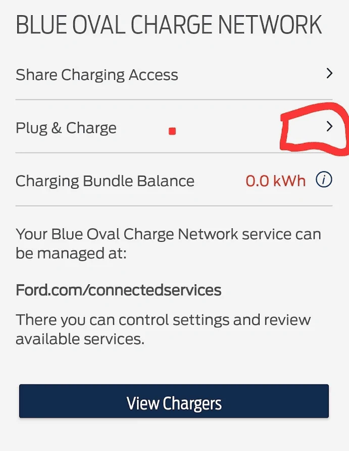

After your done burning through the free credits, you need to have a method of payment set up in connected services, blue oval charge network, leave this setup and standing buy, note pulling up the details of connected service is slow.....
Ford F-150 Lightning Blue Oval Network specifics 1673624718070
Once that is operational, a few minutes to a day delay until they confirm method of payment is valid, then you will be able to toggle the P&C switch, I generally keep it off when I'm using my EA members account to get discounted 24c/min rate vs public 32c/min (which Blue Oval will charge you)
On the rare occasion I use another in network provider for whom I do not have a members account ie. ChargePoint, then I come here and switch it on, so the session is automatically billed to my on record CC.
Note that system response is SLOW getting into Blue Oval Charge Network

This is what I plan to do. So, how well does EA work without it enabled? Do you have to activate the charger via app and then plug in?
My memory is foggy from last August, but it was streamlined literally just plug in the truck, the EA system recognized the trucks VIN as a complementary account and the credits were consumed, I burned mine up during a couple days worth of trailer towing tests.
And now with the switch mostly off, yes I enable the charging terminal on the EA app first, then immediate plug in, note my last experience was glitchy because EA servers or the terminal was not communicating well, so I pull up to another stall which worked perfectly.
