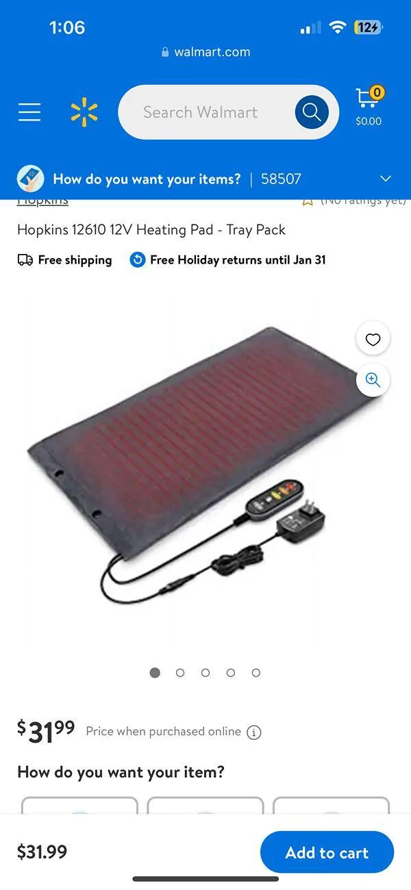

RVers use these to keep their liquid tanks from freezing up in subzero temperatures all the time. How easy would it be to slap a few of these on the battery pack and just plug it in like a block heater and how effective might that be? ?
this whole preconditioning thing in my climate is just not feasible you can only program in two departure times a day and I’m never driving more than a mile so I don’t need it fully warmed up for Max range but having a stone cold battery can’t be great for it either. I would rather just maintain a sub optimal, but not freezing temp.

Bad idea to do that.
It is FINE driving a cold battery. If the battery needs to warm itself, it will tell you. And, even then, it still runs.
These vehicles were tested in outrageously cold places. Norway is the country with the highest per capita EVs. Relax, stop worrying about it.

Just what Rick said. Differential heating of the cells within the pack with such a pad is not good. The cells are not harmed by the low temperature, they just will provide less power, less range.

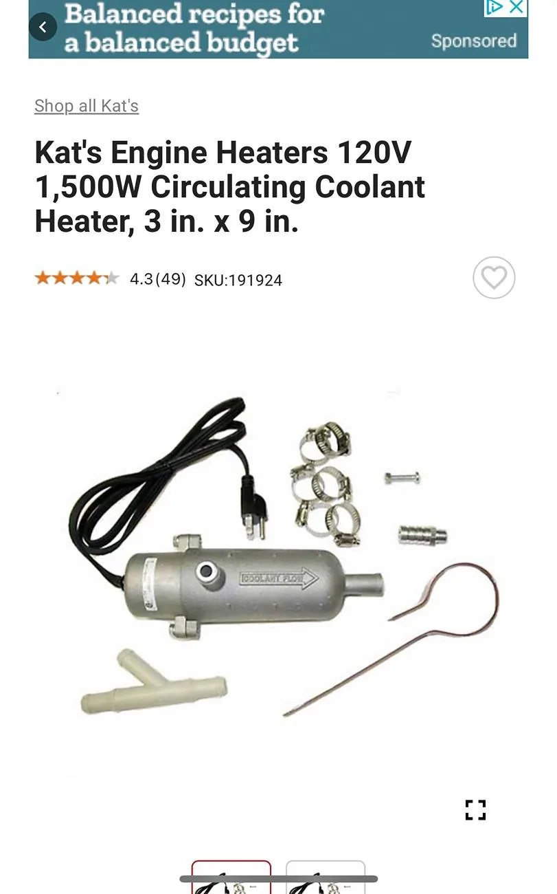

Fair enough, I just saw the guy who went though the trouble of plumbing in a diesel heater, got me thinking about these and also this in-line heater for coolant system systems. These rely on just heat rising and cool sinking to circulate and are actually really effective around here. I imagine with the pump system these trucks have probably wouldn’t work.
or this

As long as you're plugged into 220v the truck does this automatically.
Preconditioning then brings it up higher to the "ideal" temp for range.

Don't add anything. The truck is designed to be used in cold weather. Keep it plugged in to 240v and set a departure time. Use heated seats and set HVAC on Auto, 1 speed, and as low a temp as you are comfortable with.

Inconsistent heating/cooling is your biggest problem when trying to help out the truck maintain battery temp. Ford is well aware of operating temperatures around the US. I'm mildly concerned about the extreme heat here ruining the battery. Especially after our resident (recently retired) expert shared info about the cells degrading more rapidly in temps that I see every summer. But I trust the truck to take care of itself. Two summers down and everything looks good here.

I mean, if you have power available why not just leave the truck "running" and plugged in? You have a huge heater already fully integrated into the system. If you can find power for heating pads then you can find power for the truck itself.
