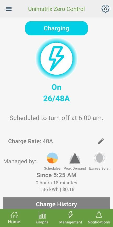

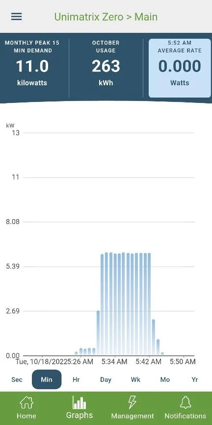

So 48a charging is what it needs to precondition without using any battery?
This is what my Emporia recorded for a preconditioning session. Departure time was 5:45 AM.

Well, his and my data is different. I didn't crunch the numbers. I was just posting what I've observed. I think his truck is in an unattached garage, mine is attached and stays warmer. My experience used less energy but it does show that it only used 26 of 48 available volts for the preconditioning cycle. That should be the target setting of people that want to maintain a minimum voltage setting, but also want to precondition.
I will say this, I'm glad I sprung for an Emporia energy management system for my FCSP. The data Ford gives you is very inadequate.
