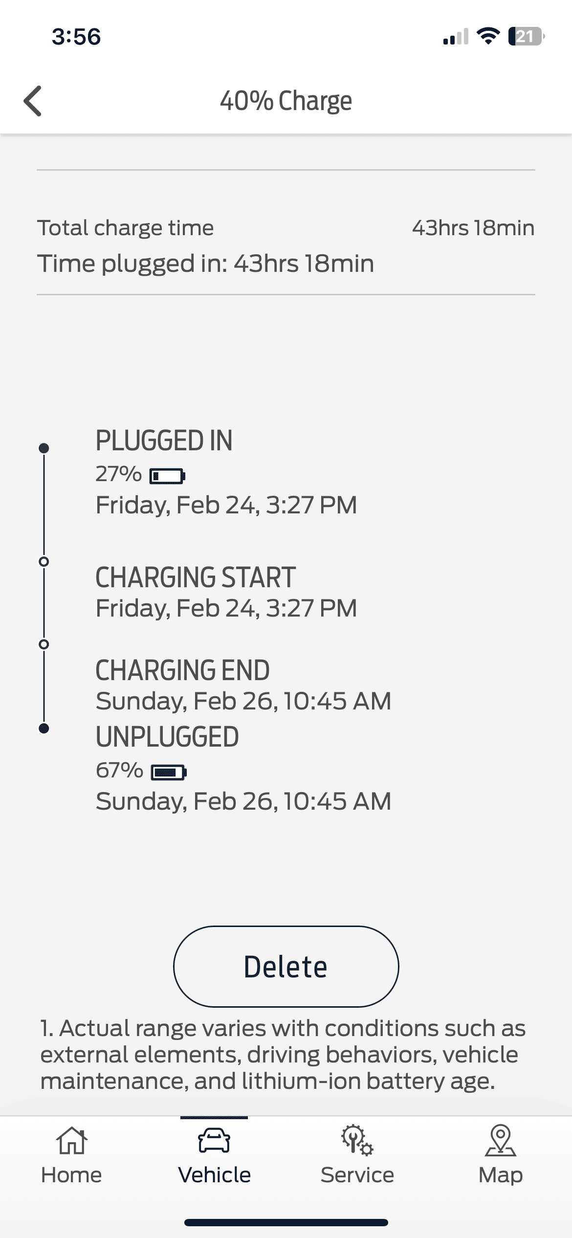

I was in a remote location this weekend and hooked up my Mobile power cord to a 40a 220vac circuit that I have used before. I was plugged in for 43hours and 18 min and came back to 67% charge. I could not see any issue with the power, or the cable or the connection. When I charge here its usually from about 60 miles of range remaining. Does anyone know if there is a way to get more details from the charge log about why it did not charge fully? The location is set to charge to 100% and has before.

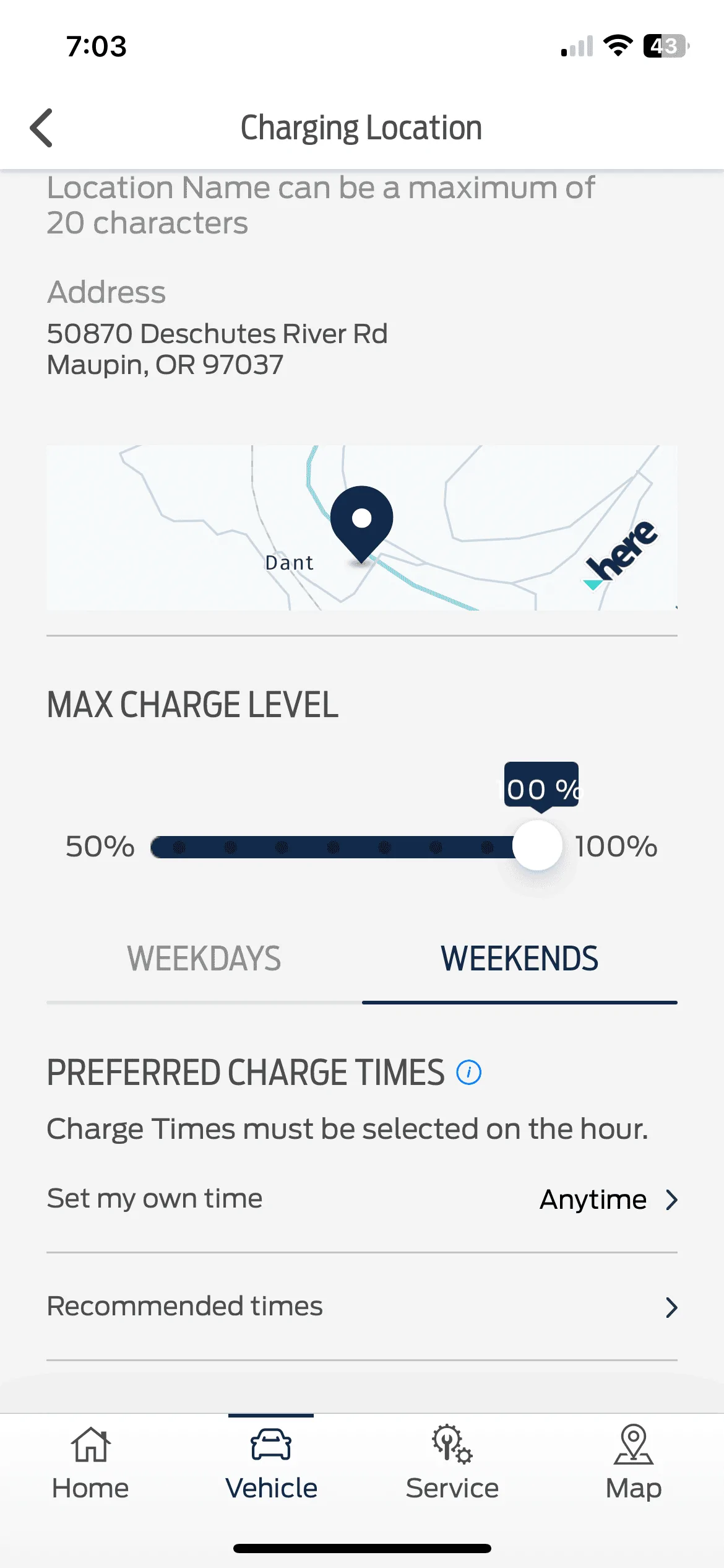

Here is the Ford pass entry. It was plugged in for43 hours. I was at 27% or under 50 miles when I plugged in. It was cold the first night at 18 deg. I have charged here before and I had told the truck to charge to 100%. I have a location set and that also says to charge to 100%. No cell service so the fordpass has some trouble but it’s worked before.

40% charge in 43 hours almost sounds like you were charging with 110V. Are you sure both legs were hot on the receptacle?

Just spitballing here because it really does seem like you charged using one leg @ about 52 kWh in 43.3 hr, a 1.2 kW consumption before losses.

It looks like you're only charging at a 110/120v rate given the stat's posted.
Double check the output at the 220/240 plug across the legs and to ground/neutral.
