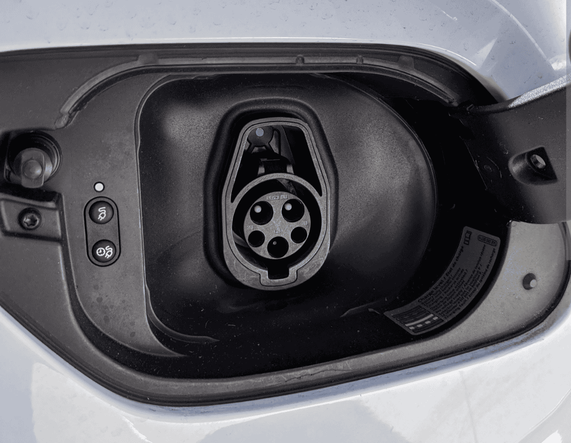

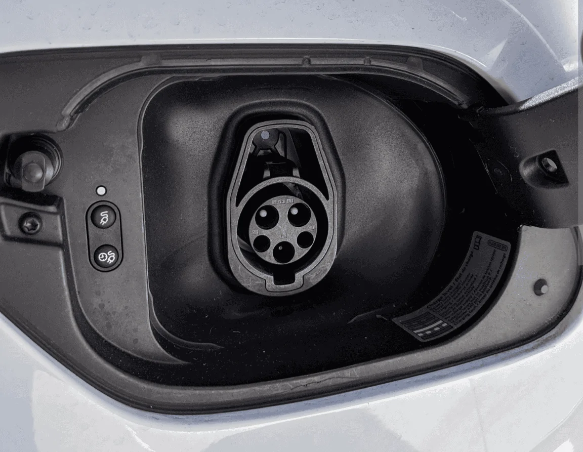

My e-Golf had hard buttons next to the charge port to force delayed charging or immediate charging and they were instrumental in taking advantage of opportunistic charging while keeping those TOU schedules in.
Every other EV I've owned since has been disappointing in that regard. If Ford can enable that functionality with a specific sequence of pressing of the lock release button that would be amazing.
