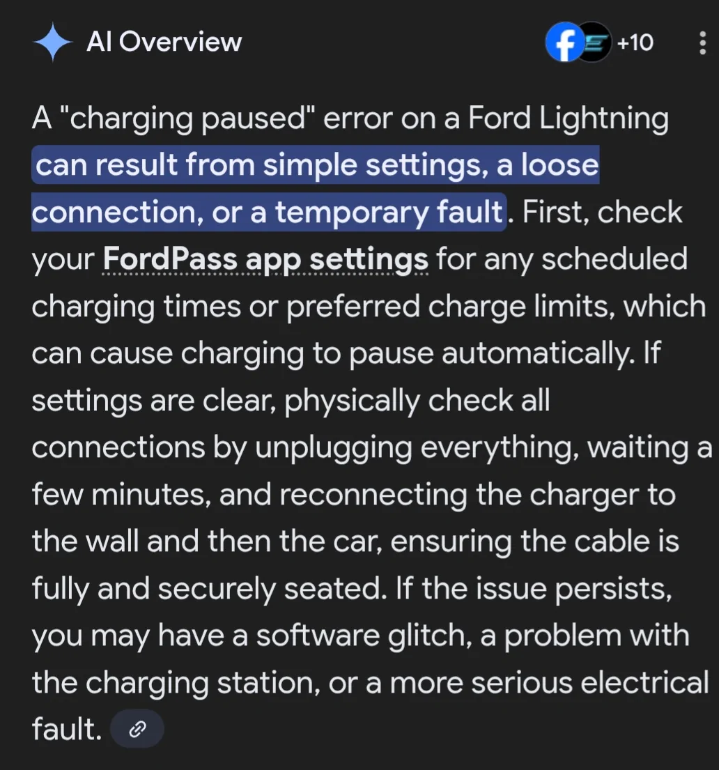

I had a similar problem, once. I had to reset my charge times in the app.
Ford F-150 Lightning Charge Settings Defaulting to Zero. I can only charge at home Screenshot_20251030_112139_Googl
