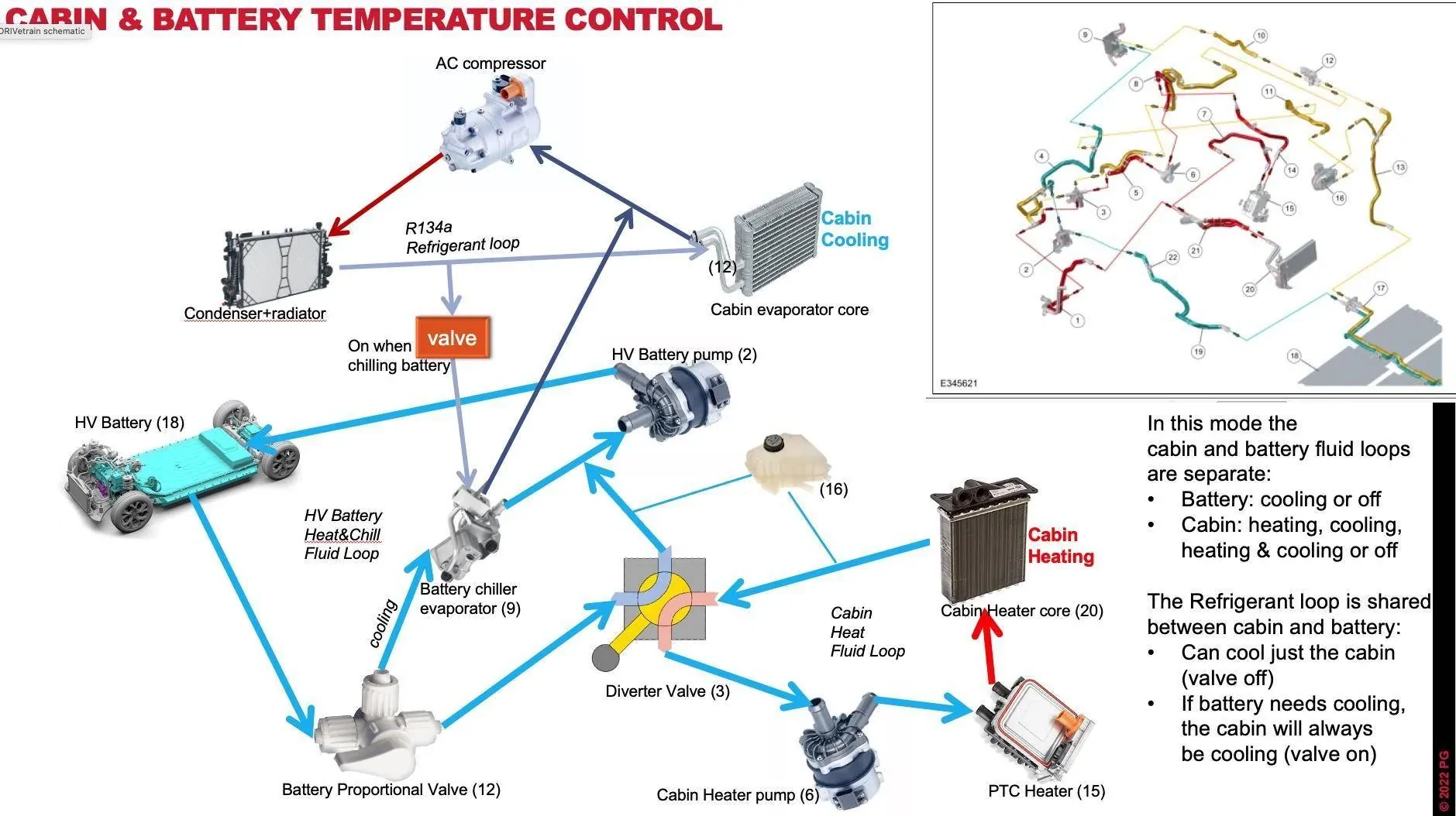

It's also a bit strange that it keep both diverter valves closed after the pack has reached 55F, while still keeping the heater/PTC on, guess I have to look at some flow/service diagram to figure out what's going on.
If you find it, please post the image!!!
This is the Mach-E system that I speculate is similar to the Lightning system, sans dual chiller (MAX TOW OPTION)
