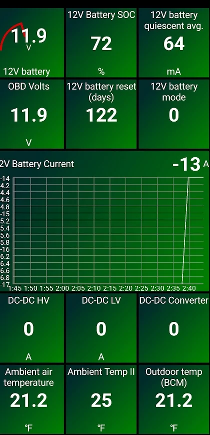

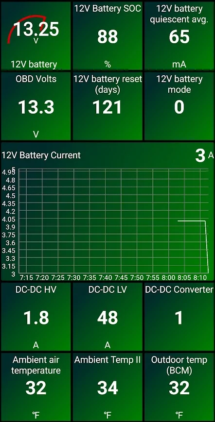

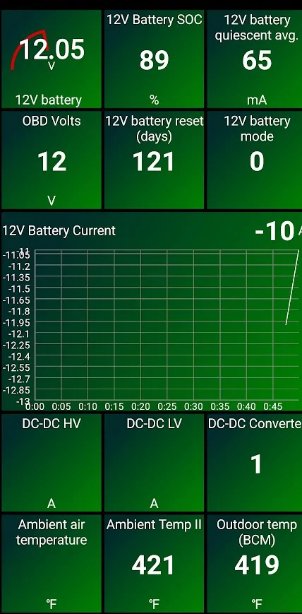

This morning at ~07:30 am, just before departure time start began, about 36 hours of cold soak.
The LVB SOC dropped 10%, 10 amps outflow for lights and running modules, the ambient and outdoors temps is a data error which will correct with another unlock command.

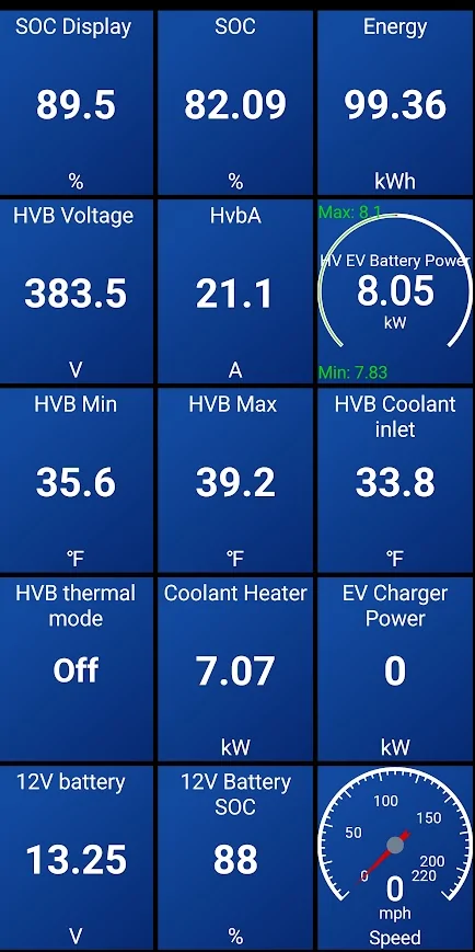

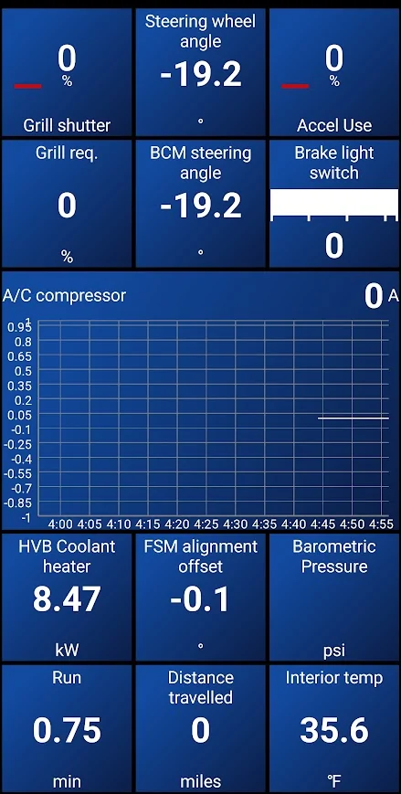

The truck started warming up around 07:33 am, the PTC (coolant heater) is drawing 8.47 KW, interior temp is 35.6°, most traction temperatures are still chilly, note that I'm unplugged so we should not see the HVB temps go up. The LVB is recharging at 13.25v

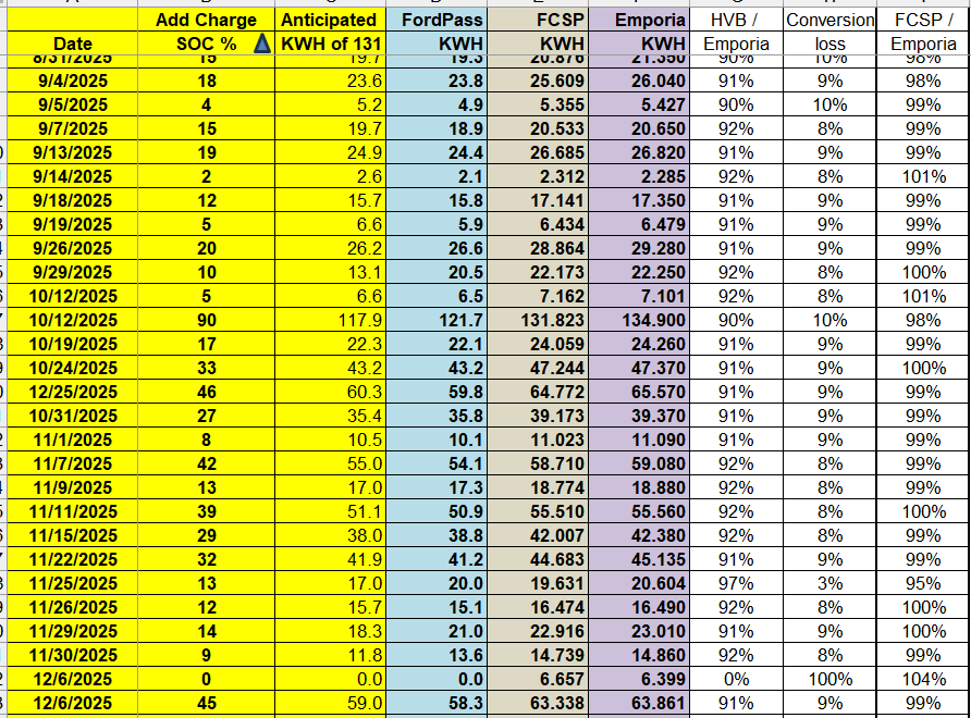

Interesting the discrepancy between the FCSP log and Emporia. I think it shows that Emporia isn't exactly accurate, measuring with the clip on connectors.
69.995/70.27 = .996
This sample was out of the norm, usually the Emporia measures a few more watts than the FCSP.
Here is a list of recent charging sessions showing the random variation.
The 12/06 entries are the departure timed warming of the battery and cabin first then the end of week charging session.

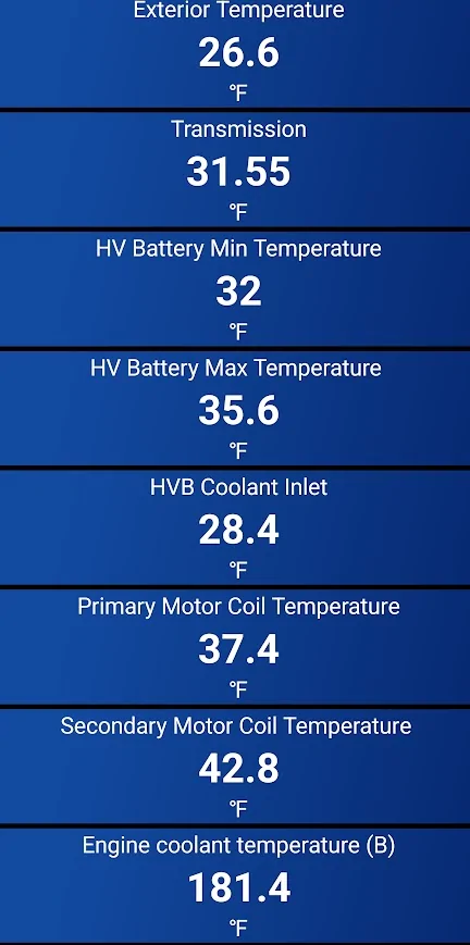

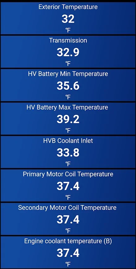

December 8th about 5PM when I parked the truck in the garage for the night these were the conditions, note that it had been sitting outside in the driveway for about 90 minutes since the last drive. Exterior temp is 26.6°, the HVB is still holding some of the mornings battery prep warming at 32-35.6°, the coolant temp is 181.4 from the move to the garage.
The departure times main switch was turned off in the Sync screen, and 'Home' charging parameters was changed from 90% to 50% SOC to prevent charging while plugged in, I wanted to eliminate any heat generated from either activity.

Dec 9th at 06:35 am, the temperature outside is 14° but the truck is reporting the garage temp is around 23° per car scanner data, as you see the temp's in various systems have chilled overnight, but the HVB is showing slightly warmer!!
Ford F-150 Lightning CHARGING IN THE WINTER 1765282718951-5r

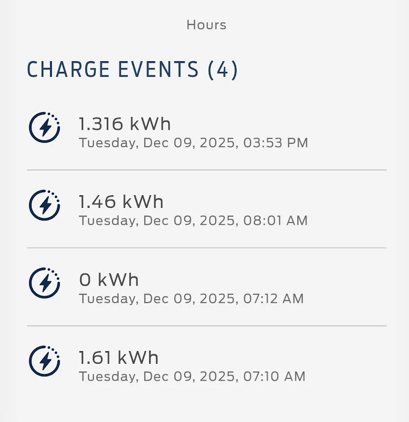

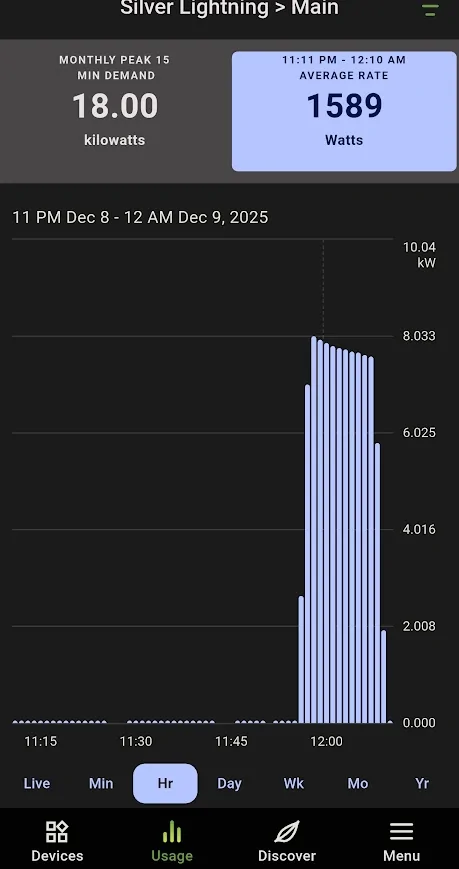

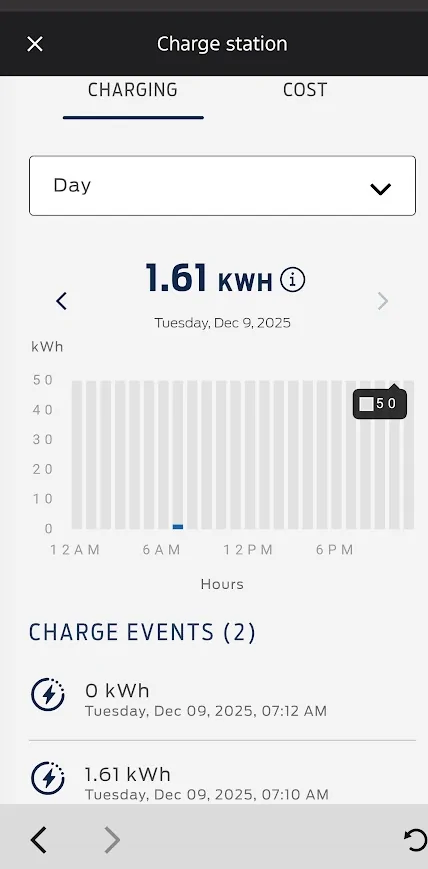

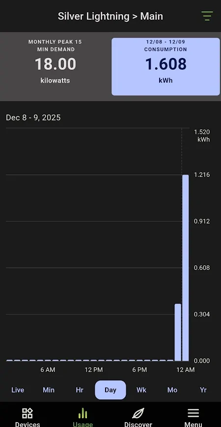

The Lightning decided it needed a little dose of energy to warm the battery at 11:56 PM the warming cycle ran until 00:09 AM, total run time ~13 minutes, using 1.61 kWh of energy, the PTC ramped up to around 8KW energy draw.
The FCSP measured 1.61 kWh of energy

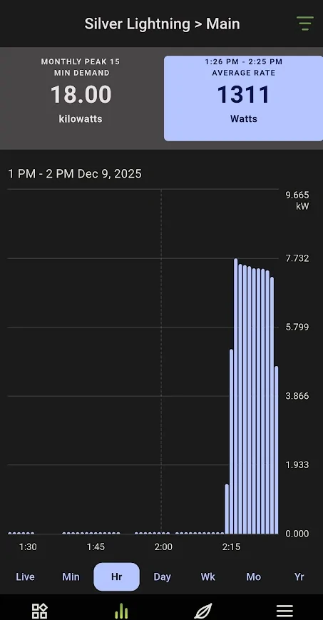

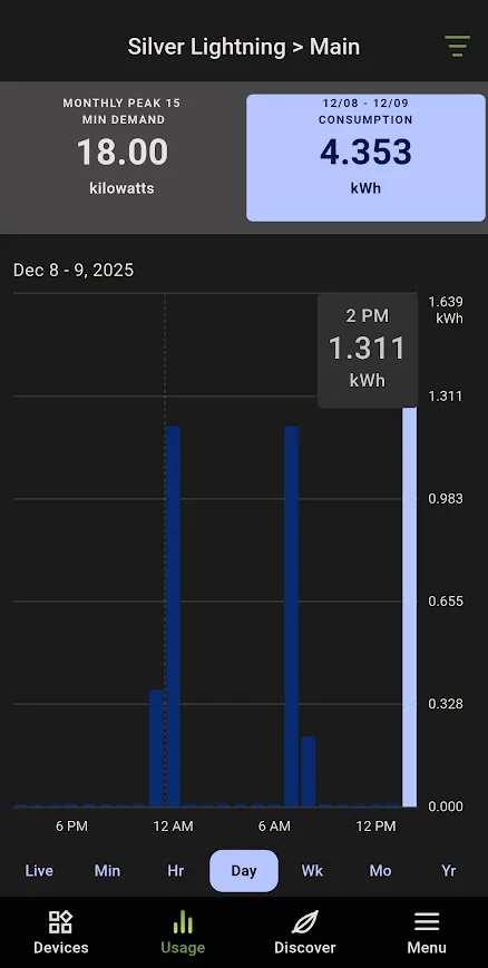

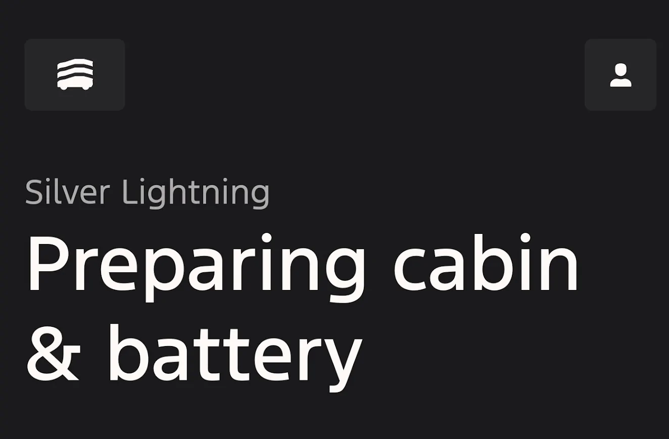

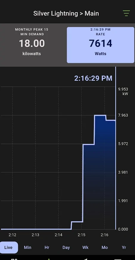

After today's activities & travels local short trips, I parked in the garage and plugged in to see if the spontaneous battery conditioning would repeat tonight, surprised to see that it kicked off immediately, during prior parking/shutdown's I got the popup reminder to keep the truck plugged in due to cold conditions.
As soon as I plugged in at 2:14 pm the energy flow started and the circulator was humming as usual during a warming cycle.
Ford app showed that the truck was preparing the cabin & battery.
Ford F-150 Lightning CHARGING IN THE WINTER 1765316356969-ph
Emporia confirmed energy flow, see the logs from 2:14 to 2:25
Ford F-150 Lightning CHARGING IN THE WINTER 1765316423188-rg

I configured a notification for my Emporia app on the phone to alert me if the truck starts drawing more than 3 KW of energy in the middle of the night, no need for a wide-eyed-watch.
FCSP energy log for the day & Emporia
