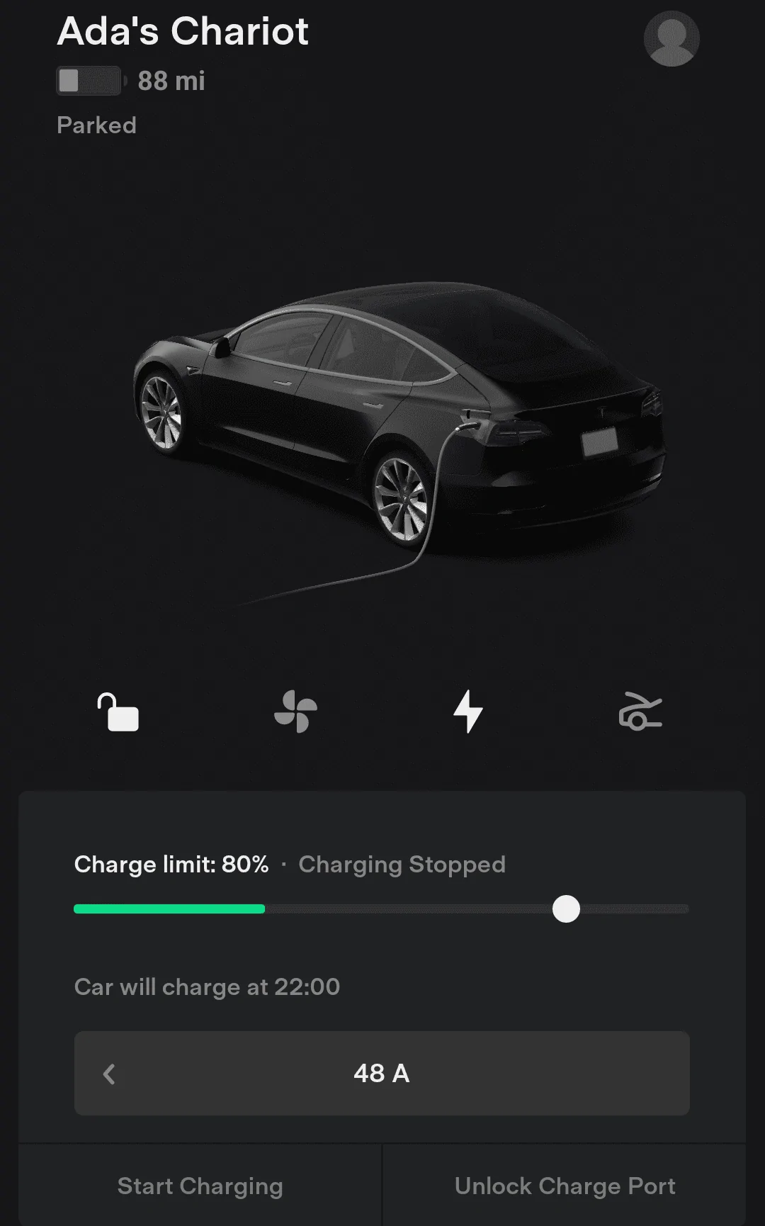

All you need is one of the recent couple of million that Tesla built. I can control the amperage from anywhere in the world right on my phone app.
Thats cool. Both the Kia's I have driven don't support it.
Yep exactly. Works like a champ on the Tesla. I am thinking a lot about the Tesla Powerwall in the basement; you can control when/how/if the EV chargers are engaged when running off-grid due to an outage. There is zero insight into the Siemens/Ford Charger Pro capabilities. Also, the tesla wall chargers can balance between two of them within the app, so it might be better to install another wall charger with a converter for the Ford.

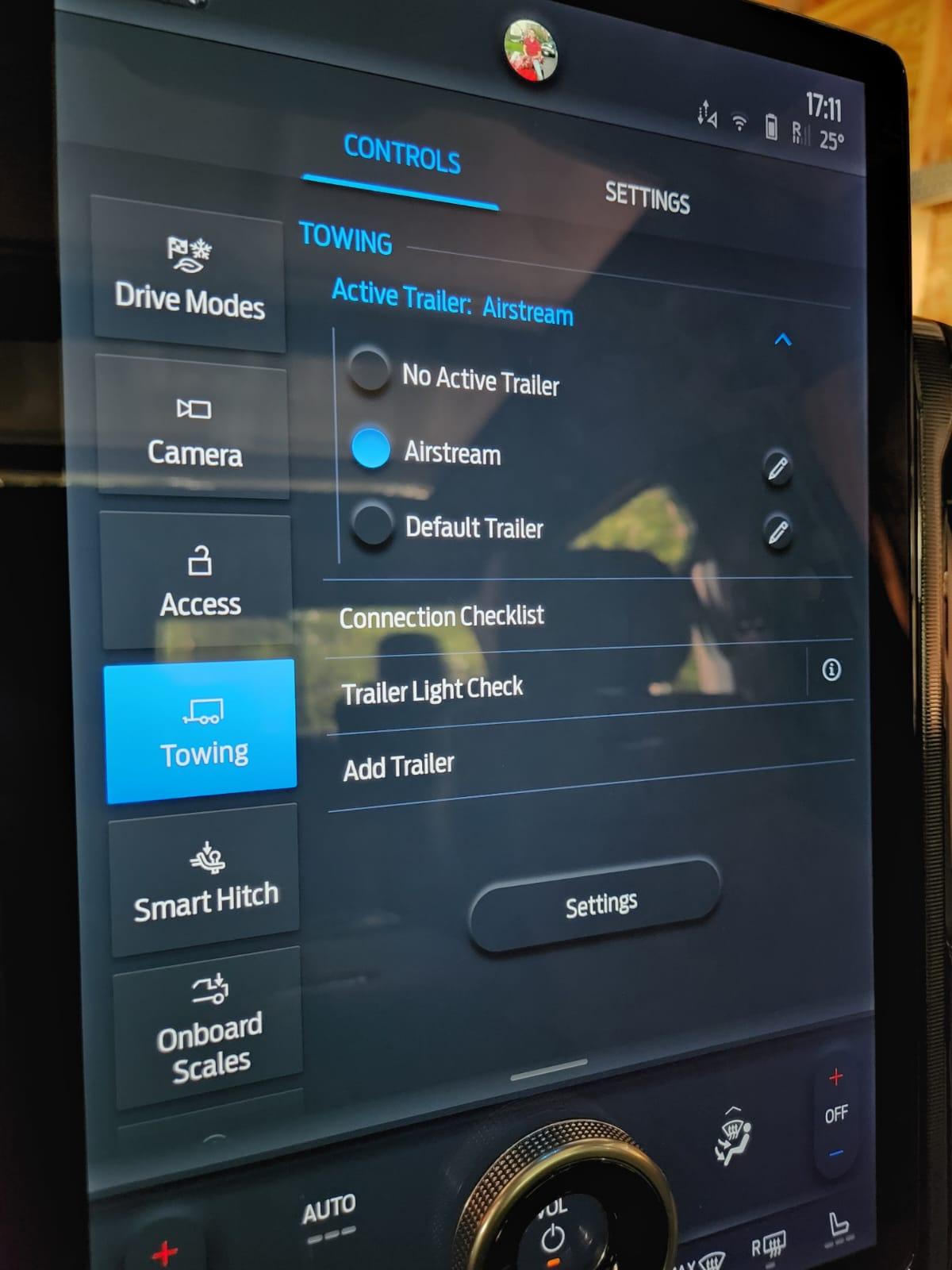

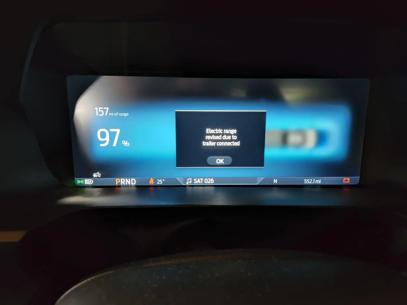

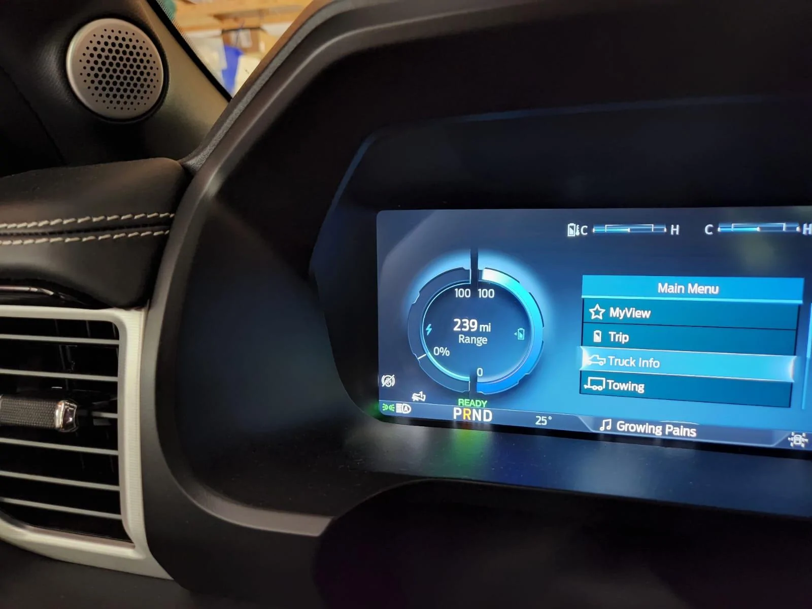

157 mile range at 100% and 5kWh/7miles..
There is a bug in the software where it will keep the trailer connected even if it detects at the trailer is not connected to the rear. I manually forced it and the new range appeared. Sorta like the BlueCruise stays enabled even if the trailer connector is plugged in.
