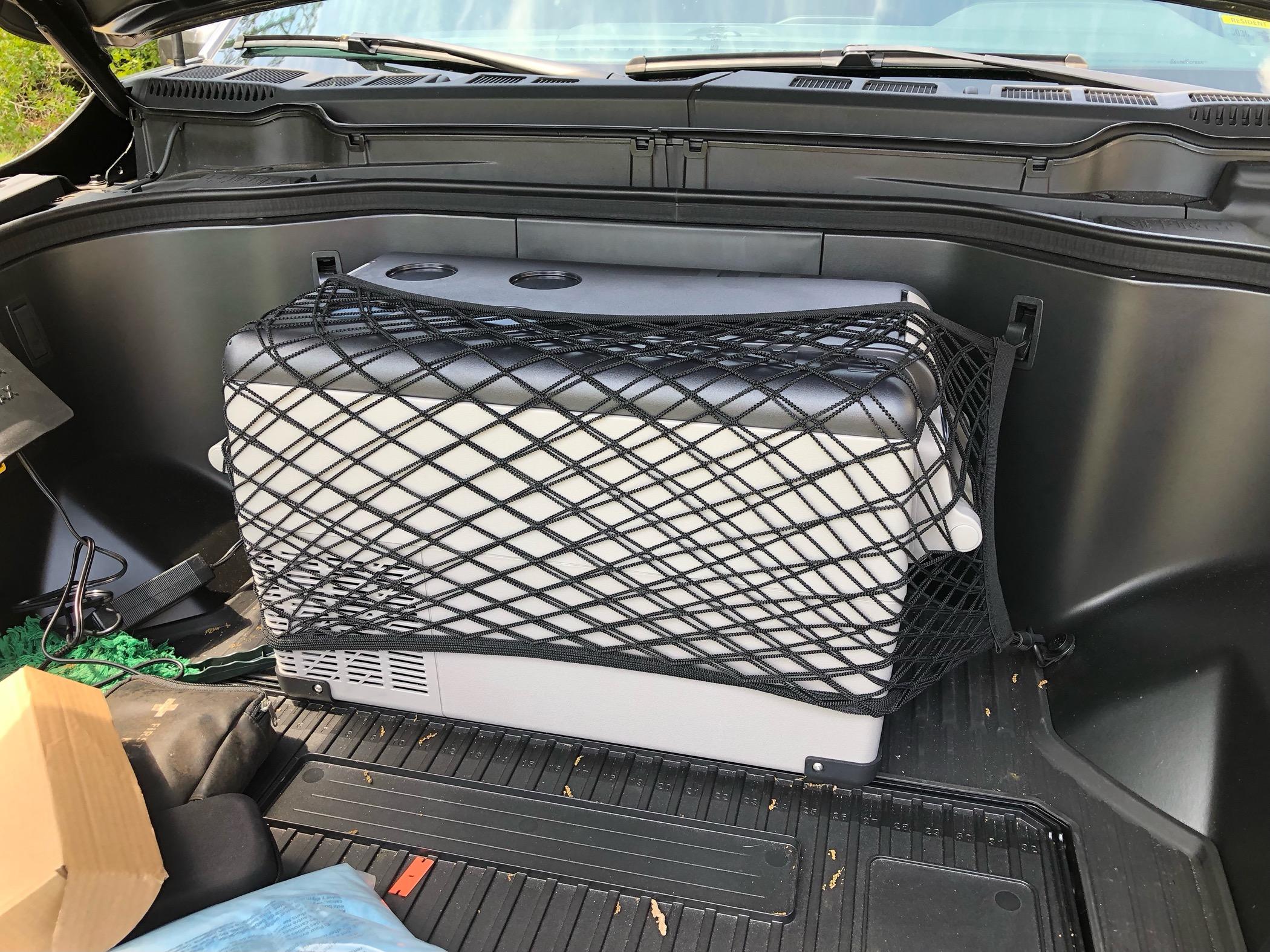

This is my set up. I only plug it in when I'm using it and it gets cool pretty quick. I've only had this since February so no hot temp challenges so far but it's been great for food shopping. It's not huge but does the job. The mesh thing prevents it from bouncing around while driving.
https://www.costco.com/.product.1666589.html?emid=transactional_ordershipped_product
Phantom 30-liter Portable Electric Cooler
Item 1666589
Model QN30
13FT 12V Female Cigarette Lighter Socket Battery Eyelet Ring Terminal 12volt Extension Cord Outlet Adapter Plug Power Supply Car Electrical Dc Cigarettes Charger Accessory Connector Kit 15Fuse(13FT)
https://www.amazon.com/gp/product/B07RMH3R8P/ref=ppx_yo_dt_b_search_asin_title?ie=UTF8&th=1
I have the same one and never thought to place it there behind the net. Love that placement and going to copy you. Thanks! ?

Does anyone have the part number for the frunk net? 2023s didn’t come with it.
Nice configuration. I may need one this size (I have a couple larger ones).

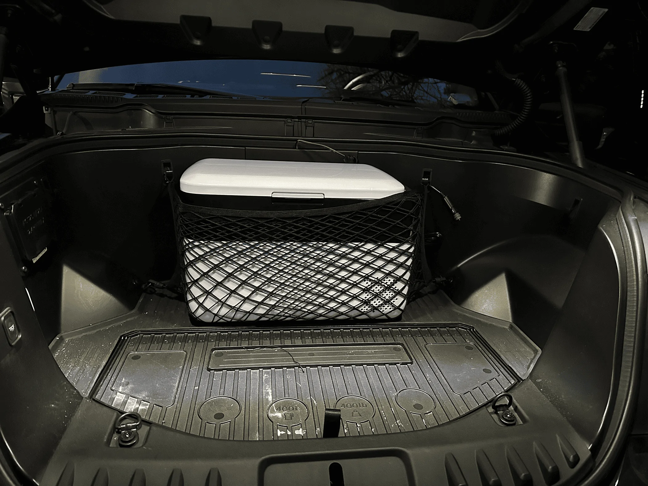

I haven’t received my smaller EUHOMY 35 Liter cooler yet to try it in the Frunk. The Amazon listing states 45 watts “average” what ever that means. I’ll report back once I get it and try it.
UPDATE. Received the powered cooler and it fits perfectly. It runs fine with frunk closed and doesn’t message that it exceeds wattage when frunk is closed.
im very happy with purchase. Cost $189 plus tax from Amazon. https://www.amazon.com/gp/product/B08N63CSH5/
Ford F-150 Lightning Chest fridge for frunk IMG_0069
