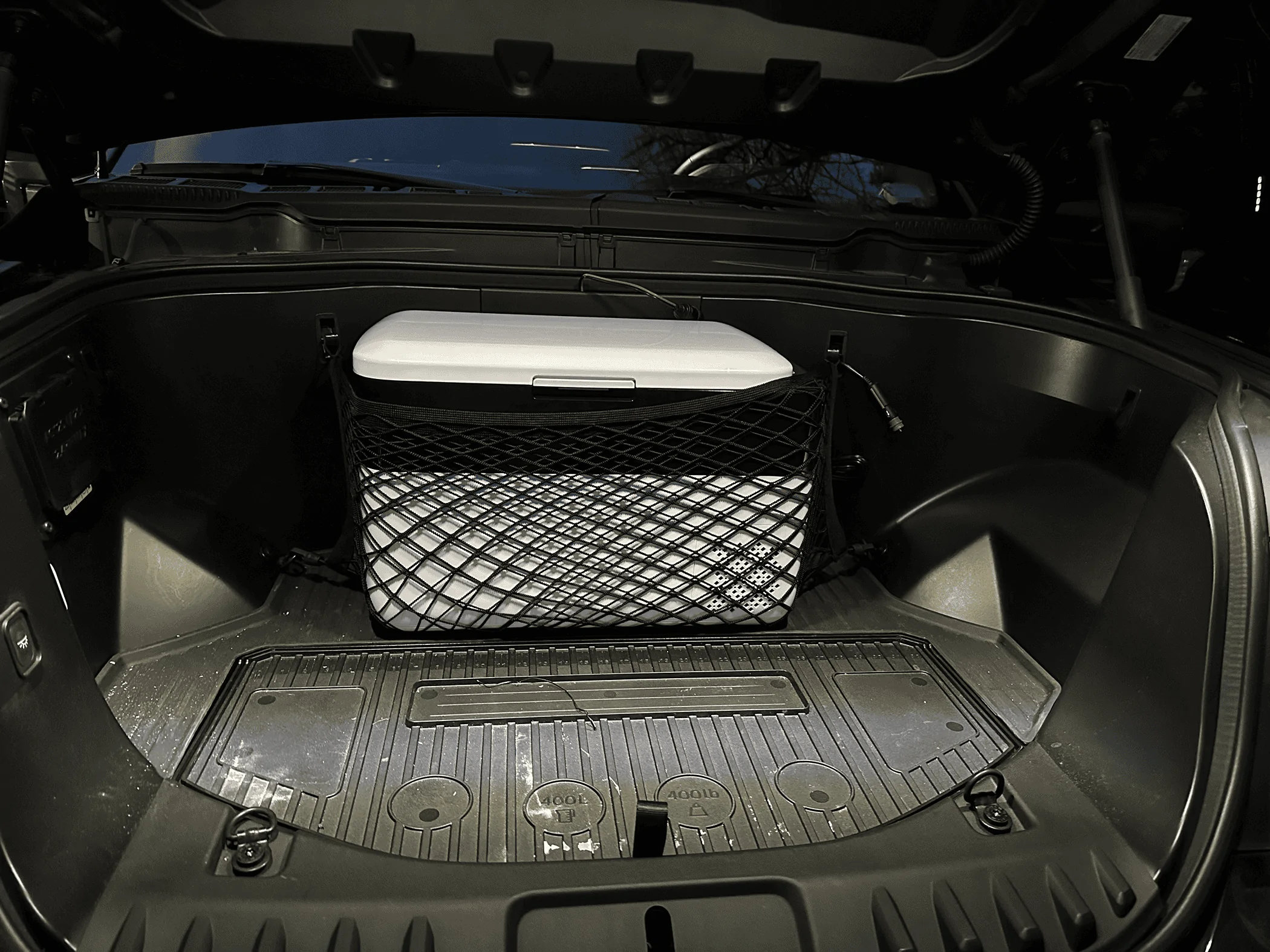

Baller
This is my set up. I only plug it in when I'm using it and it gets cool pretty quick. I've only had this since February so no hot temp challenges so far but it's been great for food shopping. It's not huge but does the job. The mesh thing prevents it from bouncing around while driving.
Ford F-150 Lightning Chest fridge for frunk tempImagelITk6W
https://www.costco.com/.product.1666589.html?emid=transactional_ordershipped_product
Phantom 30-liter Portable Electric Cooler
Item 1666589
Model QN30
13FT 12V Female Cigarette Lighter Socket Battery Eyelet Ring Terminal 12volt Extension Cord Outlet Adapter Plug Power Supply Car Electrical Dc Cigarettes Charger Accessory Connector Kit 15Fuse(13FT)
https://www.amazon.com/gp/product/B07RMH3R8P/ref=ppx_yo_dt_b_search_asin_title?ie=UTF8&th=1
