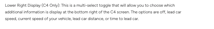

The Comma4 doesn't show your speed by default. There is a blue plot specific feature that placed information in the bottom right corner of the screen, and it is adjustable to what it shows. I suspect you have it set to show the speed of the vehicle in front of you.
Ford F-150 Lightning Comma AI self driver assistant 1773152406153-g
Thanks, I will change the offset to .05 and see but I know it's going to hug the center lane. The unit is centered but I will confirm this.
